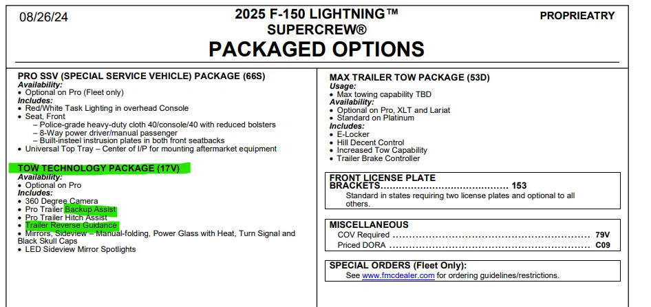

That smart hitch delete, is that talking about where you can steer a trailer easier with a knob on the dash and some decals you put on the trailer? If so, then that's another missprint because I have all that. I do not have the scales.
This is print is for Job 2 changes., is your 25 Flash from Job 1?
