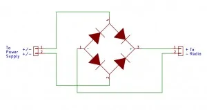

By the way, a fool proof (or sleepy person proof) protection circuit:
Bridge Rectifier – The most foolproof for reverse polarity protection. For about a dollar or two, the bridge will correct the polarity no matter how you connect the power supply. With a bridge there are always 2 diodes conducting (which can result in greater losses of than a single diode protection circuit, around .8-1.5V. )
Ford F-150 Lightning Trashed NOCO Genius2 By Reverse Polarity Hookup RPP-Bridge-Fixed-300x159
From: https://kc9on.com/ham-radio/station-accessories/reverse-polarity-protection/
For a car/truck battery these diodes might have to be hefty if using the charger with higher currents, but for trickle charging, not so much.
