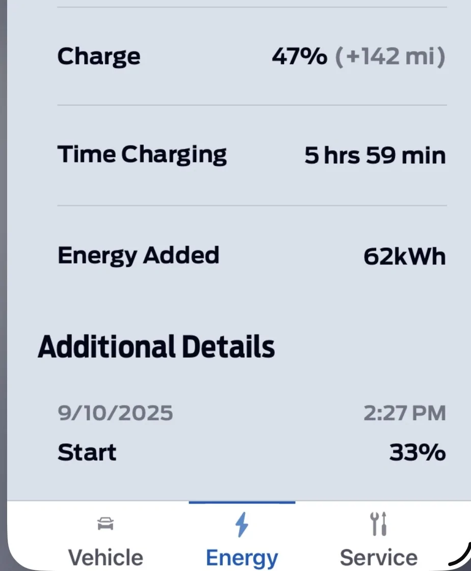

When I charge on my 60A/48A “charger” I only get 23 Miles added per hour charged. (142 miles/6 hrs)

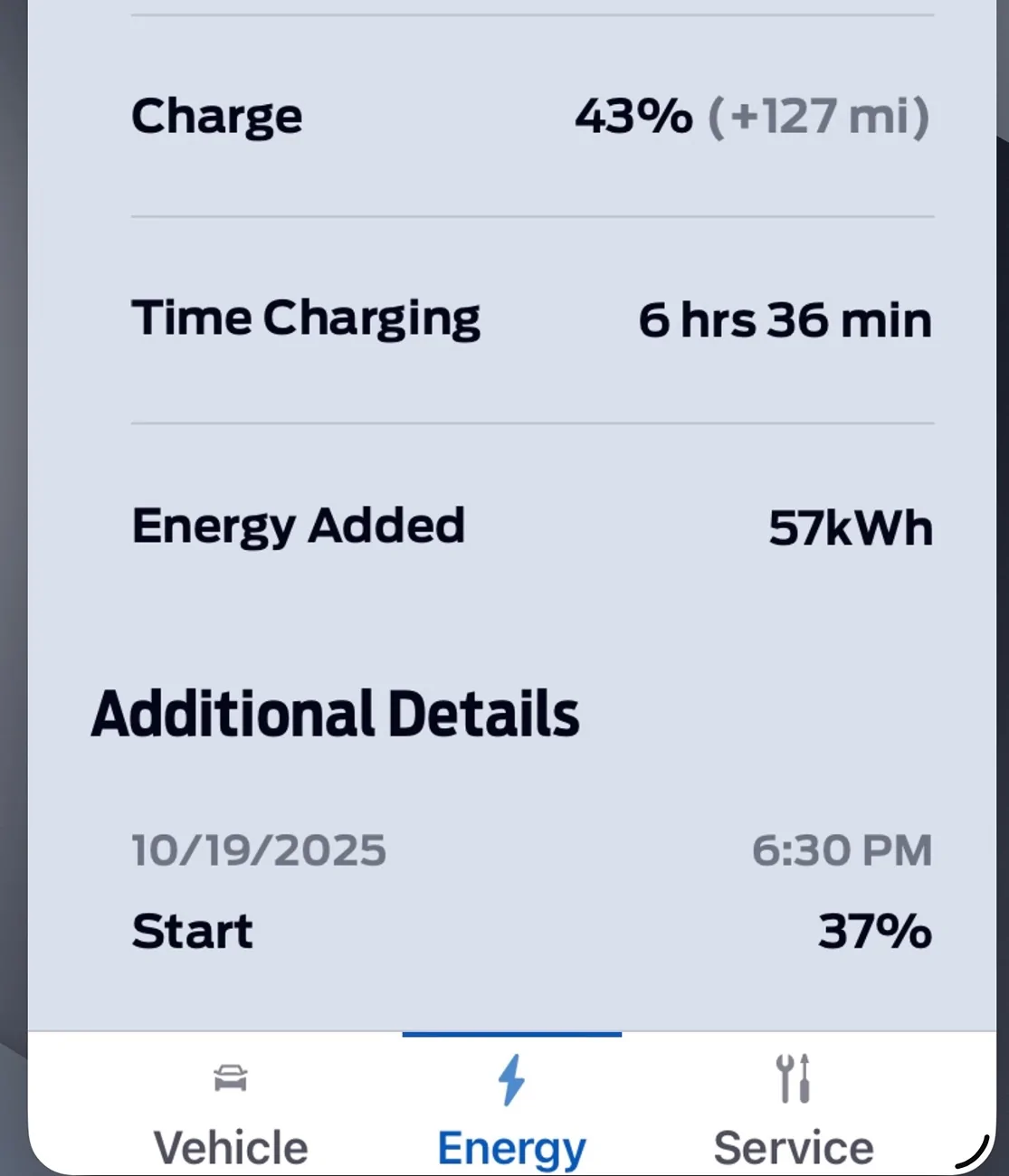

When I charge at my 50A/40A charger at my cabin i only get 19 miles for each hour on charger. ( 127 miles/. 6.6 hrs)

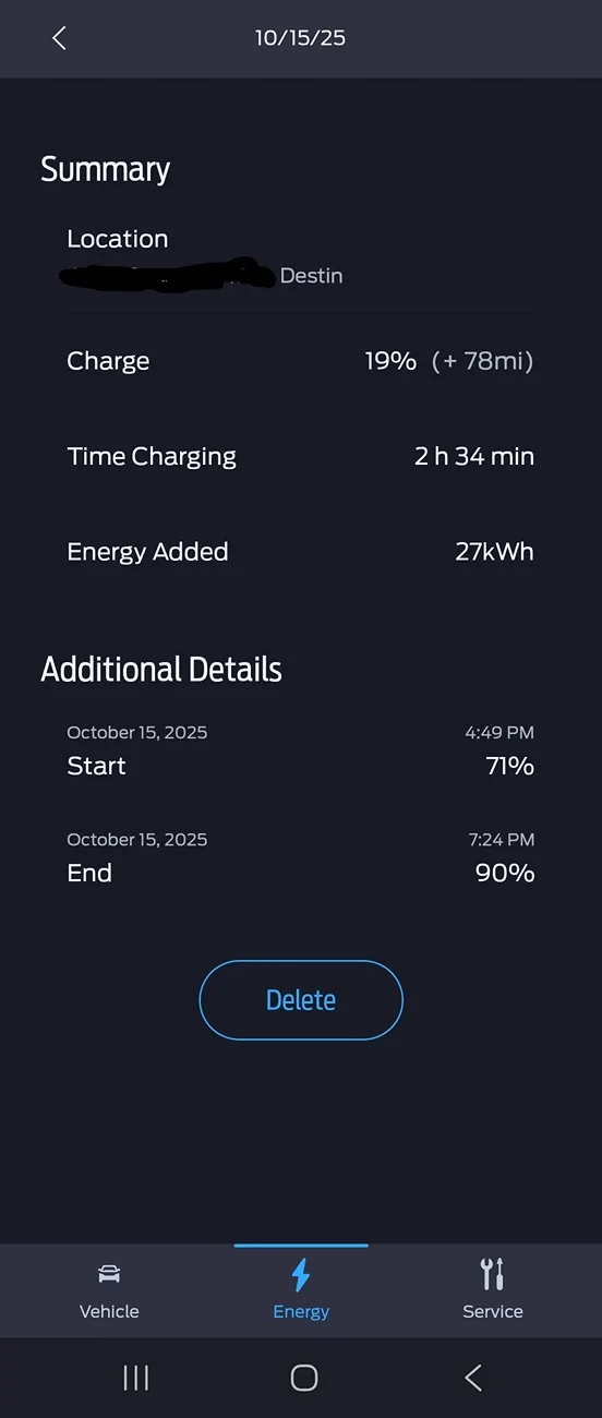

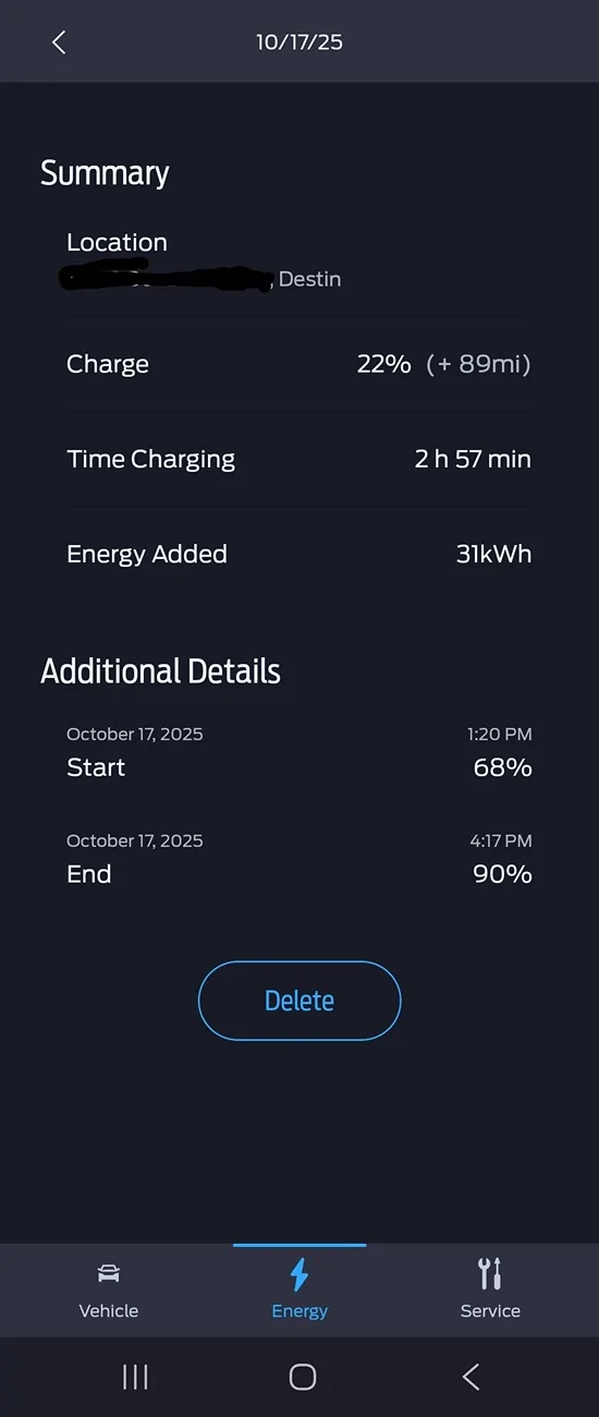

@flyct My only guess is I'm starting at a higher SOC so the GOM doesn't calculate the same.
Ford F-150 Lightning Traveling to Birmingham AL from Destin FL Screenshot_20251020_113247_FordPass
Ford F-150 Lightning Traveling to Birmingham AL from Destin FL Screenshot_20251020_113423_FordPass
With these numbers your GOM estimates your full battery range at over 400 miles. Hard to believe.
22% added 89 miles
19% added 78 miles
(100/22 )*89=404 miles
(100/19)*78=410 miles
