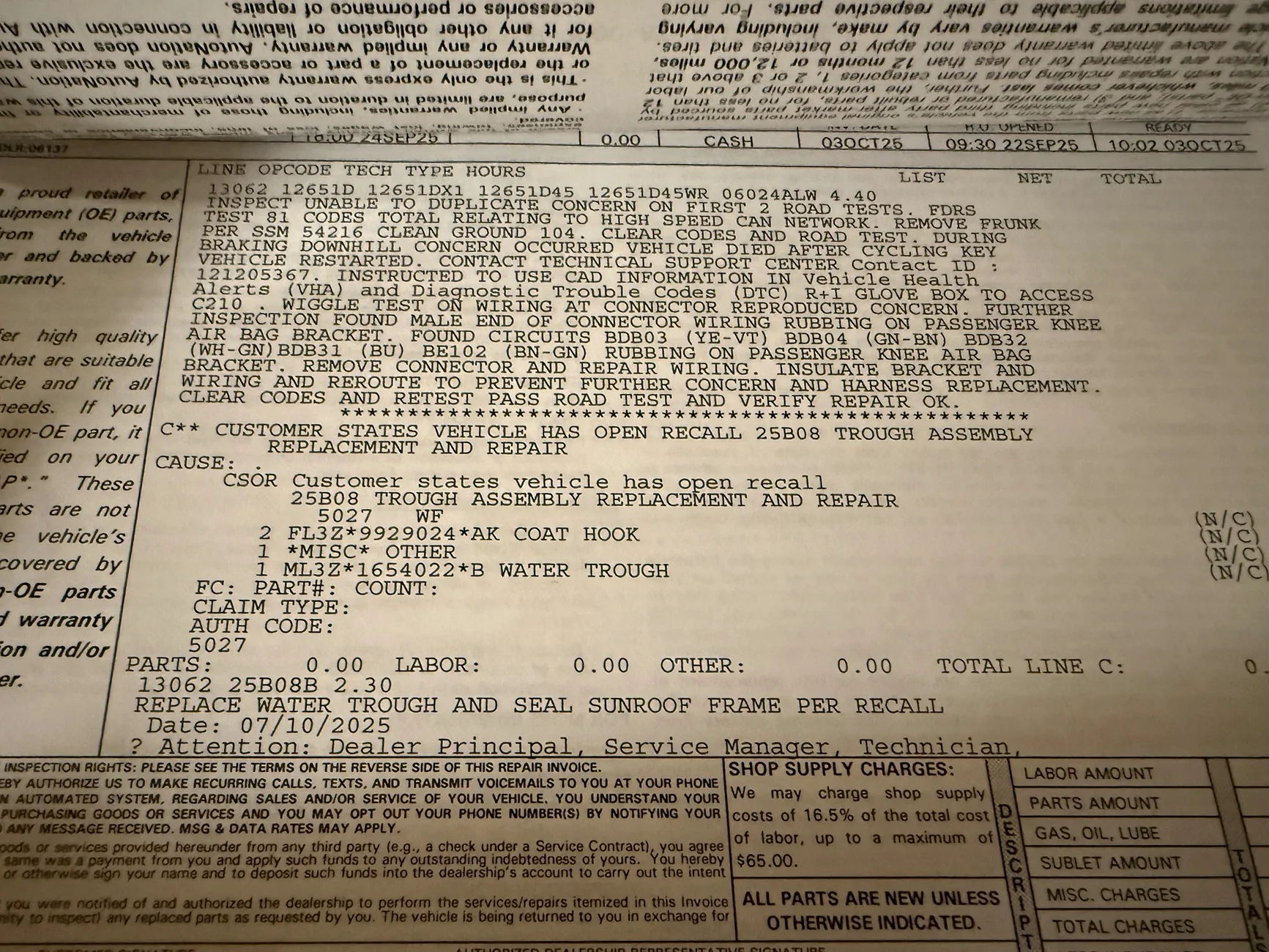

My Ford dealer just sent a mobile service to check it. The tech said that there is a problem with high speed CAN modules that are not communicating and it might be a wiring issue. I need to tow the truck to them

I just got an update this morning. My truck is fixed!!! They said there was wires shorting out near the airbag causing all of this. I’m a good pick it up this afternoon! Hope all goes well!
Happy to hear your truck is fixed. If possible, can you post a picture of your paperwork from the dealership with repair description? It might help others in the future who face a similar issue. Also, it might be a stop to preemptively diagnose a tight wire, etc.
Yes. Will do.
Wow, good thing it did not cause the airbag to deploy!!!
I just posted it
