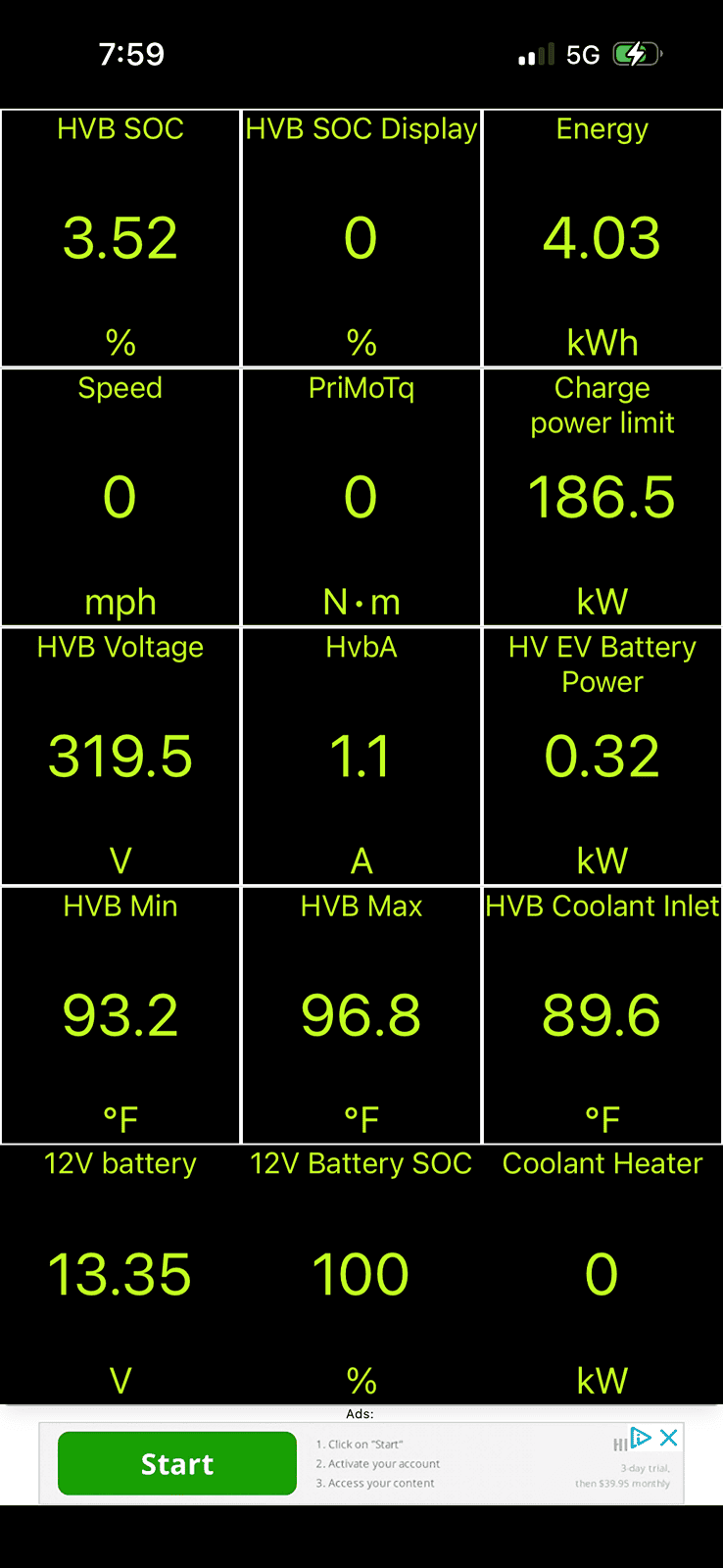

Charging for 5 hours so far and still 0%. I recalled that I have an OBDII scanner. Anyone want to tell me what this means? The voltage should be close to 400, correct?
