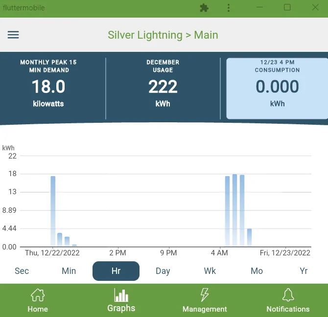

I've seen the warning on several occasions the past few weeks as temp's dip below freezing.
I've been plugging in each night at the end of the drive day, but not after morning or afternoon runs on errands and short trips.
I've been using a Emporia Vue2 power monitor of current to the FCSP, other than minor sampling noise, there is no appreciable current flowing. This might change as winter deepens, with prolonged periods of severe cold, maybe I'll see moderate current flow.
My charging strategy now is to replenish an hour+ prior to anticipated departure, heat generated during charging and any incidental condition for sub zero charging will happen just prior to drive time.
The past two days have been mild [40's to 50's], no real need to have spontaneous battery conditioning, I look forward to how it performs Saturday and Sunday when temps drop into the teens

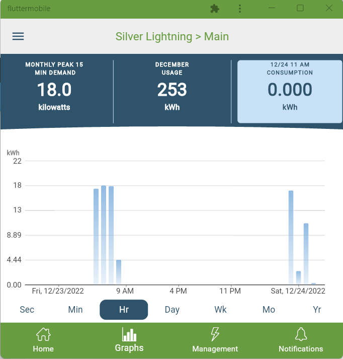

Overnight temps down to 8°, garage might have been around 20, still no substantial energy draw through the middle of the night, my 7am charge kicked off ontime, but by the time we were ready to go it still needed more time to get to my temporary 95% requirement, I wanted it higher due to extreme weather situation and the potential emergency needs.
Storms passed by last evening we're in the clear, but just in case I resumed charging to get to 95%.

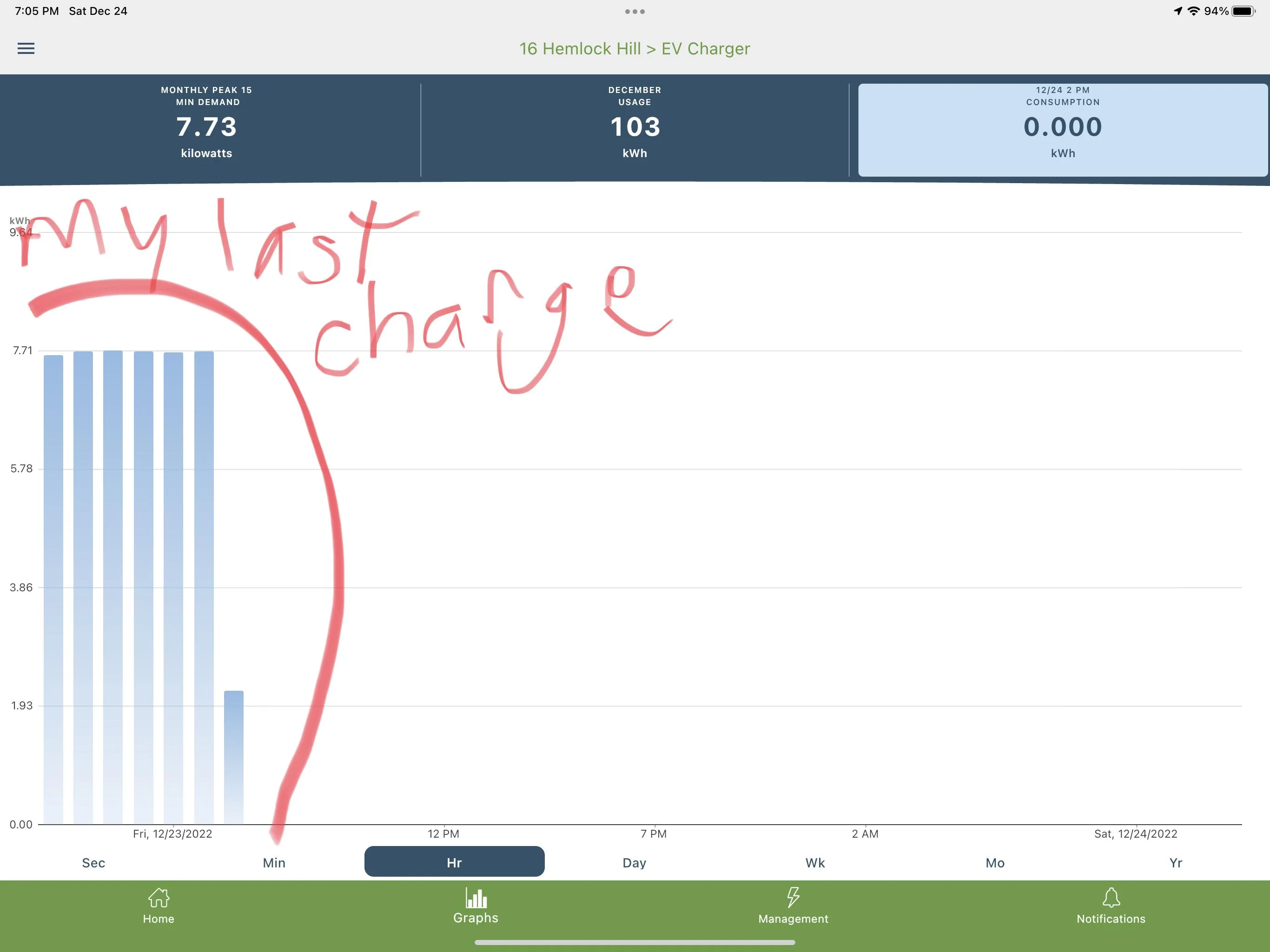

It was 0F last night. My truck is in an unheated garage and plugged in. my estimated range dropped overnight by 15 miles, state of charge remained at 95%. The truck never pulled any power last night or all day today.
