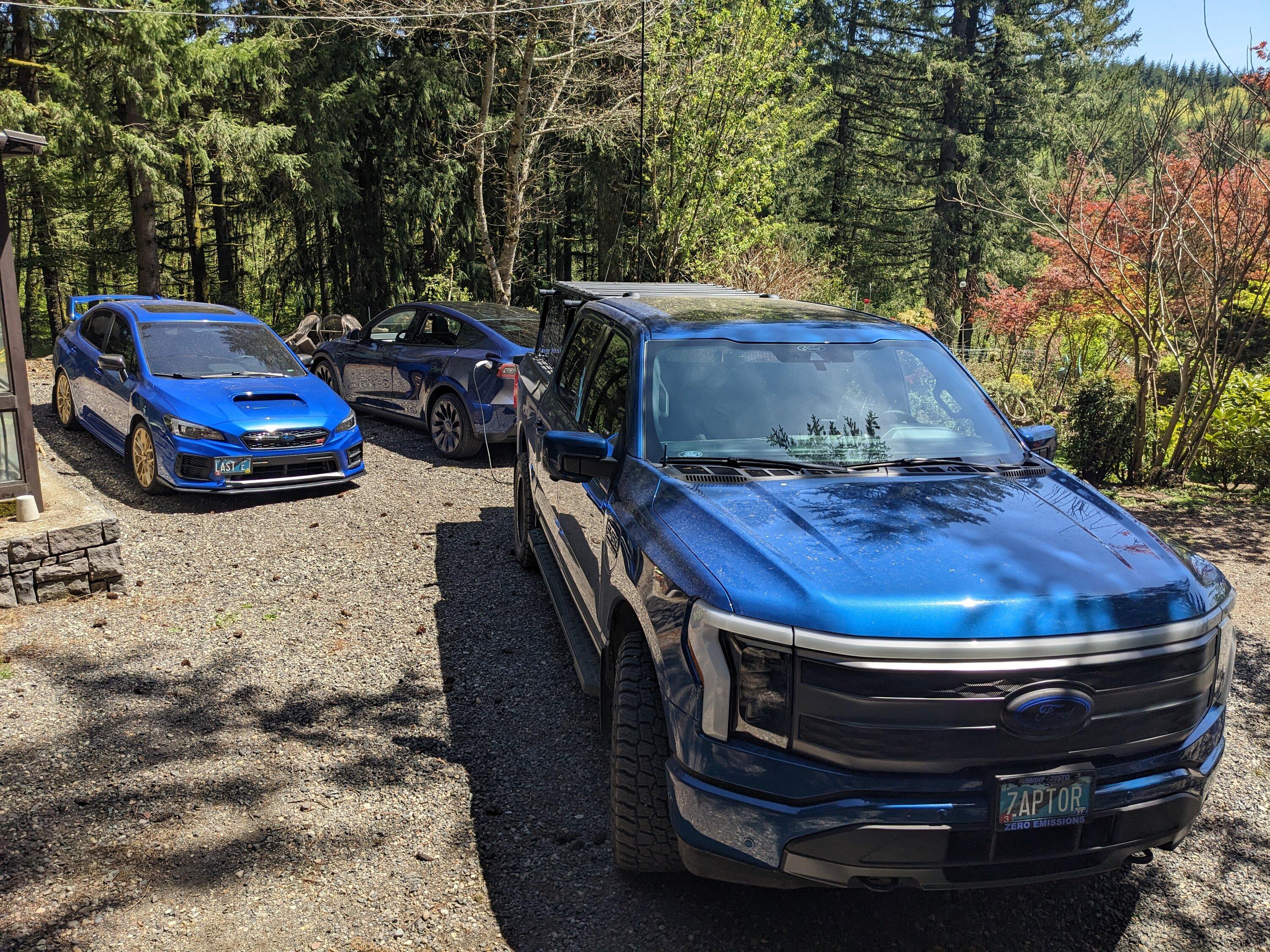

Ford F-150 Lightning Turns out you really can charge a Tesla from a Lightning ⚡ PXL_20230512_203428388
New Tesla Y Performance came half-charged; no Tesla charger at home, so I took it from 43% to 90% in maybe 6 hrs running off the 240v ProPower in the bed ... not a permanent solution, but way faster than 120v home charging. I will repeat the test again with better time and power notes, but it 100% works with just the Ford mobile power cord and two adapters (NEMA and Ford->Tesla).

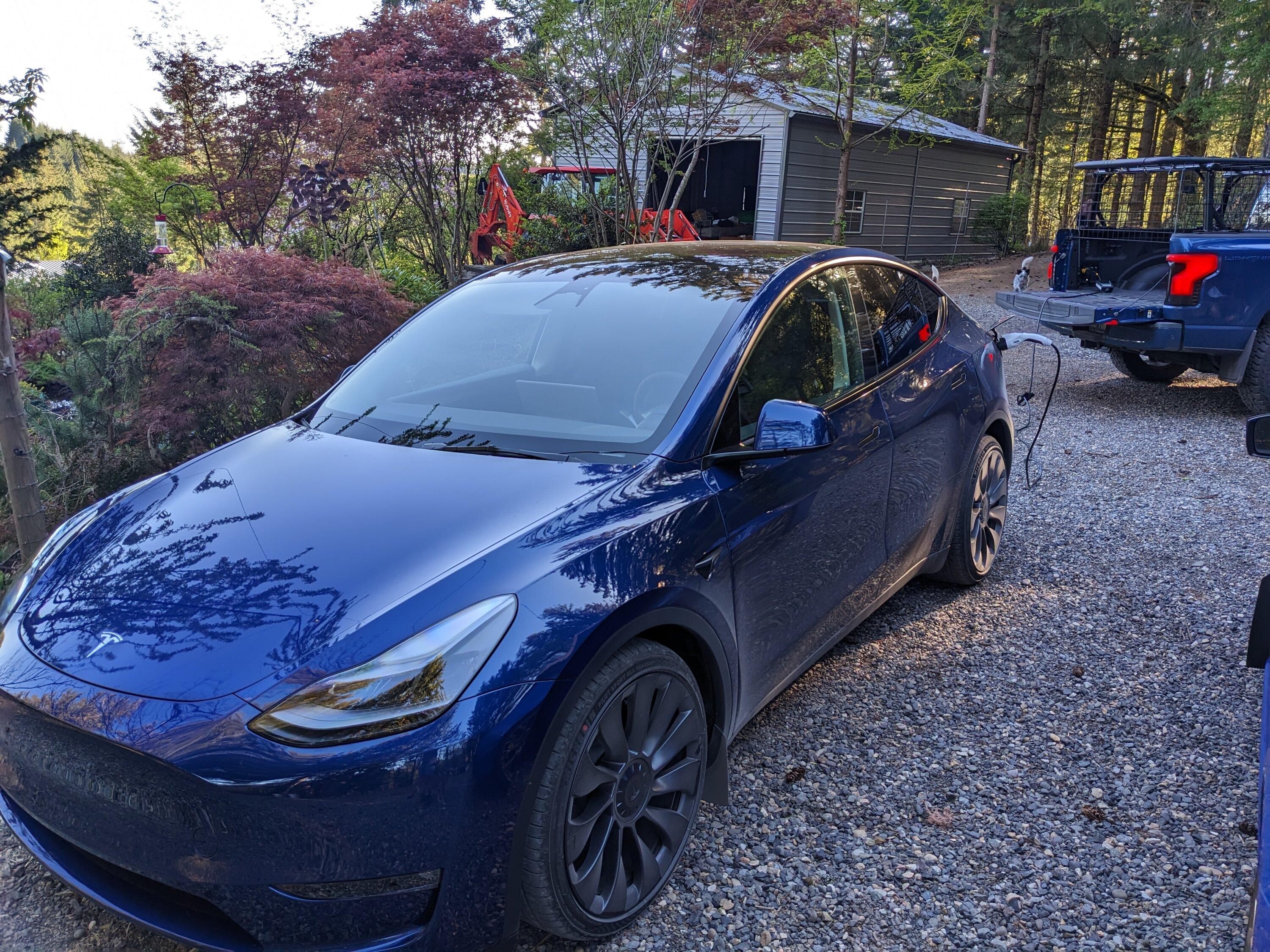

Ford F-150 Lightning Turns out you really can charge a Tesla from a Lightning ⚡ PXL_20230513_011705254
Opposite view...

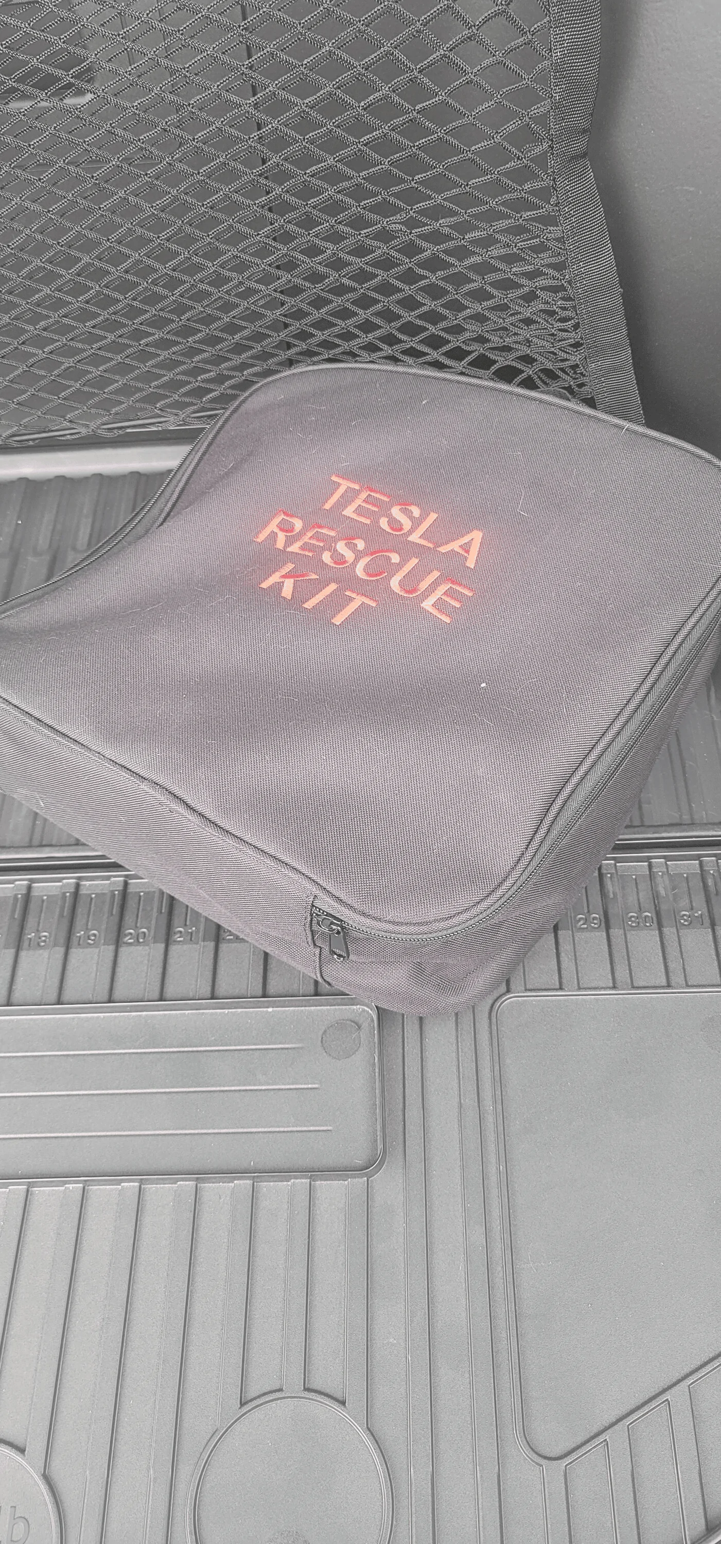

Ford F-150 Lightning Turns out you really can charge a Tesla from a Lightning ⚡ 1684203548917
I keep this in my frunk. Everything I need to charge a Tesla, but mainly used to troll my Tesla friends.
