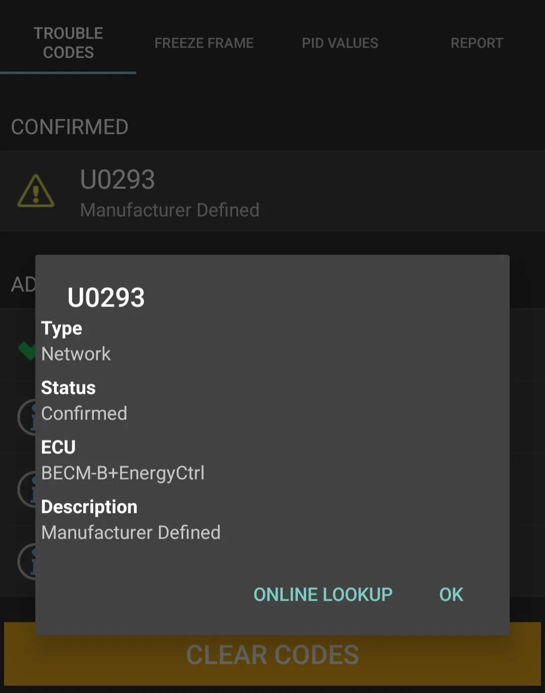

6. I got in the truck to pull DTCs from the truck, and see if anything useful got logged, and yep, I got this:
A quick search leads me to:
https://www.dtcsearch.com/U0293/
And
https://www.obd-codes.com/u0293
Both of which sound like I'm making a trip to the dealer. Again. Yay.
Anyone else had similar? I search the forum for that particular DTC before posting, and came up empty.
