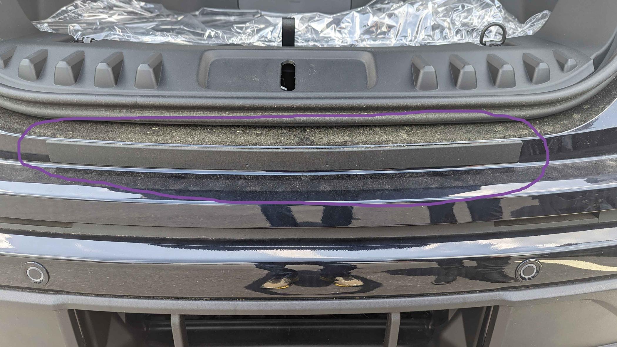

The front bumper (actually, the front 1/3 of my truck) was replaced due to an accident. :angel: My body shop has spent weeks trying to locate a small trim piece that attaches to the front bumper, but nobody can identify it. I even went to the local dealership to show the parts manager what part is missing (looking at a Lightning on their lot - see picture), but they could not identify the part in the Ford parts diagram. The part is roughly 1 1/2 inches by 30 inches, about an eighth inch thick. It attaches to the bumper via five tabs on the back. We've come to the conclusion that the standard Lightning parts diagram is missing the listing for this part.

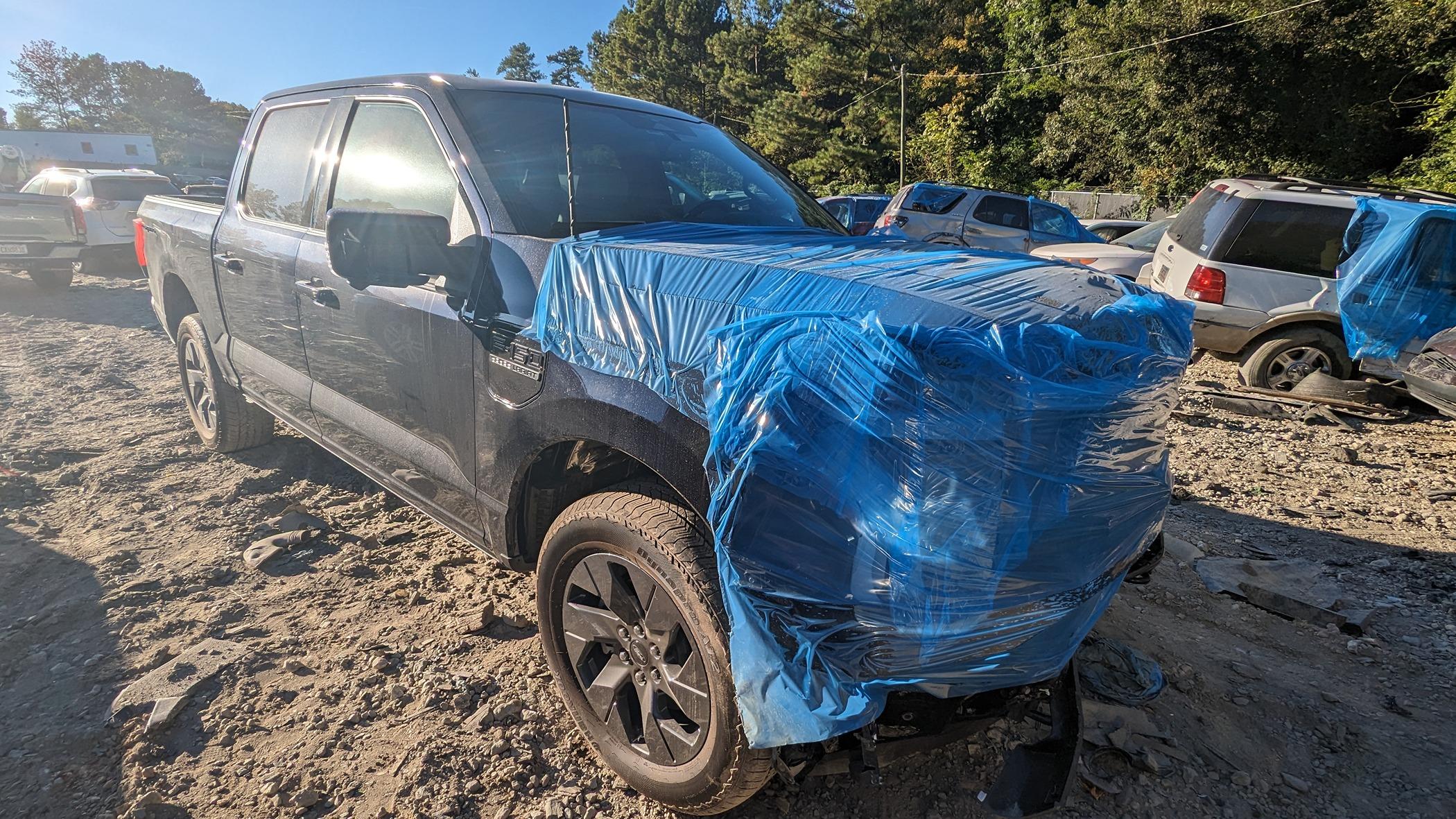

See the picture below, but you can't see much since the front was wrapped up to keep all the pieces from falling off.

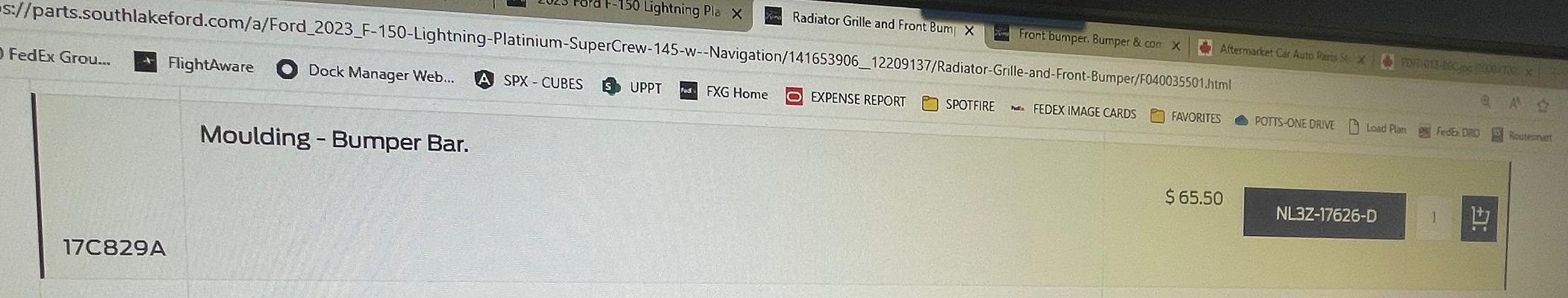

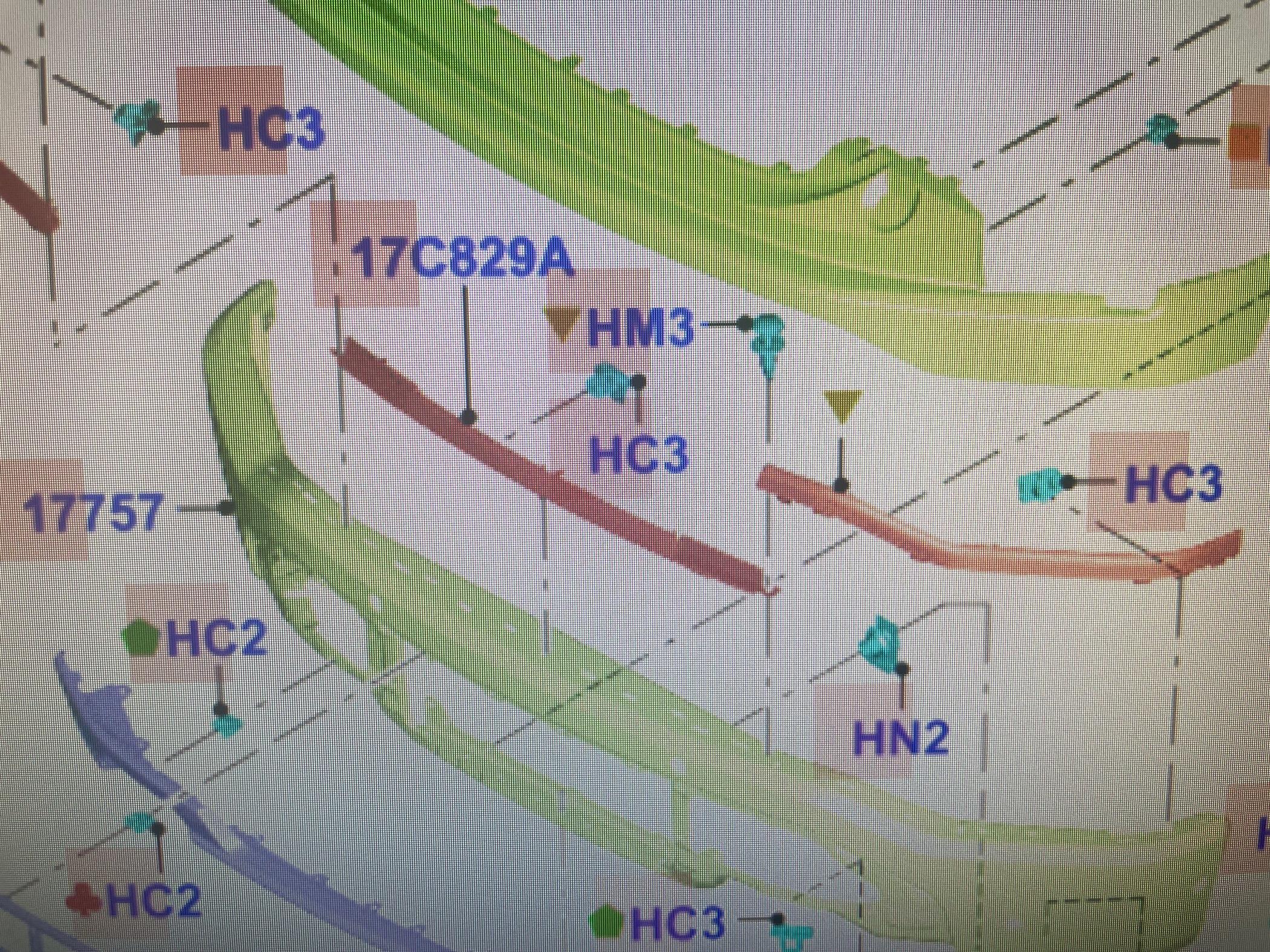

I've seen this diagram and looked at it with the parts manager at the local Ford dealer. The missing piece is not shown on this diagram. It is a long, flat, thin piece that does not look like anything here. We concluded that Ford omitted this part from this diagram.
The body shop ordered the part you referenced and it was not the correct part.
Open your frunk and you will see the part I need just peeking out from the bottom lip of the hood.

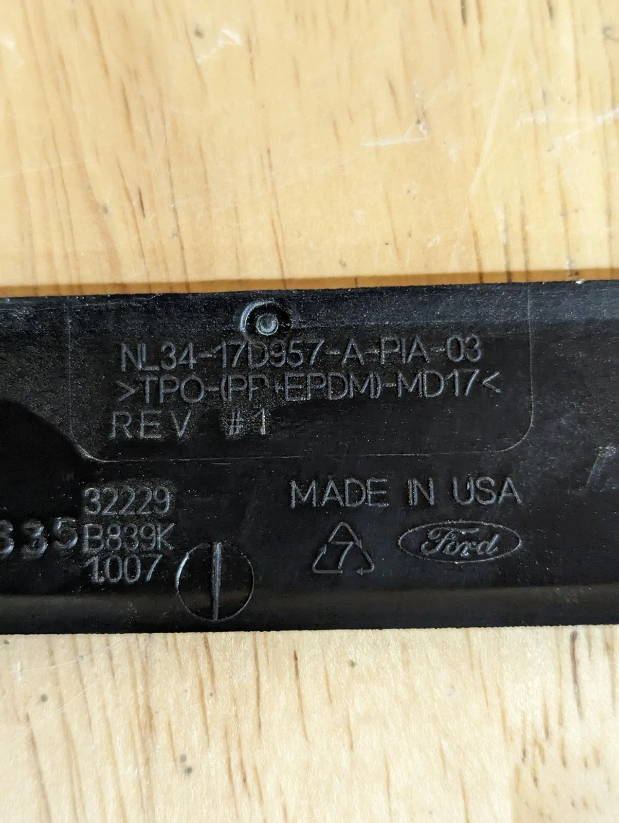

The part number on the small trim piece (partially) matches the entire front bumper cover.
NL3Z-17D957.
https://parts.nplincoln.com/p/Ford_...er-Cover-Upper/120919803/NL3Z17D957ABPTM.html
@SpaceEVDriver I assume that you removed the trim piece from your bumper to take this picture. If so, MUCH THANKS! I'm now wondering if this trim piece is considered part of the bumper cover assembly. This makes me wonder why it is missing from the replacement bumper cover.
If still possible, could you take a picture of the entire trim piece, both front and back?
