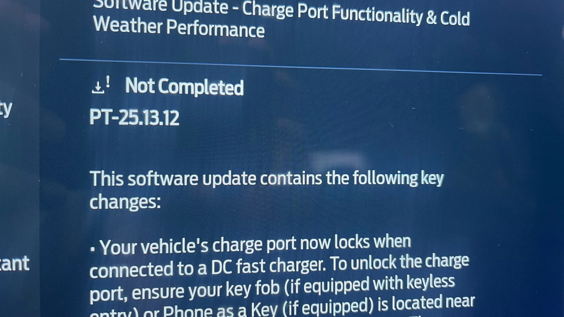

Hi all,
I’ve had this message for 2 months now and the “not completed” doesn’t go away.
At first, the truck tried several times (maybe 5 to 10) and it said it failed. But then started showing this and it has been like that since then.
I took it to the dealership for regular maintenance and they did some software updates but told me they could not get this one done there. After that, a few days later two updates showed up and went through with no issues but this one came back once those updates completed.
Beginning of this week, I unplugged the 12v battery for 30 minutes and still showing the same.
Has anyone else experienced this? Any solutions?
TIA!

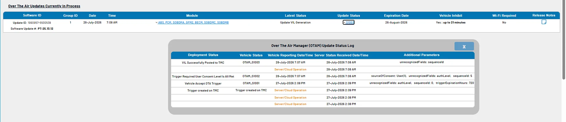

@andres1227 In your case, the battery is not the problem. The OTA has been in your queue for a month now and it seems like your truck has not pinged the server back to accept the OTA trigger. It has not downloaded the files or attempted to install even once. OTA's that require the vehicle to go into inhibit mode like this one have a window of 30 days to install before the OTA trigger times out and expires. Chance are, the OTA will fail in the next day or two seeing it was sent on 7/28. There is nothing you are doing wrong and nothing you can do (AFAIK) to get it to go through. You can try the 20 minutes battery pull, but do not do a master reset. A master reset will 100% cause the OTA to fail right away.
Oh wow!! Thank you! This is valuable information.
I will try another battery pull and see if this time it does it.
