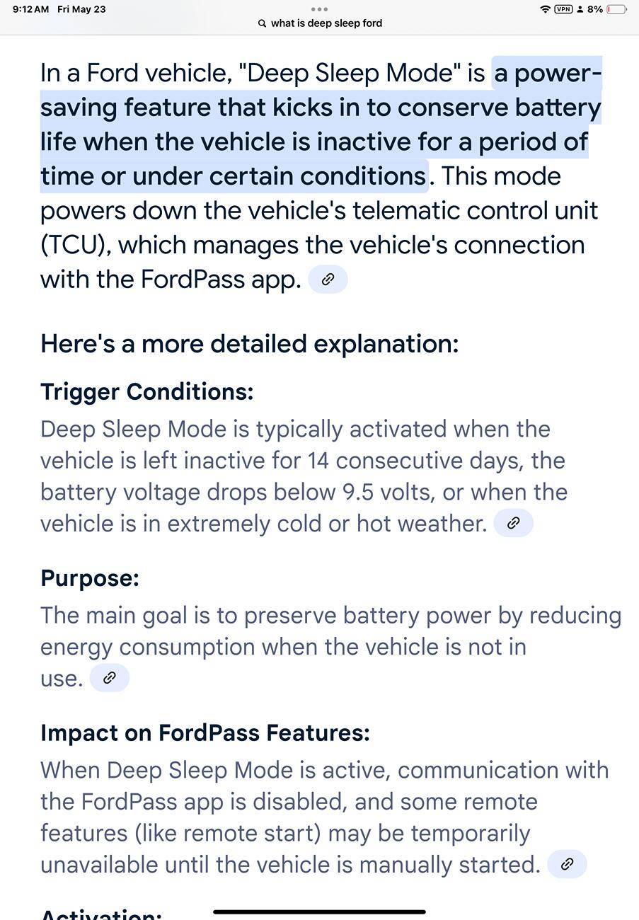

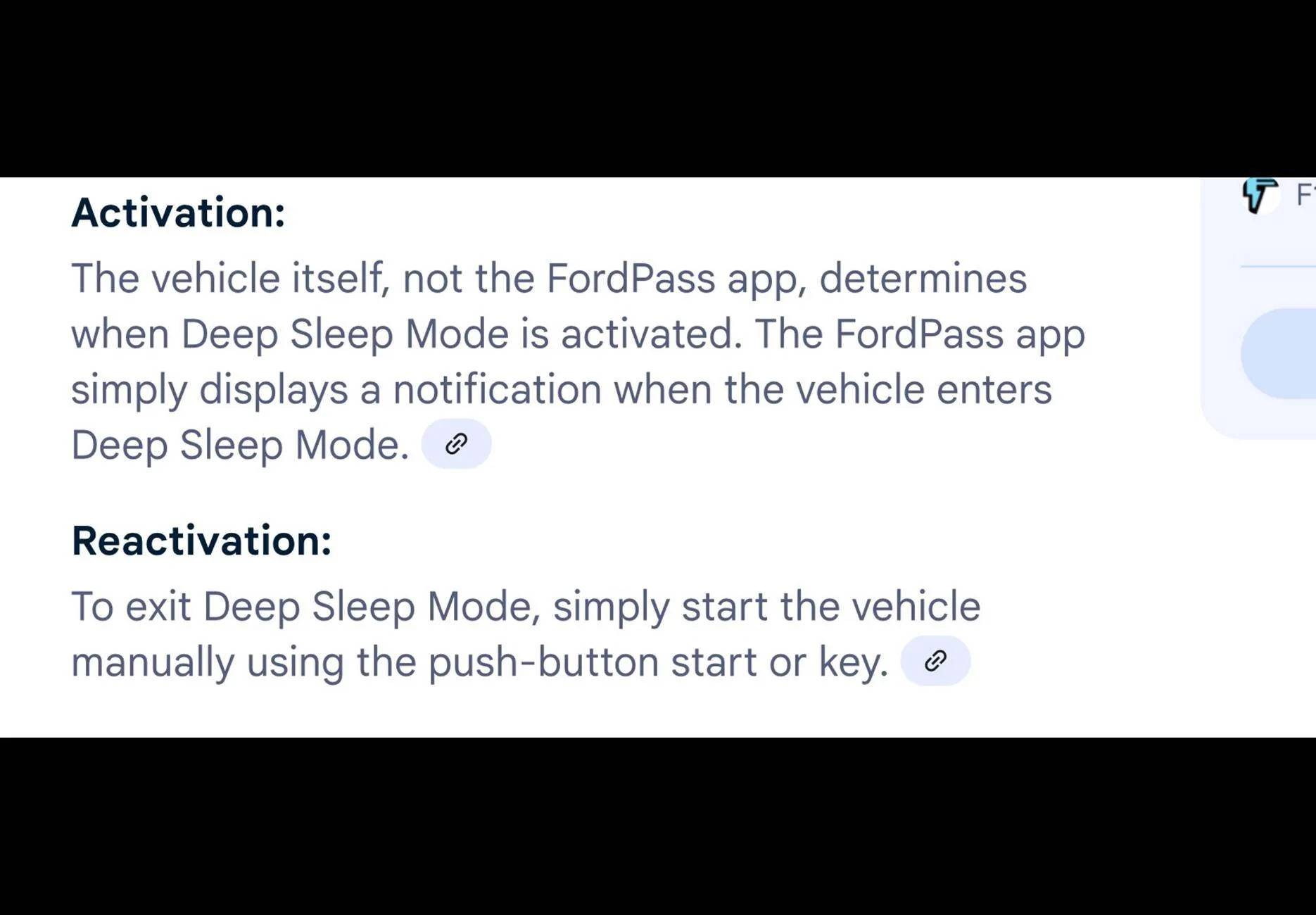

But the truck wouldn't respond if it's in deep sleep....right? I can't do anything through the app at this point.
Correct, you must manually start the truck to take it out of deep sleep after

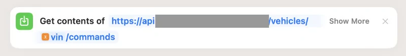

Correct. But I was curious if it was possible to bypass the app entirely. My shortcuts interact directly with Ford's servers via APIs, not the app. A long shot for sure, but it may work.
The TCU {on the truck} is shut down .... radio silence.... ain't nothing talking to it at this point.

I don't see how I can use it at all while in deep sleep mode....currently, the app does nothing. Deep sleep shuts down all communication.....in spite of batteries being fully charged.....dumb!

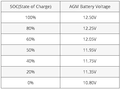

Quick reference: This is for an AGM battery at rest (no current draw, OCV - Open Circuit Voltage) and an hour or more after a charge cycle.
Ford F-150 Lightning "Vehicle in Battery Saver Mode" Please drive 1760116989553-hk

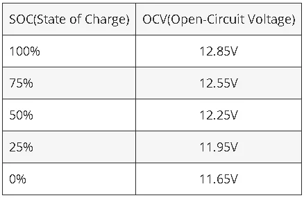

Our trucks rarely have zero draw unless the battery is disconnected, especially if you measure after opening the frunk without waiting for 30 minutes or so.
This chart is probably more realistic, assuming a 0.1C draw (0.35 amps on our tiny 35AH battery)
Ford F-150 Lightning "Vehicle in Battery Saver Mode" Please drive 1760117272185-mu
If you unlock the truck, open the frunk and measure, the draw might be closer to 0.5-1C (1.75-3.5 amps) so the voltage would read even lower for the given SOC in that scenario.
Point: 12.1 volts is probably ok if you just unlocked, opened the frunk and measured when the modules are lit up. Probably about 75%-80% SOC.

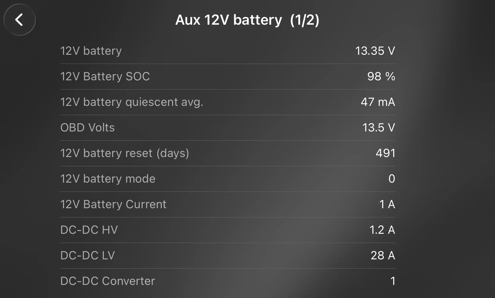

I got the “Battery Saver Mode” alert in my app this morning, but I drove my truck yesterday - the HVB is at 52% and the LVB was showing at 98% according to my OBD2 scanner…
Ford F-150 Lightning "Vehicle in Battery Saver Mode" Please drive IMG_5231
So not sure why I got that message?
