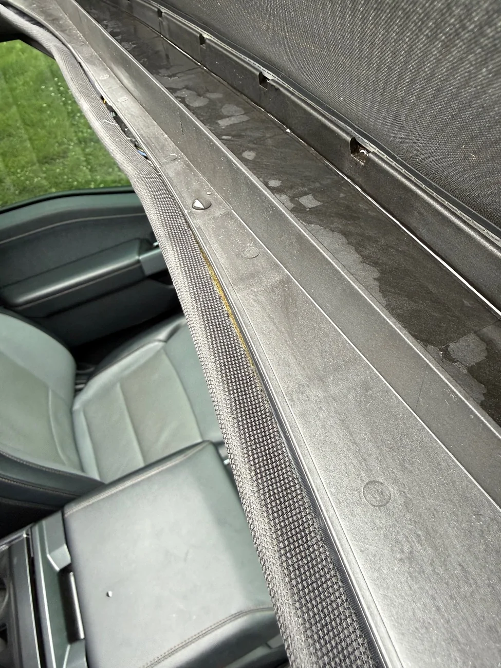

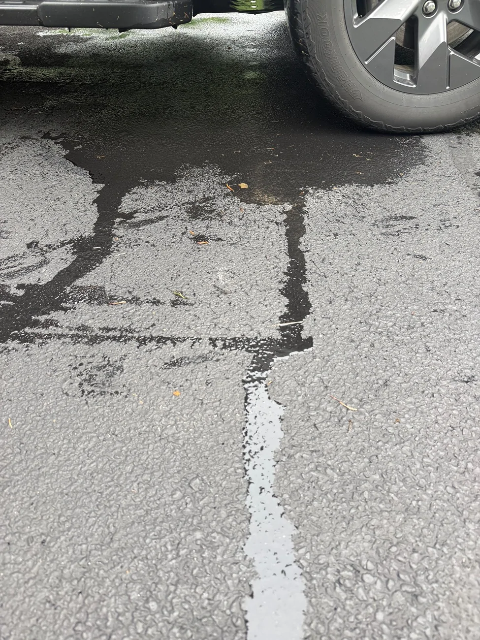

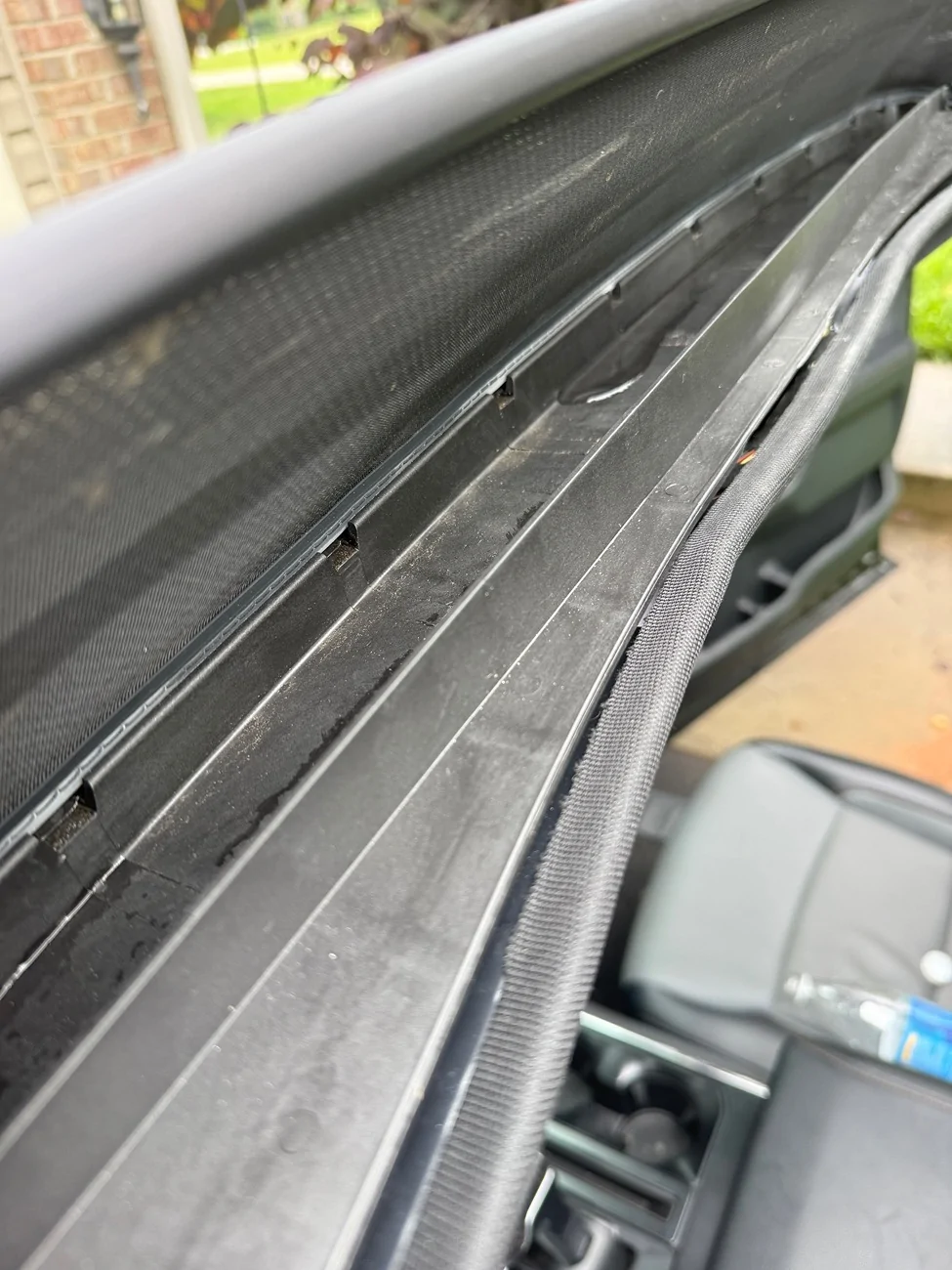

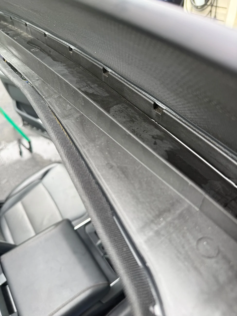

Since I always come through on my threads…
I did an extremely scientific experiment. Since yall like the metric system, I grabbed two ONE LITER bottles of water and poured each bottle directly into the sunroof drain area quarter. Just as expected, water poured out in the wheel well area very fast, let me reiterate — there is no clog on a brand new truck. It is nonsensical to even hypothesize this.
Now, since I parked the truck in the same exactly location I then poured water into the center area and immediately saw the problem — the design of the gutter system. Running perpendicular to the sunroof are these gutters. In the way that a truck is parked, the water has nowhere to go. So it pools there.
Please observe the image below. I am all ears (eyes?) for solutions other than “don’t park there bro” 😎
