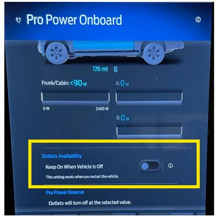

There is a FORscan tweak one can do to get that with the 2023's.
Enable Pro Power Onboard with truck off (2022-2023 only. Standard on 2024+).
Creates a Sync toggle in the Pro Power settings screen. See this post for operational details. This mod requires a PCM update that came out in early 2025 via FDRS. However, the Charge Port OTAs that came in early 2026 will also work (PT-25.13.12 and PT-25.8.5).
7D0-10-03 xxxx xx2x xx--
7D0-10-04 xxx* xxxx xx-- If 0, change to 8. If 4, change to C. If 6, change to E.
If you enabled the Advanced Charging Screen, you likely have a 6.
https://www.f150lightningforum.com/forum/threads/f150-lightning-forscan-thread-version-2.23634/

Oh shoot, I thought the "operational details' page image was of the APP...must be a toggle in the truck menu! Argh!
That’s because (unlike others) I like to post nice straight glare-free pictures of Sync. Its a compliment you thought it was an app screenshot. ;)
Good point on my note about OTAs. I’ll change “and” to “or”. One was for 23s and the other 22s.
Ha, if I had read it more carefully, and thought about it more, and looked more closely, I would have known it was the truck screen.
Getting old and needing glasses to read lends itself to such errors on my part.
All's well that ends well - PPOB running with truck off as we speak.
Thanks for sharing how to implement the feature!
