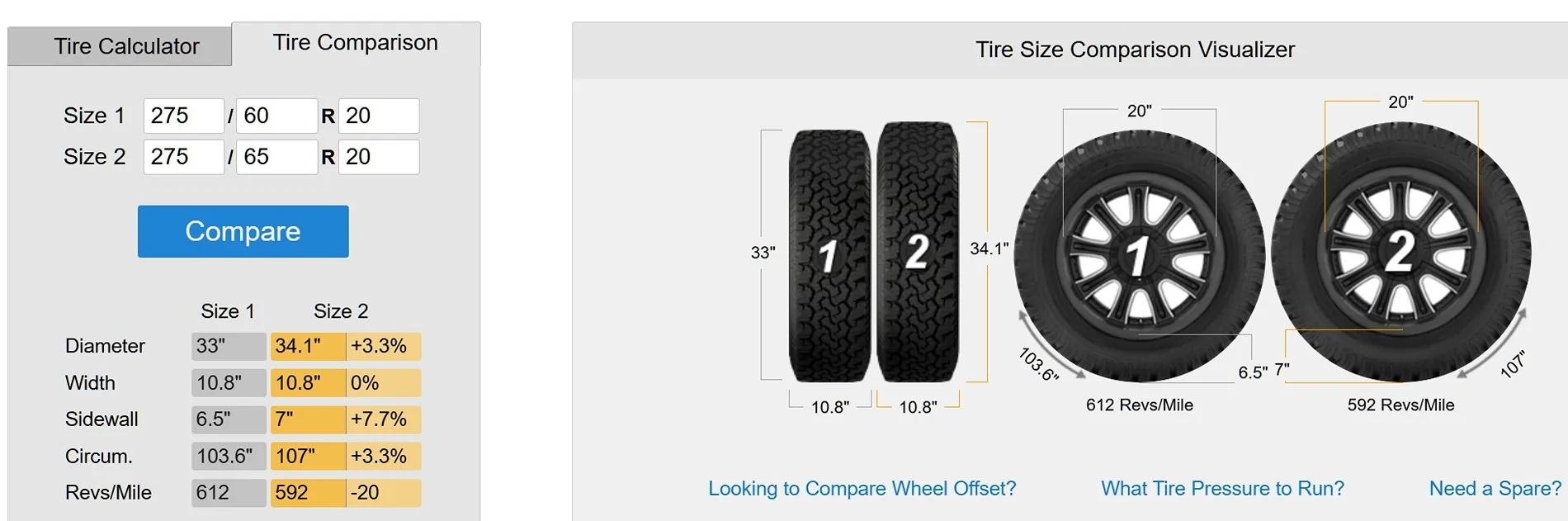

This is admittedly a cosmetics question, but I'm looking for a set of new tires that remain reasonably light (<50lbs), yet provide more of the 'big tire' look that can only be found with E-rated 35s or 295/60r20 tires.
My wheels are 20x9.5 Vision Tactical +6mm.
I would consider swapping wheels to 18s or different offset, if it gives me a better tire option. I have a 2" RC front level and 1" rear RC drop.
I like the idea of Nitto Grappler G3s in one of the following sizes:
305/55r20 - aggressive, but stock height.
275/65r20 - true 34" size, but narrower contact patch.
275/60r20 - stock size. I know these fit.
285/55r20 - shorter, wider than stock.
Let me know which of these you'd choose, or if I'm missing some other size that would fit the bill.

I think the ones you ordered are the best out of the options given. Same overall width as stock but 1.1" taller OD (whilst getting close to the 295/60 34" OD - but lacking the extra width).
With your wheel offset, this will negate any possible rubbing gotchas with 35".

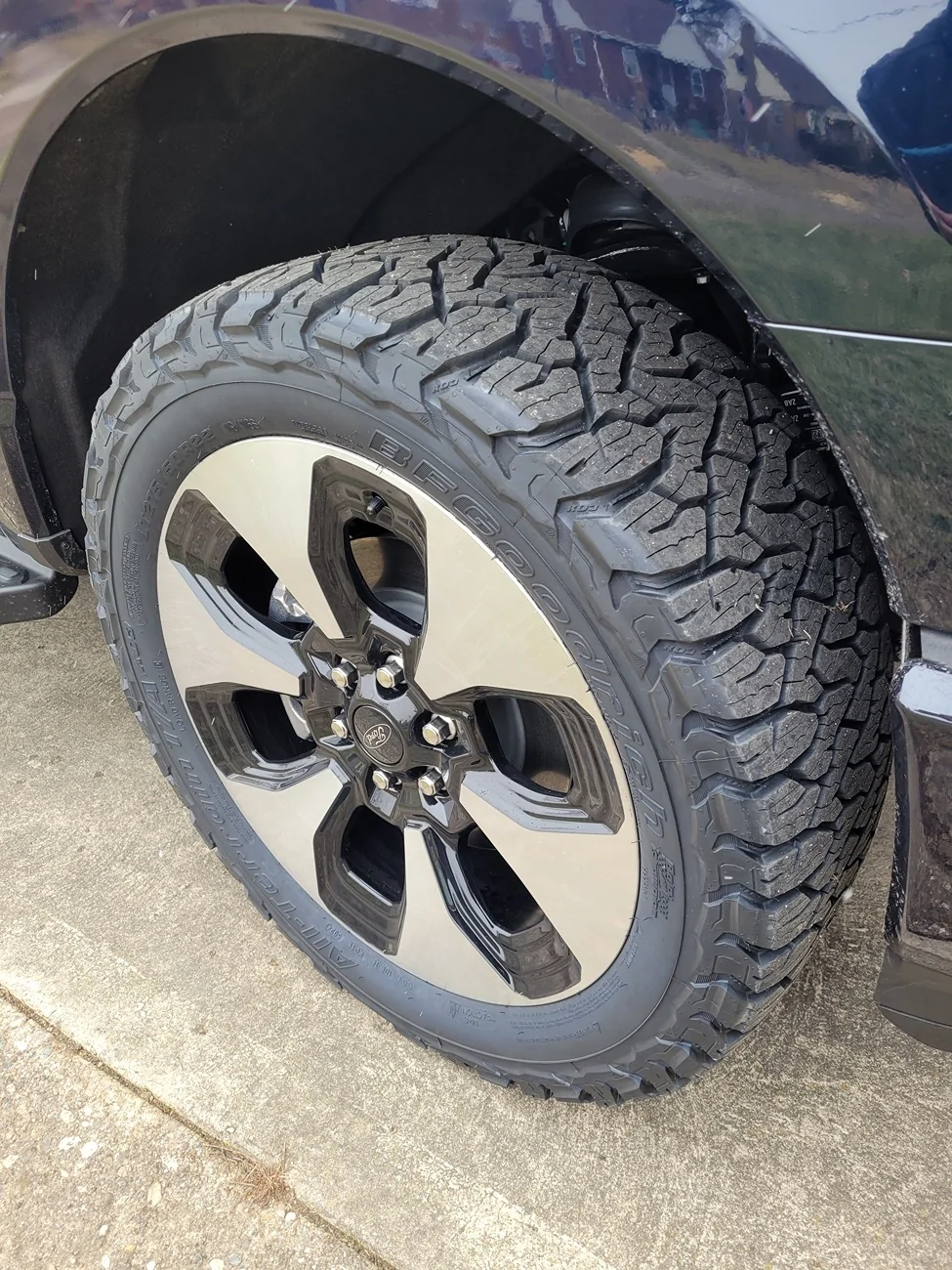

My 275/50/22 K03s

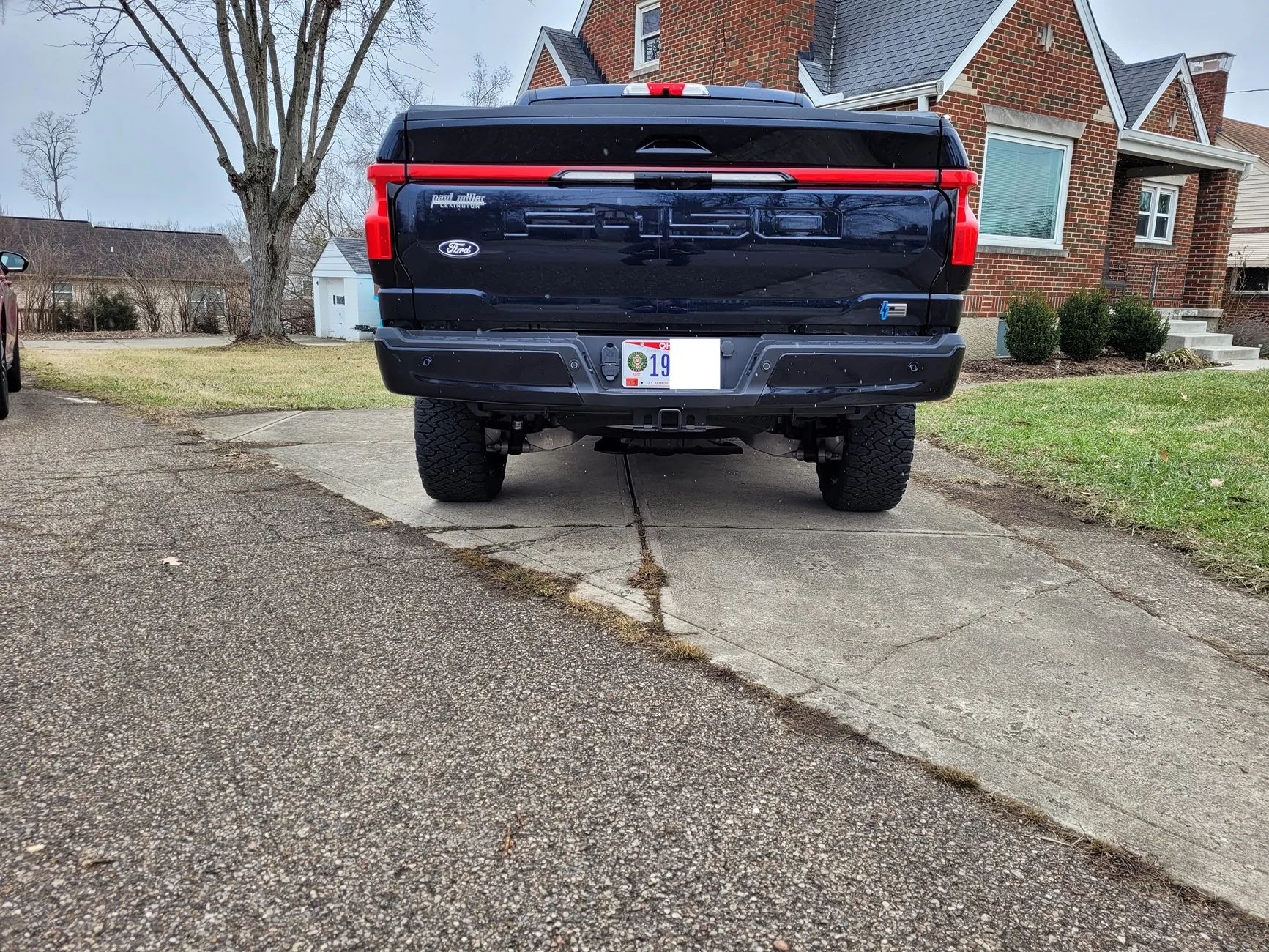

Tire Installation day follow up: After all that, I went with the 305/55r20s after seeing them side by side with the 275/65s. I'm a sucker for the wider, lower profile look. They're aggressive with the 6mm offset, but fit (barely) with no trimming. I did grind 1/4" of the black plastic air dam wrap around anyway just to give a tiny bit of breathing room where the front corner of the tire passes the air dam while approaching full lock.
No regrets, but if I could do this again, it would be with a 25-30mm offset stockist. keep it slightly more stock like.
Pics coming in daylight.
