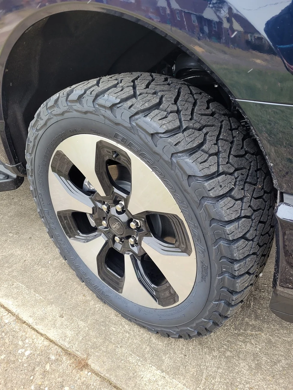

Love my KO3s Got 12,000 miles on them NO issues.

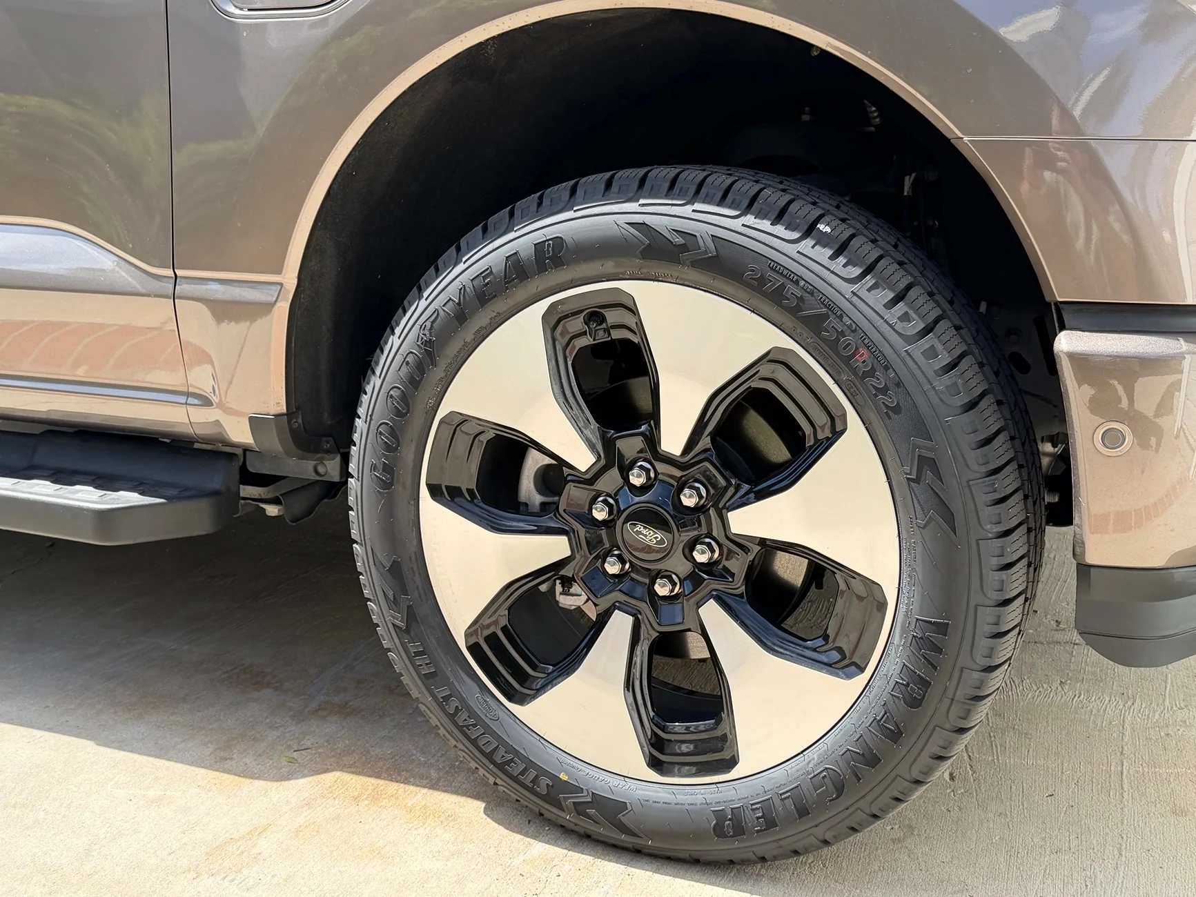

I threw the wrangler steadfast HT on mine earlier this year after getting a bulge in my general grabbers at around 24kmi. More of an all terrain tire than efficiency tire that the grabbers are but won’t get you the lift you want either. Fair warning that you will experience a loss in range. I’ve lost 0.2-0.3 kw/mi in my new tires.

note to the OP that both recommendations so far are both 275/50/R22 which is the same as the stock tire size, and the manufacturer's recommended spec.

The KO3's look dope!!!!!!
