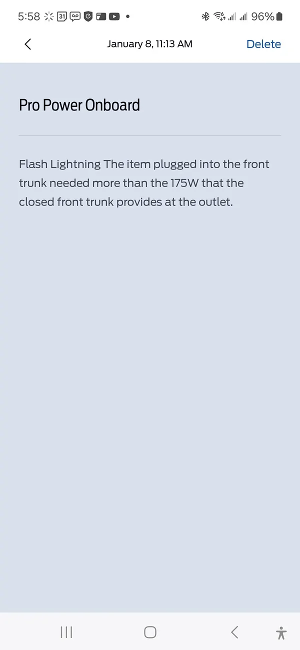

Plugged into the frunk outlets and was fine drawing roughly 600 watts. Until I got a notice that it's limited to 175 watts when the frunk is closed and shut off minutes later.
What outlets can be used when the truck is stationary and parked with doors and windows, bed locked close?

Yeah, the manual mentions that the power is limited in the frunk when it's closed. You'll have to draw power from the bed outlets for the higher power applications.
5,164
6,865
Frunk limited to 400w when closed.
I hear what you're saying, but Ford is not doing what you're telling me.
Yes, I have the $1200.00 pro power option in both my Flash and Pro.
Like I said , 175 watts will barely charge a cordless battery pack. 4 outlets and they expect you to leave the frunk open when in use? What is Ford thinking.

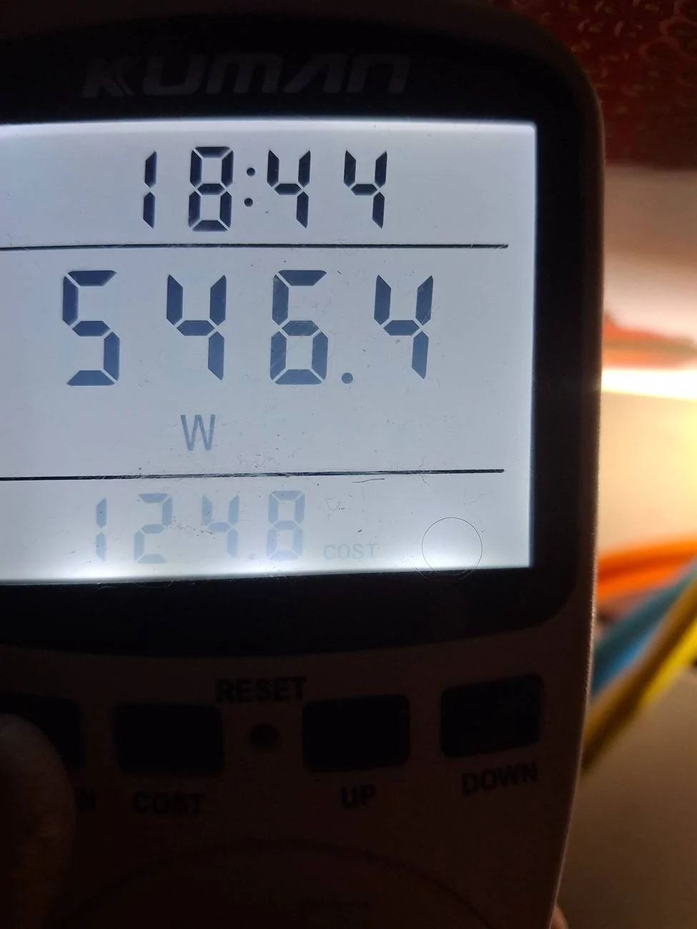

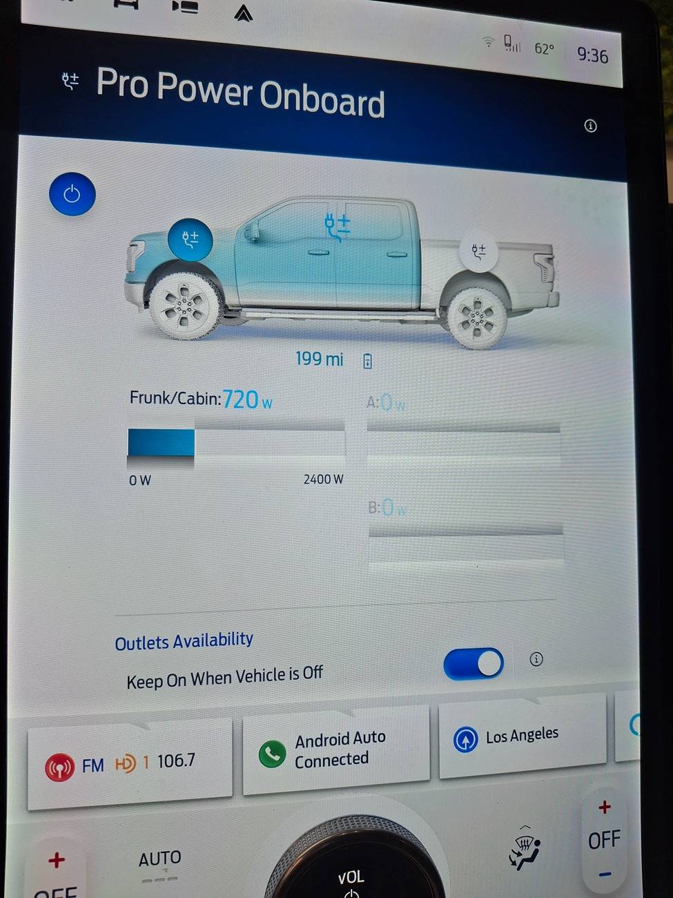

And when I got home I flipped the truck around to plug into the bed outlets. When I looked up,I noticed my front Ring camera led floodlights were on. Power was restored just as I was ready to power back up.
I wasn't looking to power up the house. Just run the fridge as my 4 batteries for my off grid solar were trying to charge with limited sun. Also slow Charge (80 watt) my 4-40 volt 6ah inverter. Plus 2 more portable inverter devices.
Didn't want to run a generator nor plug into the truck over night.
When I check my charging needs and fridge load, I was showing 546 watts on my load meter, add another 160 watts when the fridge cycles. Probably why the truck was showing 720.
This entire time the frunk was closed.
Then I got the 175watt shut down probably 1 hour later while I wasn't home. Of course no way to reset it when not home so no way to continue charging. That's the whole reason I left the Flash home and took my Nissan ND to the job.
