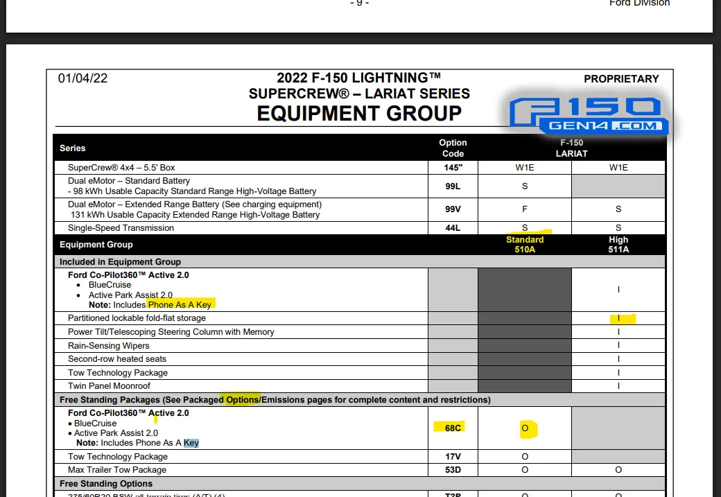

So, my vehicle is a 2022 Lariat, not ER, and the sticker shows a build date of 07/22. I’m just trying to verify that PaaK is NOT available. In the app, I don’t see the option to add it, and to my knowledge, the software is up to date. Is there a definitive way to verify that PaaK and Bluecruise will never be available for this particular model?

The 2022 Lariat-SR does not have PAAK unless extra option package was ordered
https://www.f150lightningforum.com/forum/threads/2022-f-150-lightning-order-guide.7858/
https://www.f150lightningforum.com/forum/attachments/2022-f-150-lightning-order-guide-pdf.35355/

Based on the post above, your truck did not come with the package that includes Bluecruise and PAAK.
