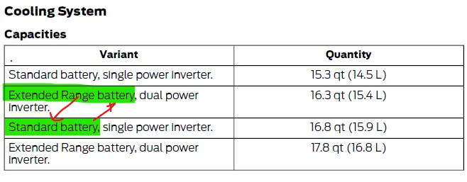

Are you doing a lot of DC fast charging? Especially when cold or after the truck has been driven hard between charges -- think road trip and maintaining 75+ MPH most of the way... Rapid heating while charging can cause the coolant to vaporize and the pack will vent. We get that in our Tesla and it's worse when it's cold because the cold coolant emanating a rapidly heating battery causes a lot of steam. Have not had to top off coolant though, but it seems Tesla has a larger reservoir. I'm wondering if there's more coolant in the system on Lightnings with the Max Tow package that has the additional conditioning loop?
The capacity variation is more a function of ER vs SR, the Max Tow extra AC Comp only requires a little extra coolant tubing/hoses.
This chart might be flawed with the ER/SR labels
