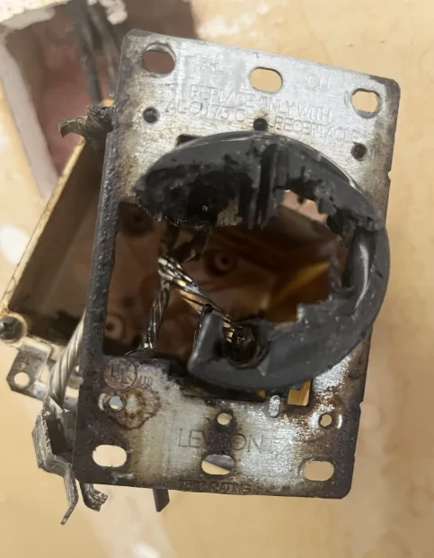

The EVSE not doing any AC-DC conversion does not mean it doesn't produce any heat. The conductors and everything they come in contact with will still get very hot. That's why the internet is full of pictures like this:
The reason th internet is full of pictures like that is because the world is full of people who think they know what they're doing.
Something is wrong if your setup is getting hot, poor connections, undesired wiring, etc.
While heat is generally the enemy of electronics, I'm not sure spending $3000 on an overkill charger setup because it'll "last longer" is a solid investment when you can buy four new chargers for the difference in cost, but to each their own I suppose.

And we don't know if those were properly installed. Receptacles can cause problems if the terminals aren't torqued properly. I bought a torque screwdriver for installing mine because of receptacle problems I read about and the recommended torque turned out to be a lot tighter than I expected.
