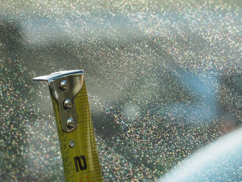

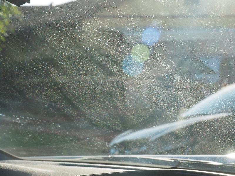

Update: Here are a couple of photos at 800pixels wide reduced from 4000pixels. This is after a claybar treatment by the dealer. I am amazed at the specks that I was able to see across the windshield from the passenger side. Today I started the process with the dealer service dept. to contact Ford for a warranty replacement.
Ford F-150 Lightning Windshield tiny dots specks that show in bright sunlight? VC063369.JPG
Ford F-150 Lightning Windshield tiny dots specks that show in bright sunlight? VC063375.JPG
Update: Dealer never followed through. Tried the isopropyl alcohol and after a few attempts, I think it removed some sparkling excess dust and maybe some particles left by the dealer claybar, but a sparser pattern of bright specks still remains. Need to get a good photo of that.
Update 11-2023: after having the windshield replaced due to a rock hit, the new windshield has the same trapped tiny specks in its lamination. So no fix, just better manufacturing is needed. I think I read something about keeping air out of the laminating process?
