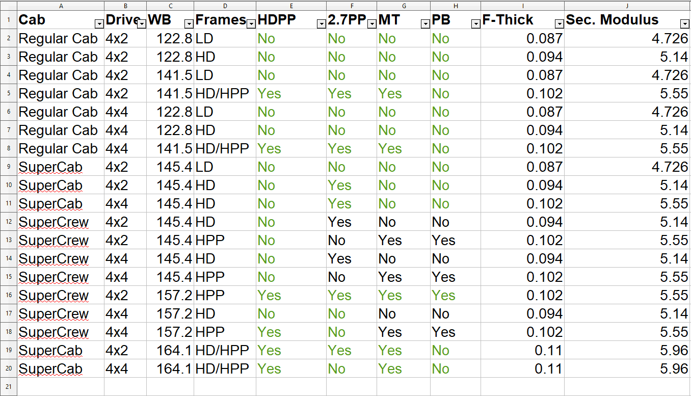

I am working on this matrix to see what frames go with what build outs. The Greens mean pretty much guaranteed to be that way based off restrictions in the build & price as well as different notes from different documents. I am pretty sure the details are accurate, but I could have made a typo some where, just like Ford does in a lot of their documentation. The Yes/No for the 2.7 Payload Package, Max Tow (MT), and PowerBoost (PB) that are in black are just best guess. I would like to cross reference this with what people have to see if a Max Tow or a PB have the thicker HPP frame, when not combined on the same build.
It would be great if people could contribute by post their frame stickers for 2021 with the specs of their truck?
