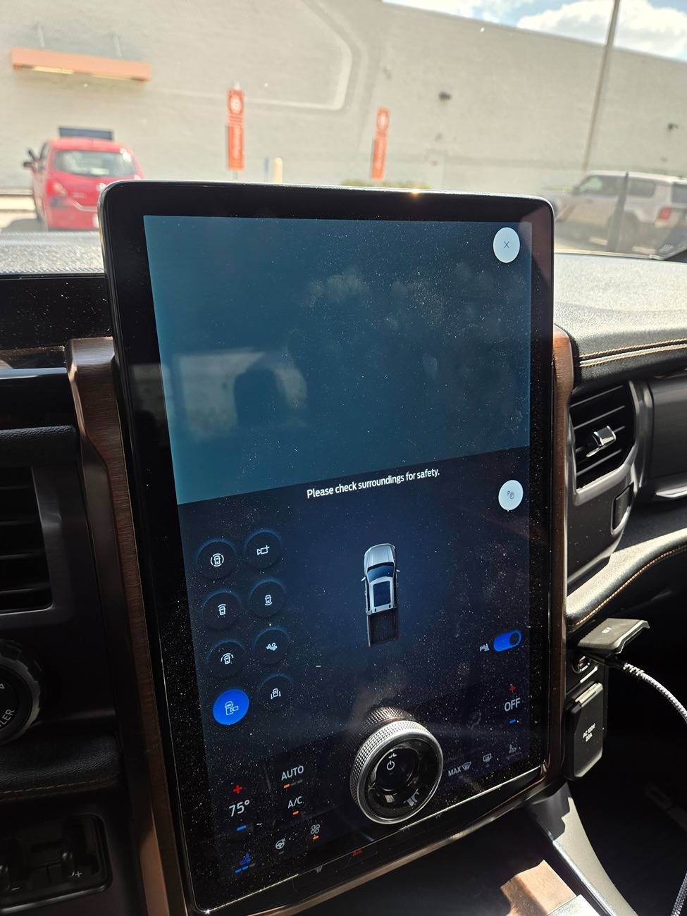

I've never had to use the feature but only recently noticed the camera isn't functional at all. Is there anything I can do via forscan or phyisically reset it before bringing it in to Ford?

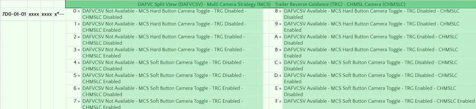

You also show a "D" here which means the bed camera is enabled, so I don't think it is a config issue. Seems like the camera itself took a crap, or maybe check the plug to make sure it is seated properly.
