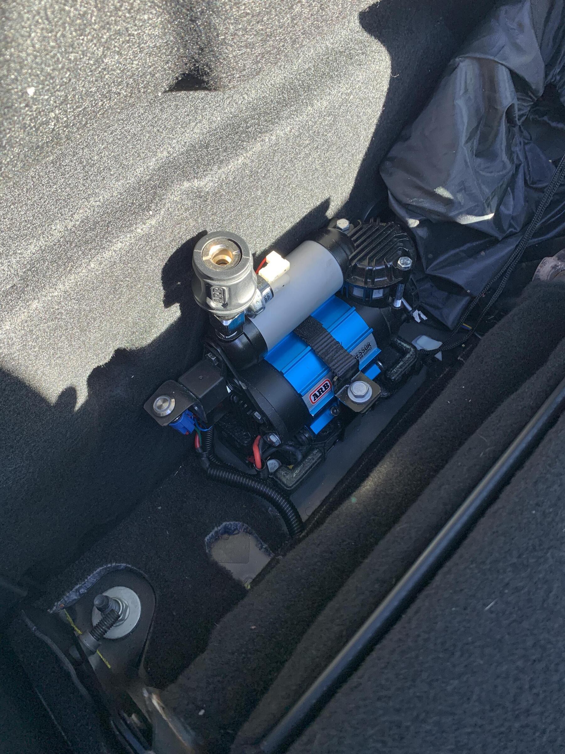

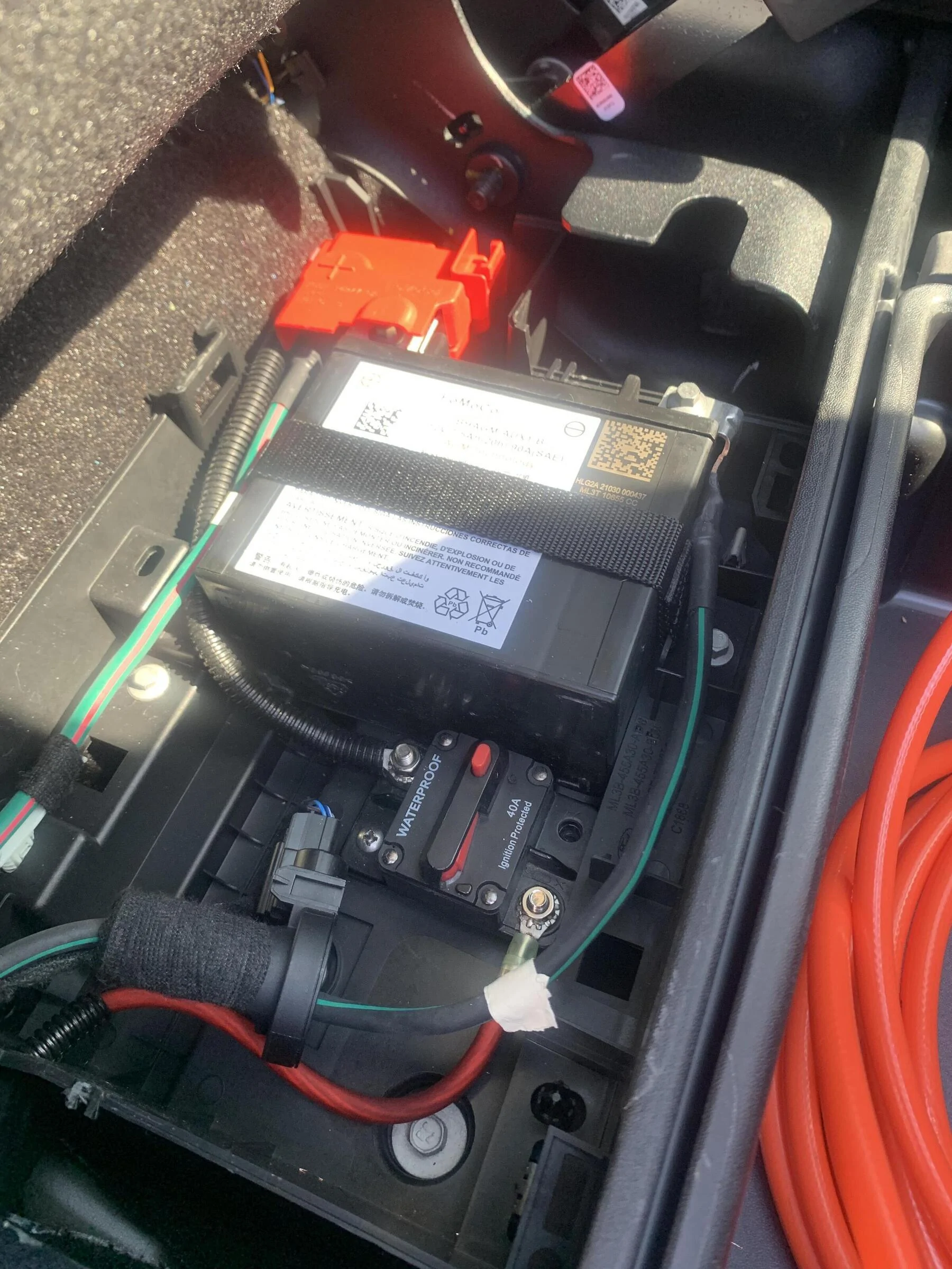

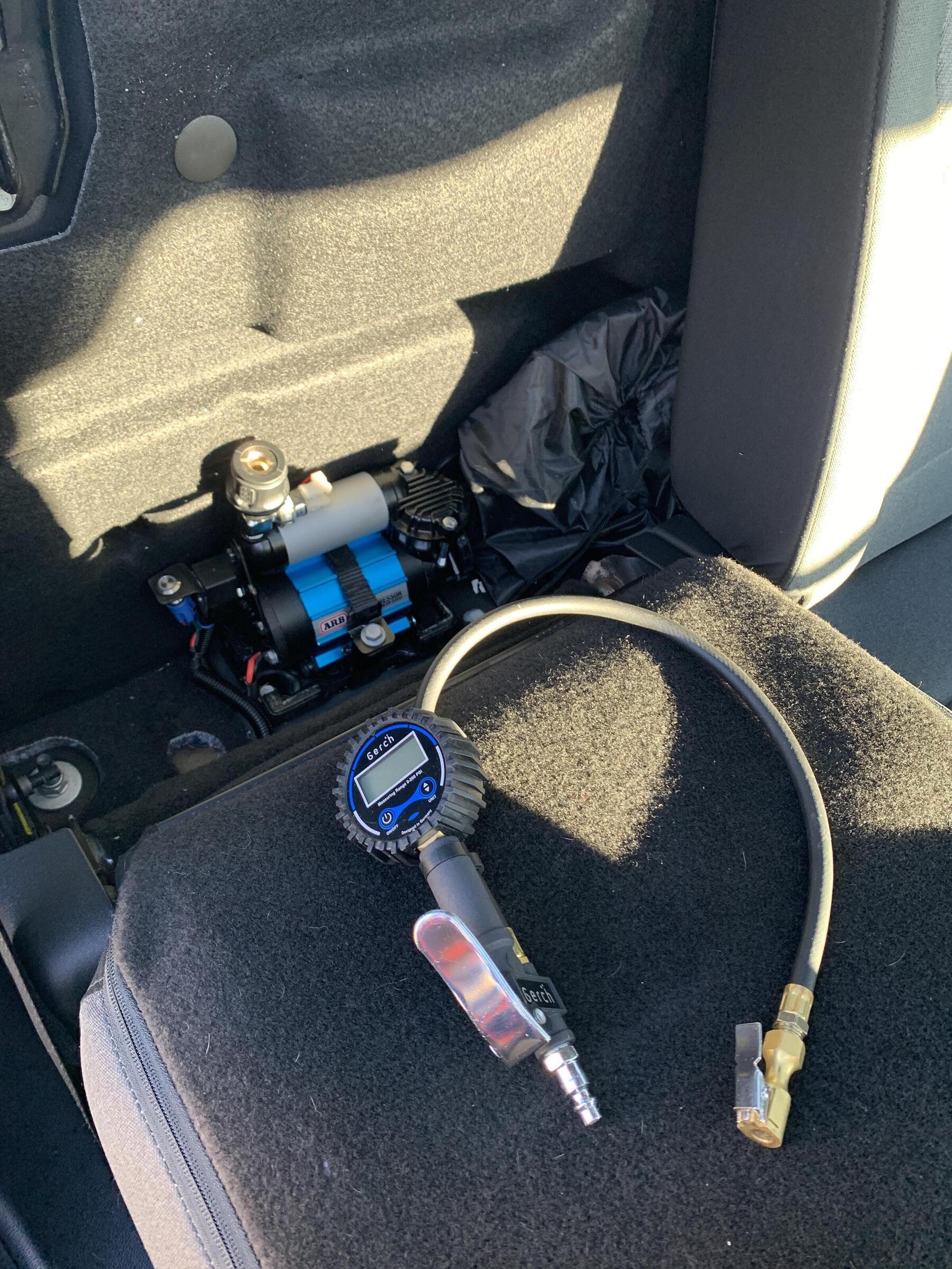

First thing I did was install my trusty ARB compressor. It's been through 4 vehicles over the years. Originally used to air up after offroading, now I use it to keep my camper and boat tires up to pressure.
This install was neat, in that it fit into the jack holder, behind the 40% rear seat with just a little modification. The foam keeps it nice and quiet. Plus the second battery is right there to power it up. That battery is plenty for that little compressor. I moved the jack behind the 60% rear seat back.

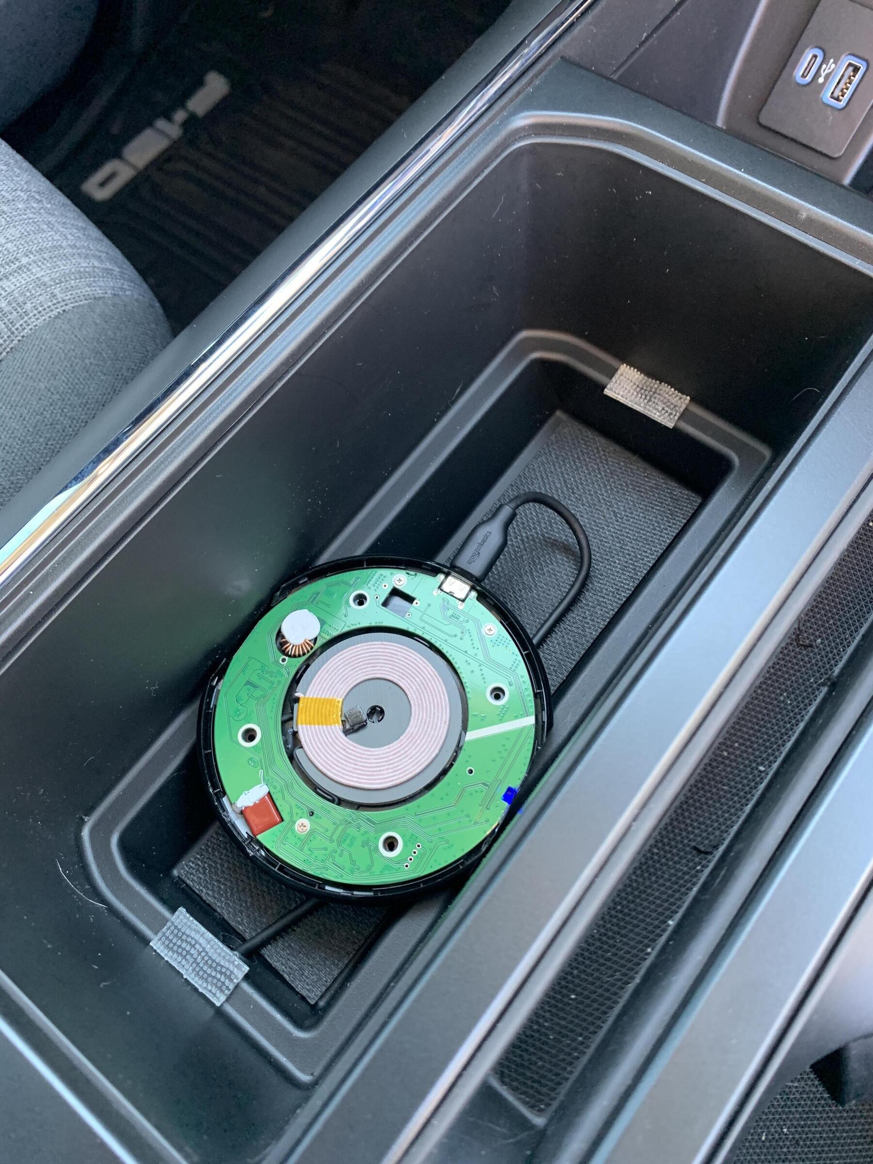

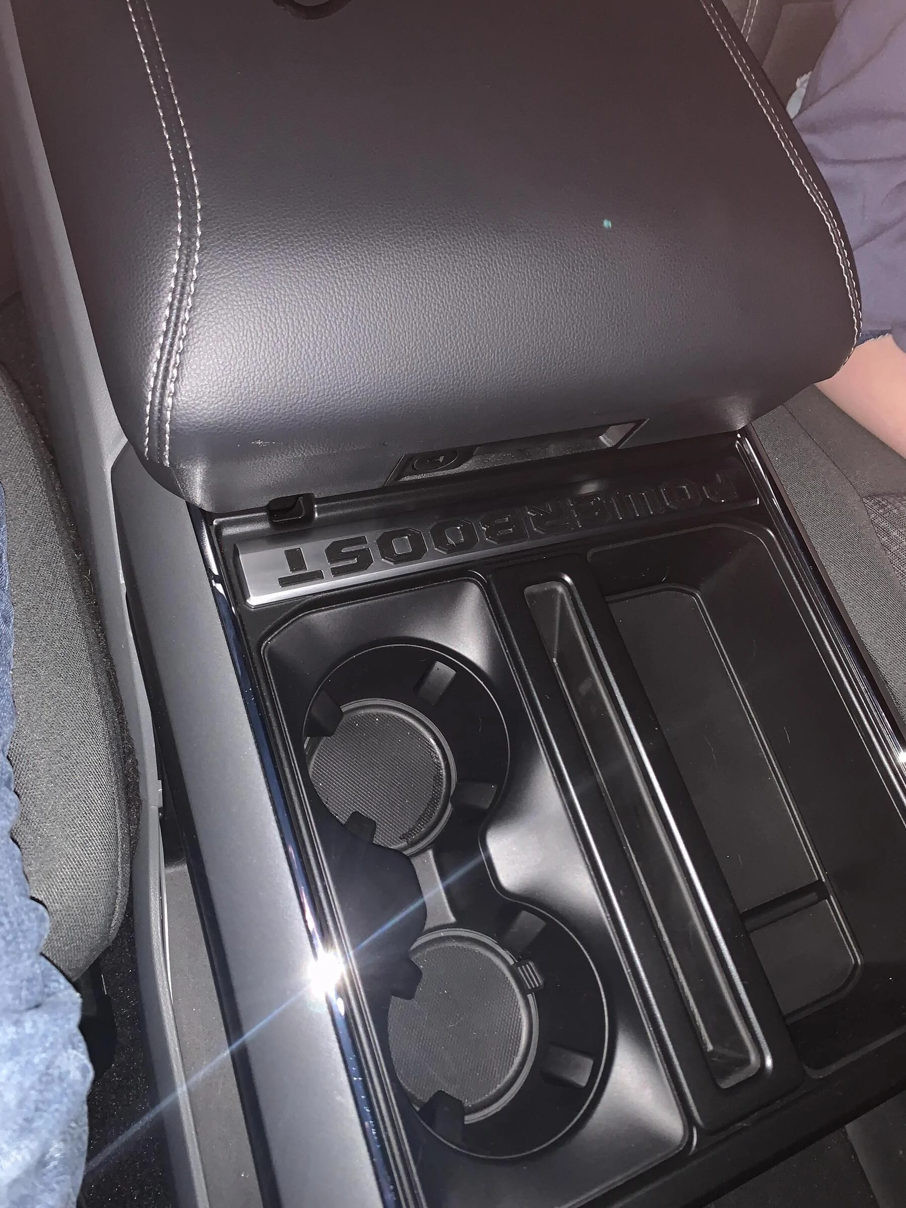

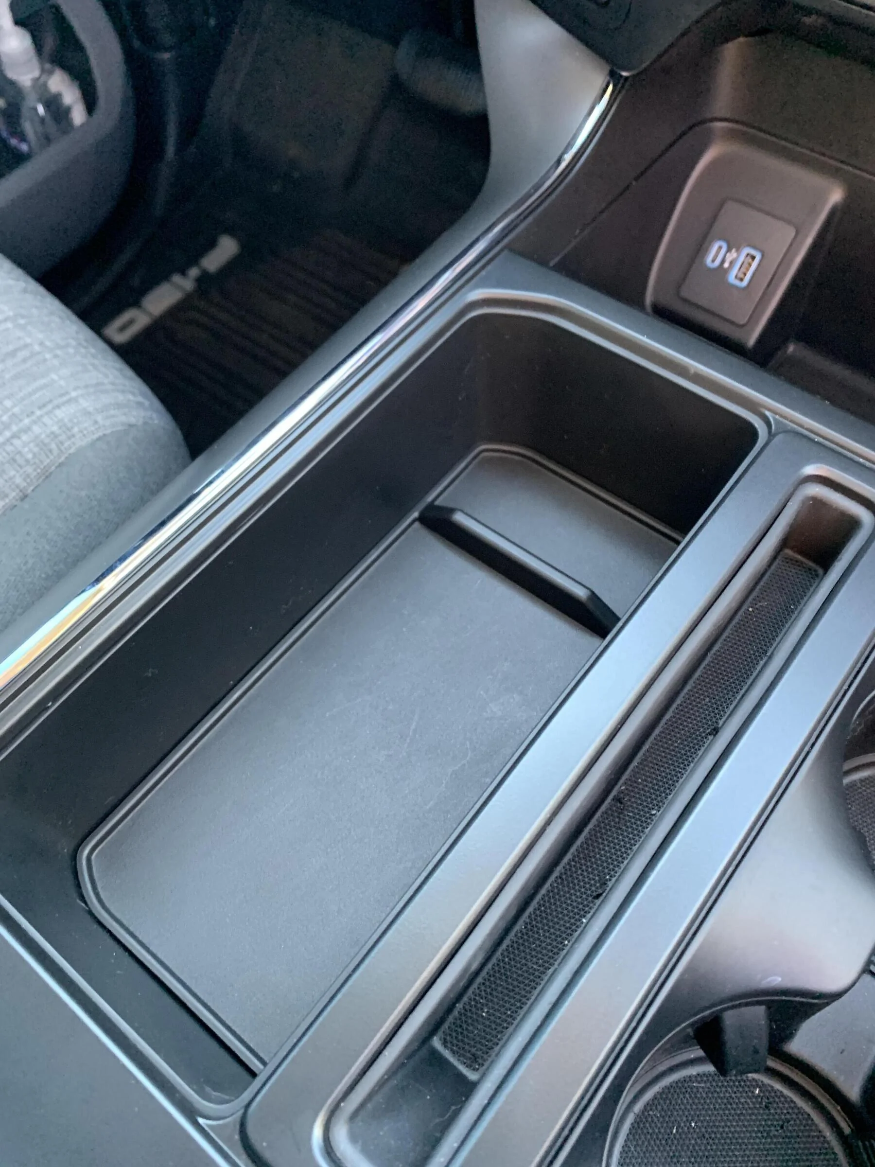

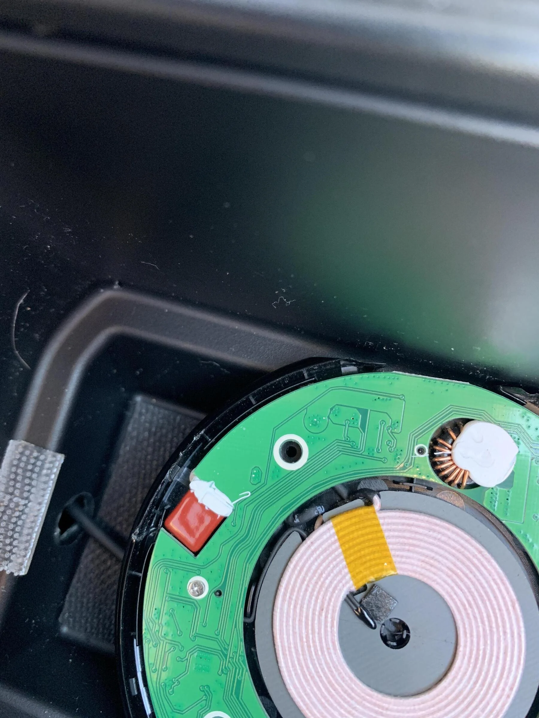

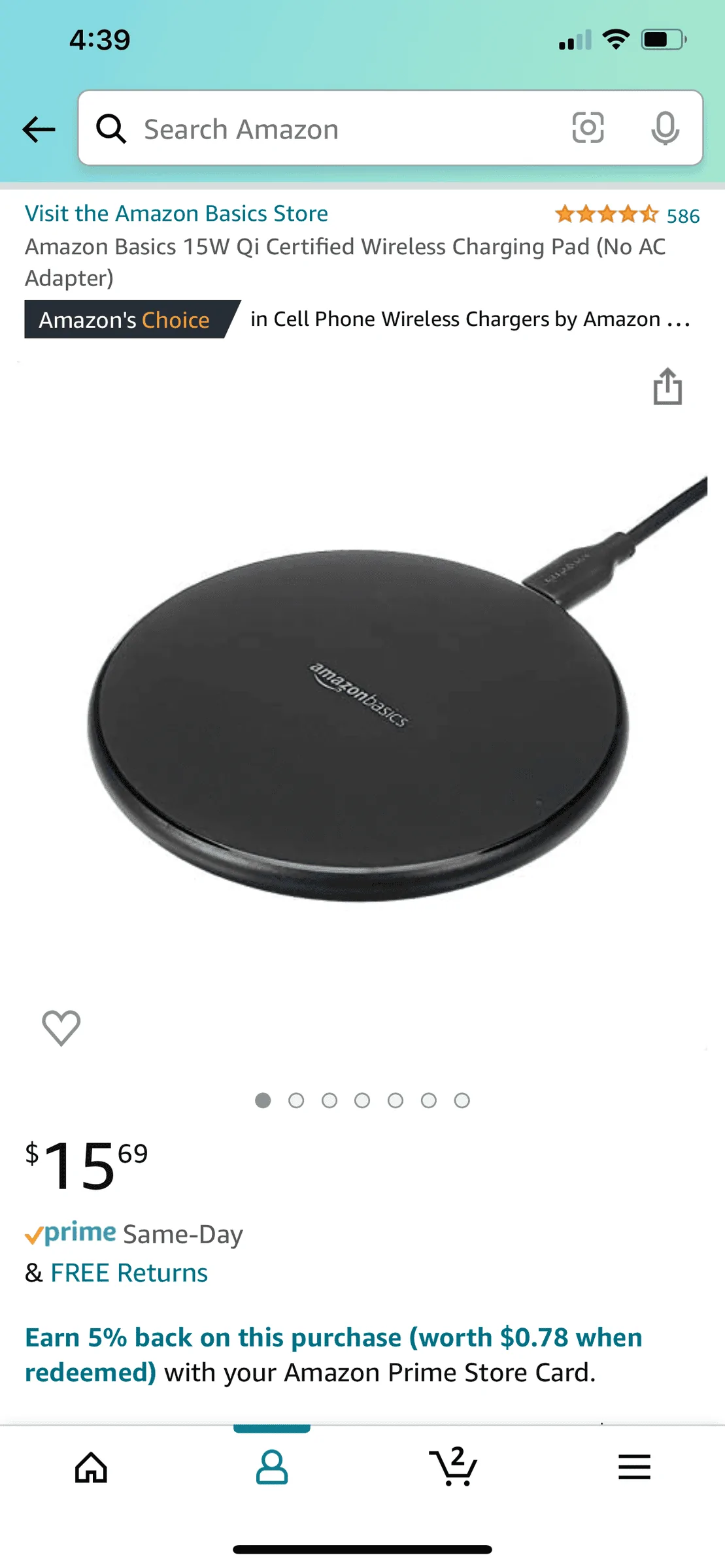

My truck didn't come with a wireless charger, so I added one for less than $20

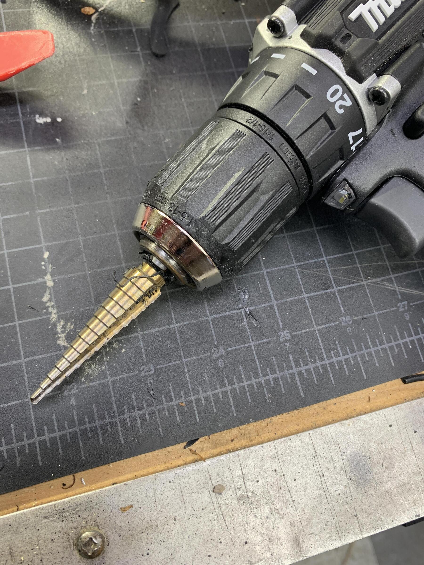

I used an Amazon Basics charger, drilled a few holes with a unibit, some heavy duty Velcro and done. Works like a charm.
To get the charger apart, pull off the rubber grips on the bottom to reveal 4 tiny phillips screws. Then I sanded the sides just a bit so it would fit properly. Plugs into the console USB.

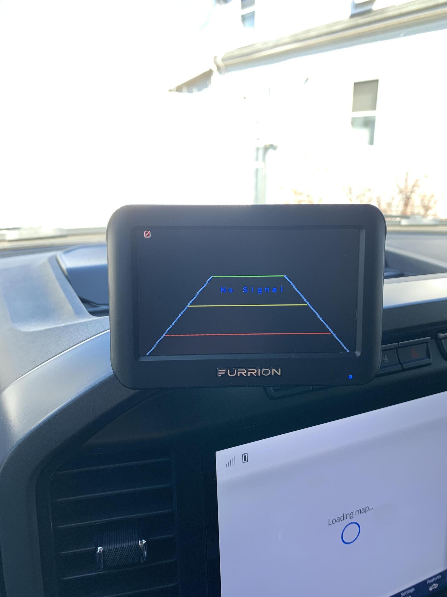

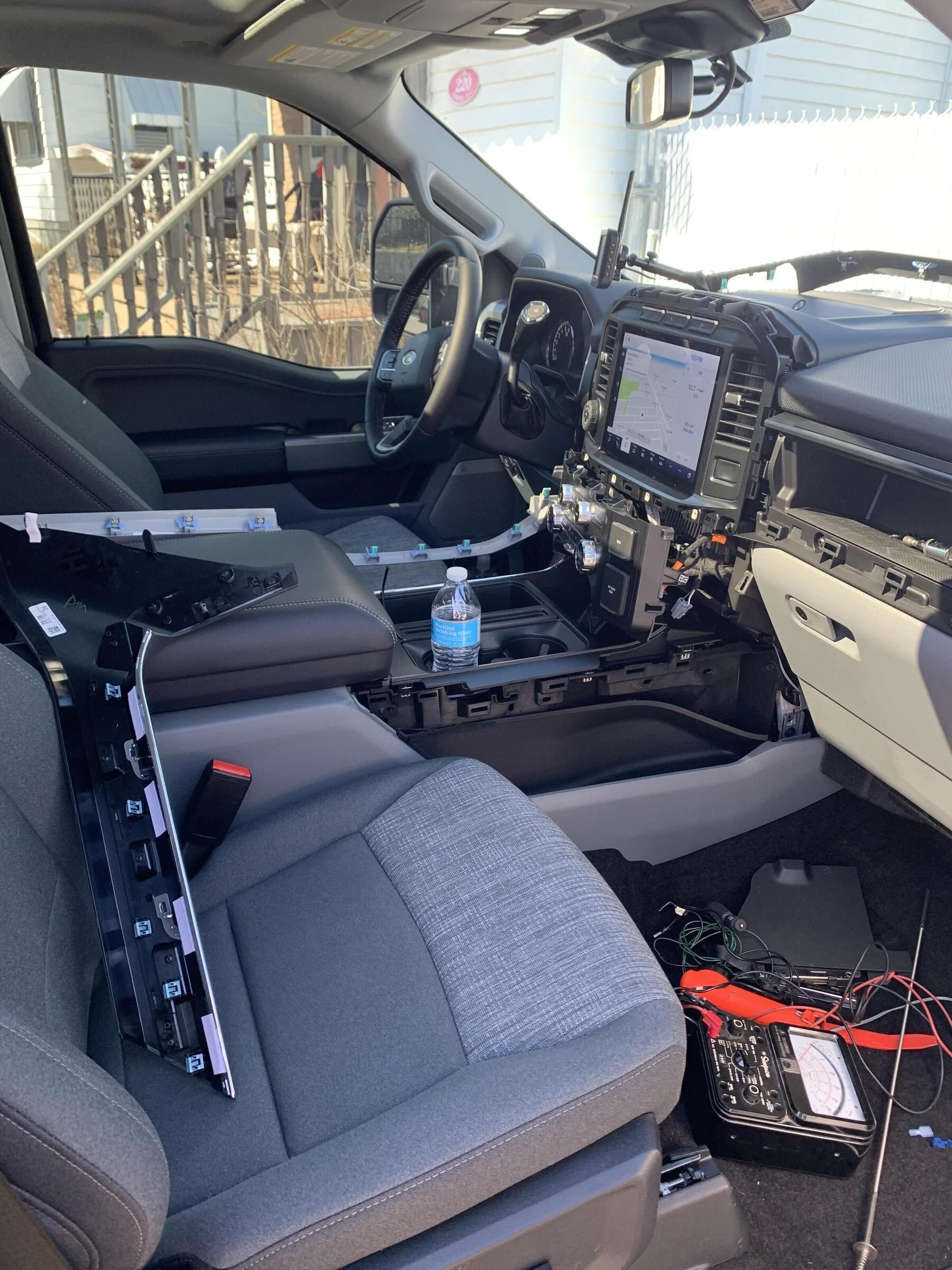

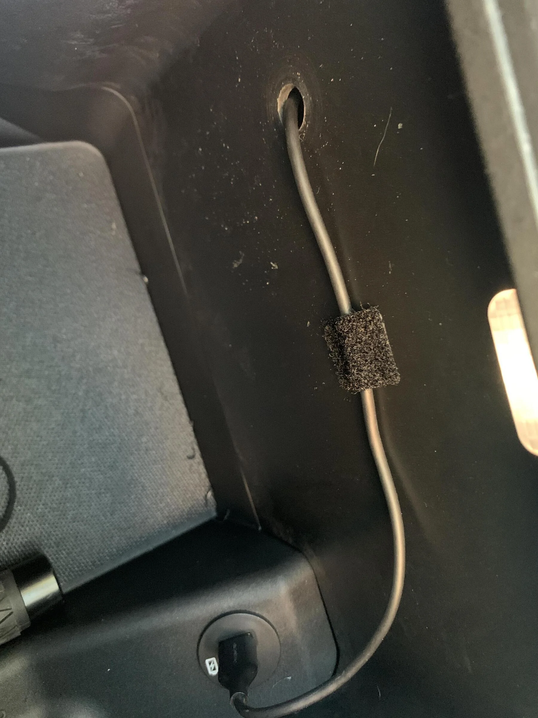

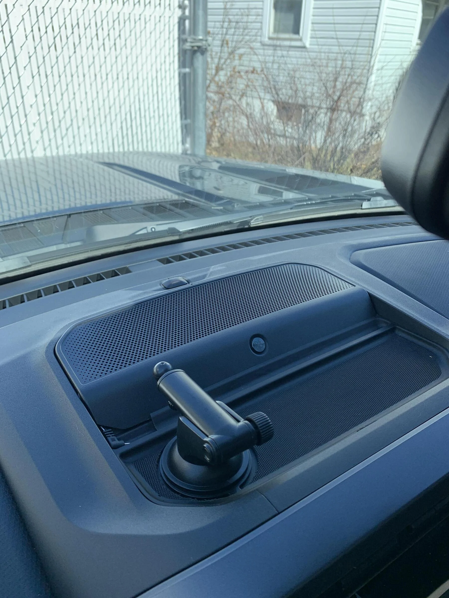

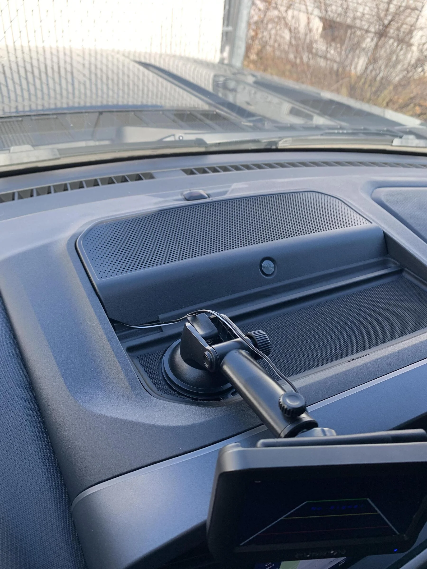

I wanted a relatively clean mount for my camper rearview monitor. I tapped into the 12V power outlet. I got to take some stuff apart today, lol.

How long is your air hose to make it from there to a trailer?

I have two 20' hoses in that black bag next to the compressor (I think in the pic it's only 1 hose in there though)
I blew up 3 cheaper compressor before shelling out the cash for the ARB. It's a real good piece of kit!

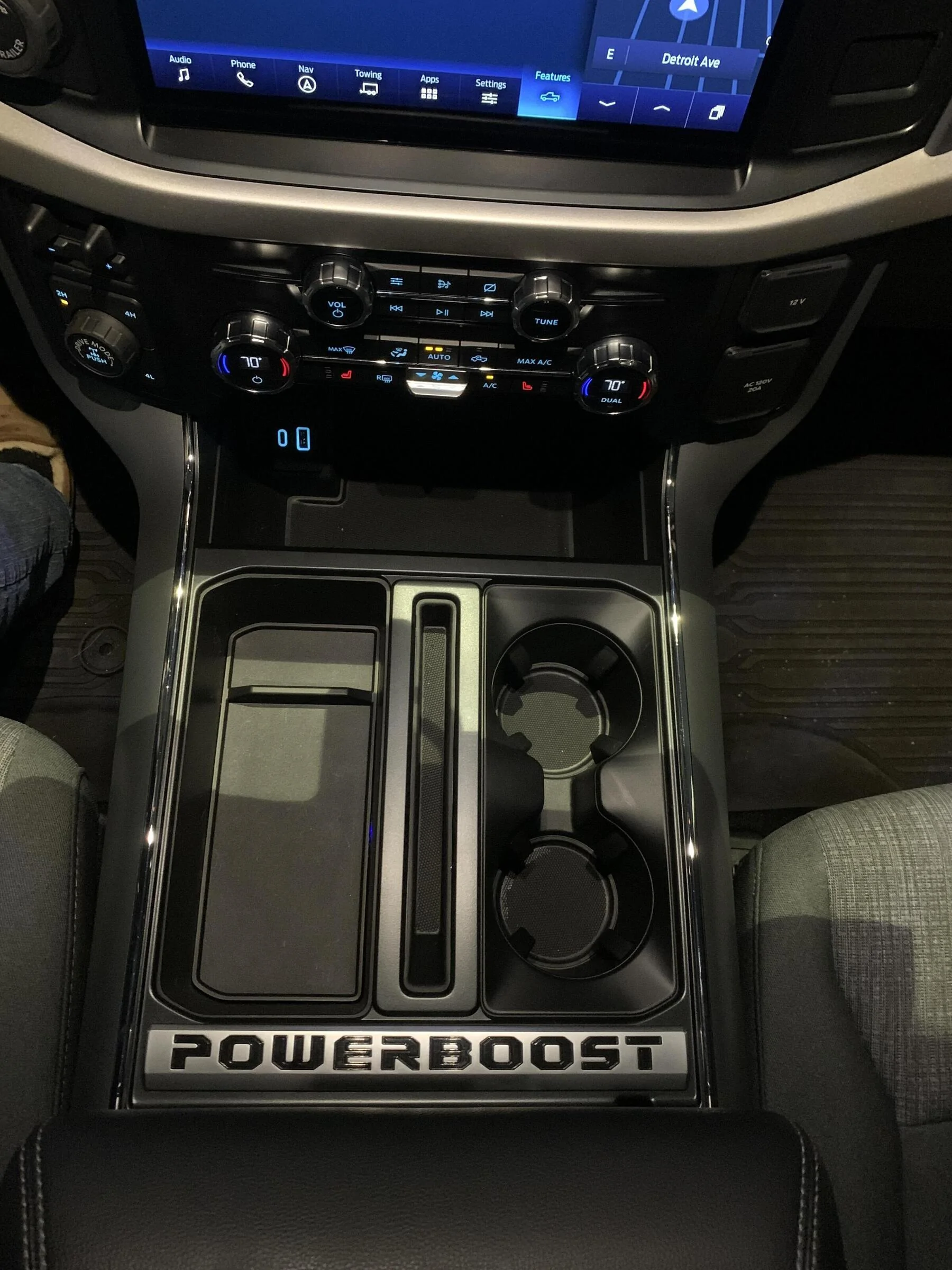

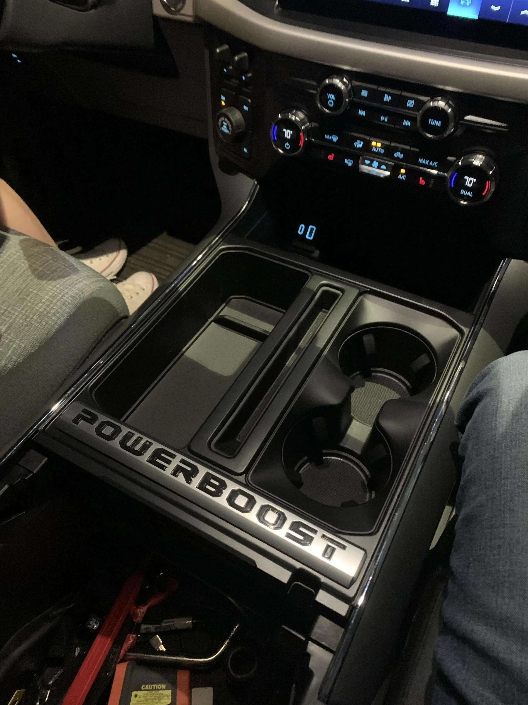

Today I took off the "4x4" stickers and the "Powerboost" emblems, to clean up the outside a bit.
Whoever at Ford came up with the adhesive for the Powerboost emblems should get employee of the year. Those emblems will be the absolute LAST thing to fall off these trucks. What a PITA.
Anyway, I was able to save one of them and I kinda like it here... My youngest daughter helped with the decision!
Opinions are welcome- I have thick skin, lol.
