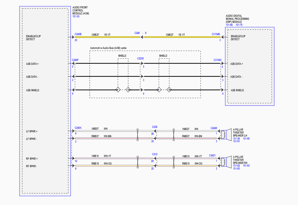

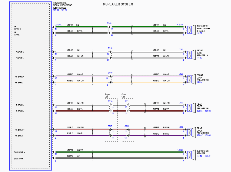

Not sure if anything changed for the 2024, but on on the 2023 with the * speaker set up, set up is like this:
Ford F-150 Lightning B&O Amp drives which speakers? 1723214640739-gm
Ford F-150 Lightning B&O Amp drives which speakers? 1723214656286-nt
Reactions: GDN

Interesting. I don’t see a center dash speaker.
wait. Nevermind I see it. I wonder why they bother running the tweeters off the ACM?

I'm guessing it is cheaper than putting an 8-channel amp in all of them. Probably got a good "deal" on 6 channel amps from the supplier.
