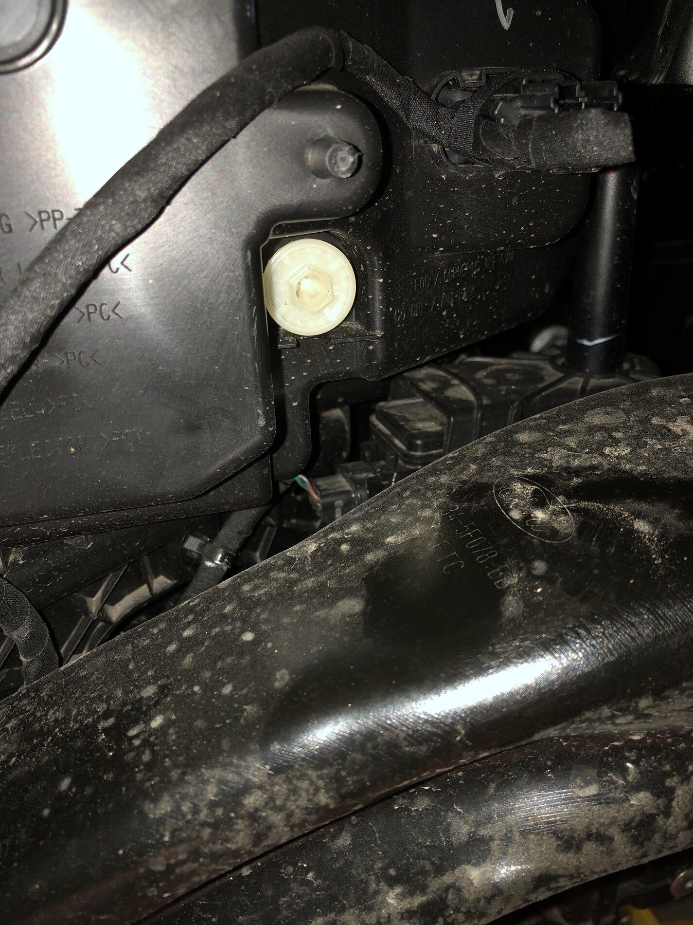

You can adjust the fog lights up or down. I raised the aim of mine up. I took the front tires off and then a couple front screws out of the felt wheel liner and gained access to the white adjustable screw. See picture of the screw adjuster. You need a 7mm socket to remove the black wheel well liner screws and then remove a black plastic screw holding the felt liner in. Pull the liner back a bit. Then use a 10mm socket and turn counter clockwise and the fog lights turn right up.
I had a piece of plywood about 75 inches away. The top of the fog beam was around 20” off the floor. I moved the top of the beam up to 24”
Test it tonight when it gets dark out.

Update, I pointed them up a bit more than mentioned in other post. Wow! huge difference, much better. Even when you turn left or right the cornering fog light comes on and lights up better.
Ford is not setting them at all or setting them way too low.

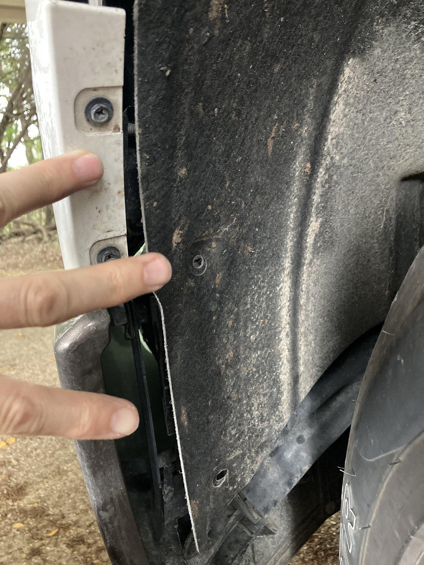

You can just take out a 7mm screw or two on the felt wheel liner and pull it back a bit. That will get you enough room. I used a 1/4” ratchet with a short 2” extension and 10mm socket. It worked good. Aim them on a garage door or something and watch the alignment.

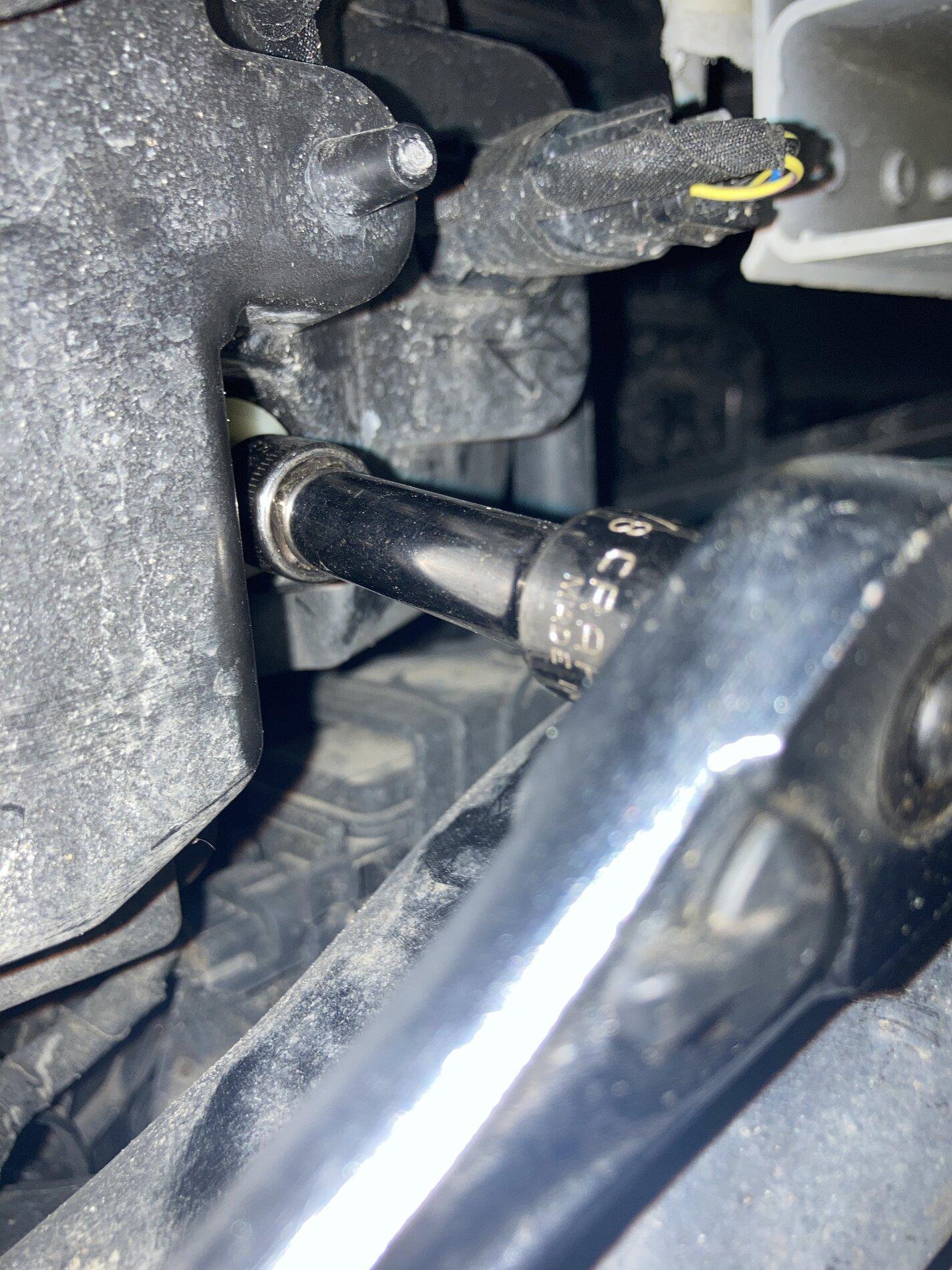

I finally just adjusted mine. Thank you for that. LED Factory Fog Lights are now useful! Was able to just stick my hand behind the liner, with the wheels installed and straight using a long 10 mm socket with hand.

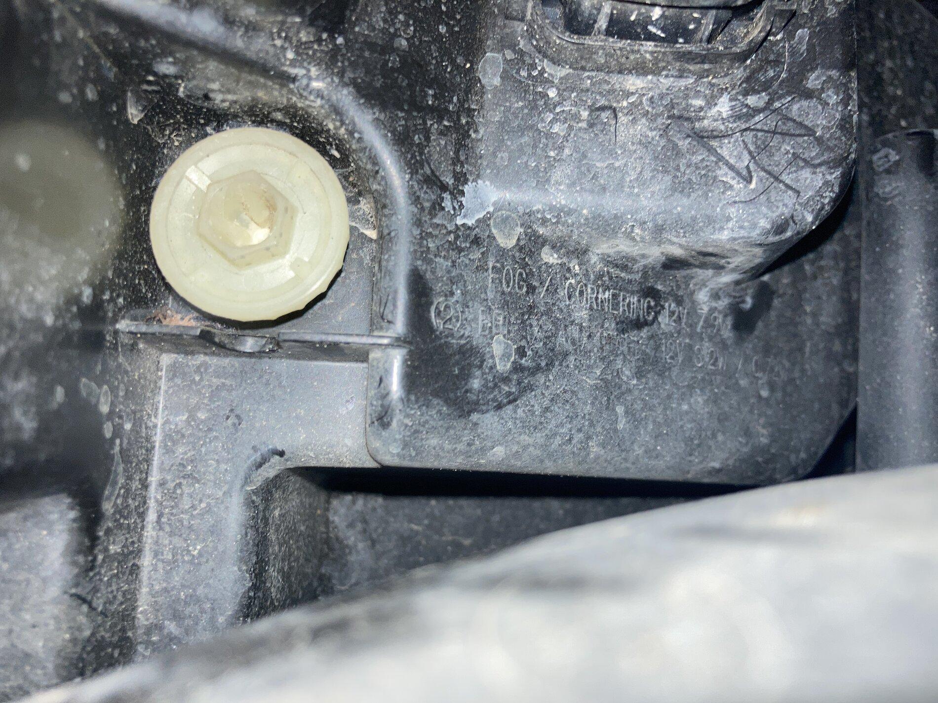

Did the same thing, took off two screws. Here are pictures of my drivers side.
