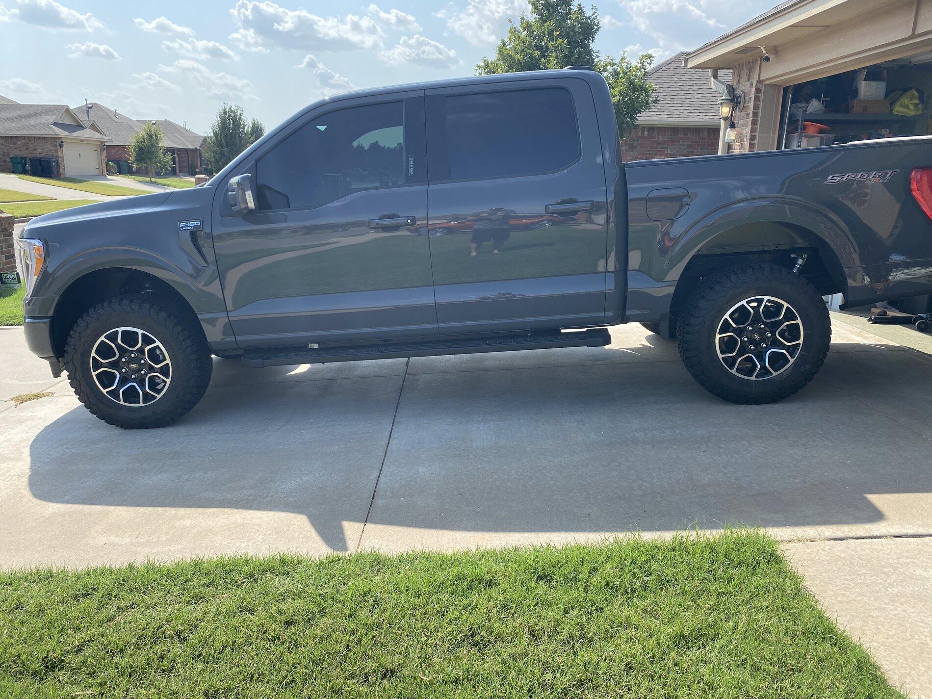

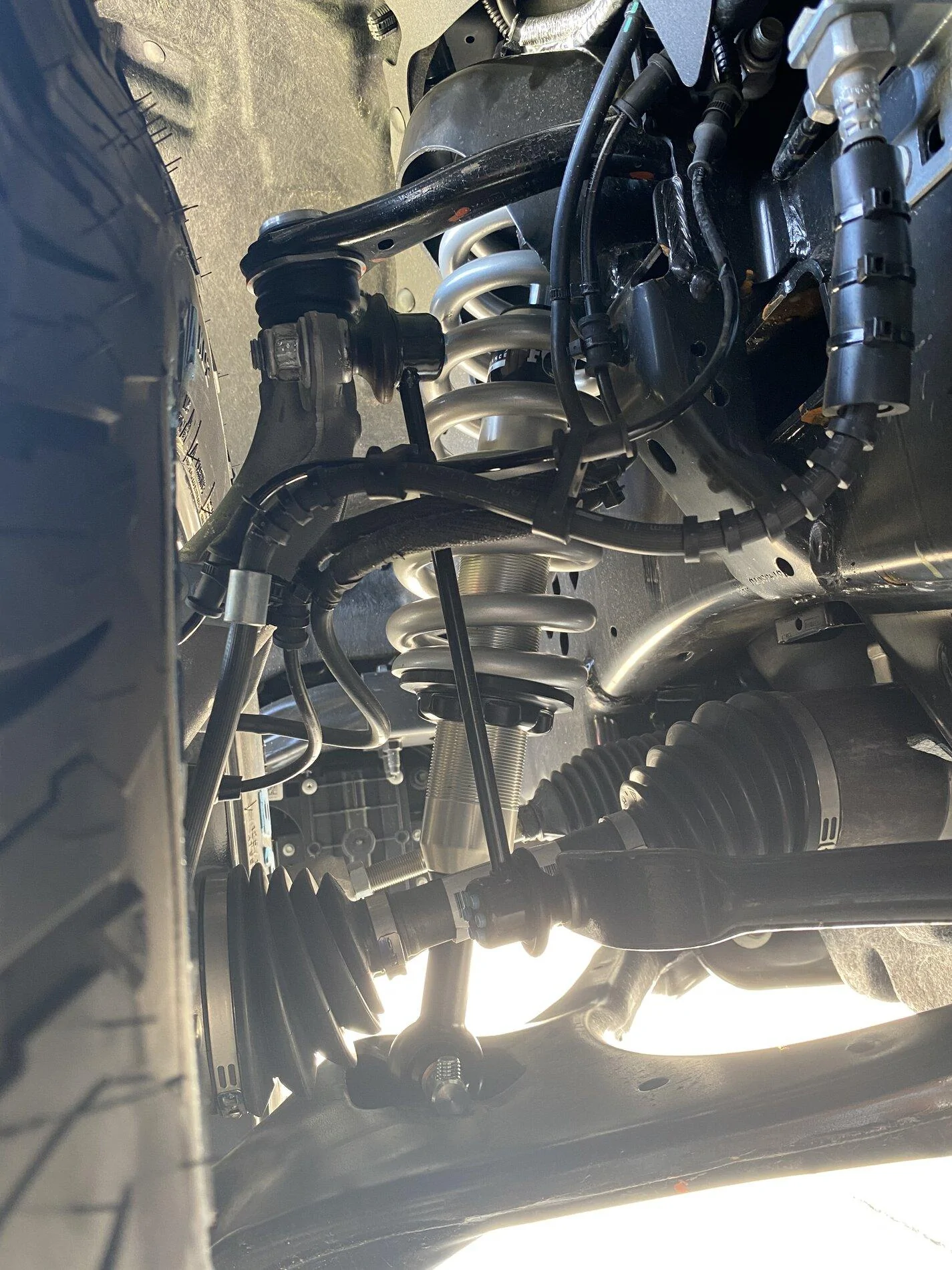

Had regular fox 2.0 installed along with halo 2.25 rear blocks. I wanted factory rake and it appears I have around 2.5 now versus 3.0 ish stock.
Paid 470.00 for front install with adjustment, alignment check (said no adjustment were needed) and to have rear blocks replaced.

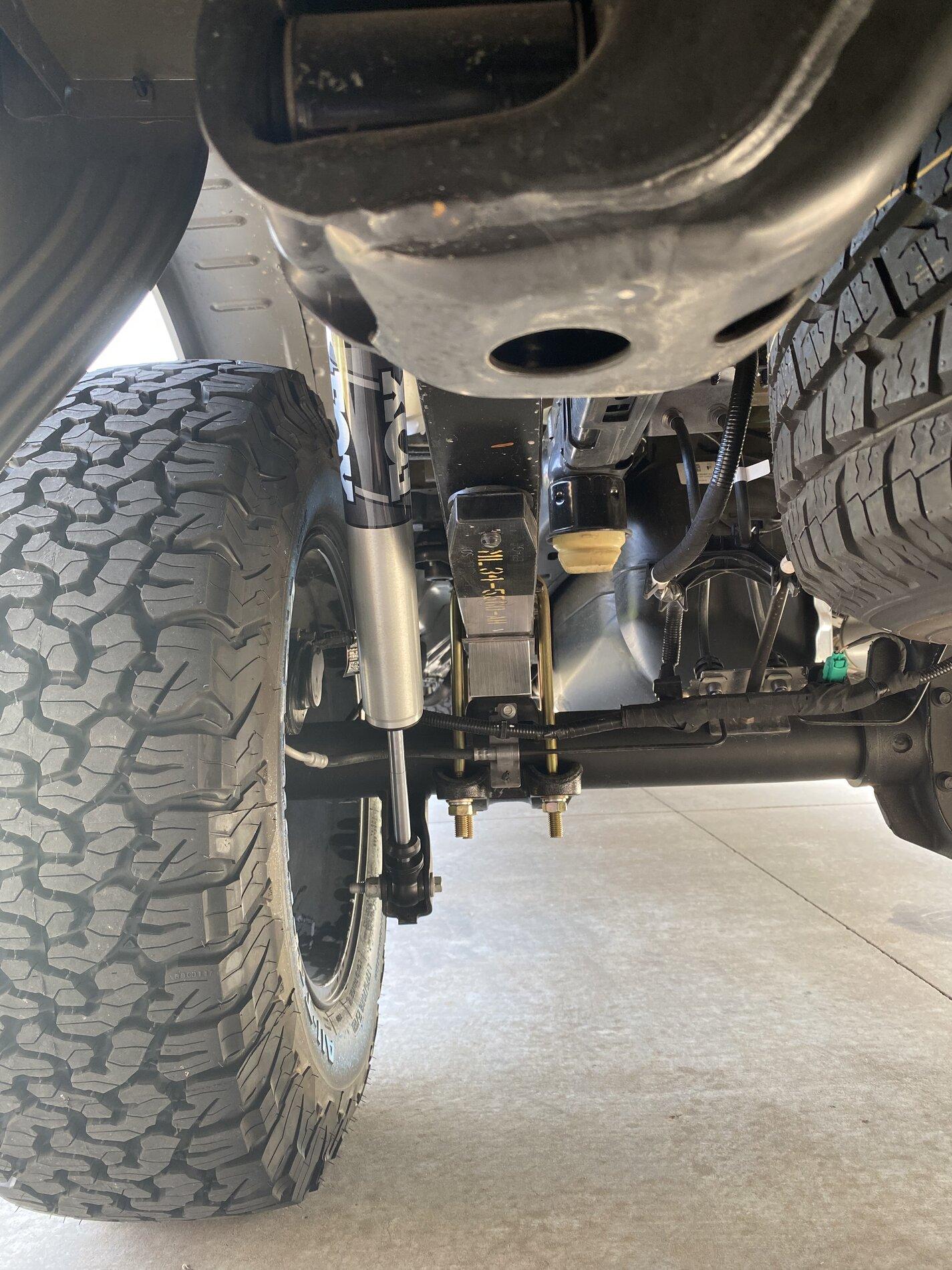

Blocks. Halo makes a nice product, on the expensive side (180.00) but does include new U bolts for the 21 changes.

No worries ask away! The problem with that is everyone seems to get different results. Since engines and configurations change everything slightly.
II adjusted it down 5/8 an inch from how it arrived and got roughly 2 inches up front. So if you adjust the pre load even further down you’ll get less lift as you want. I just don’t know how to get one inch exact. And while some have adjusted when it’s installed it’s kind of sketchy since the threads could slip with all that spring tension.
