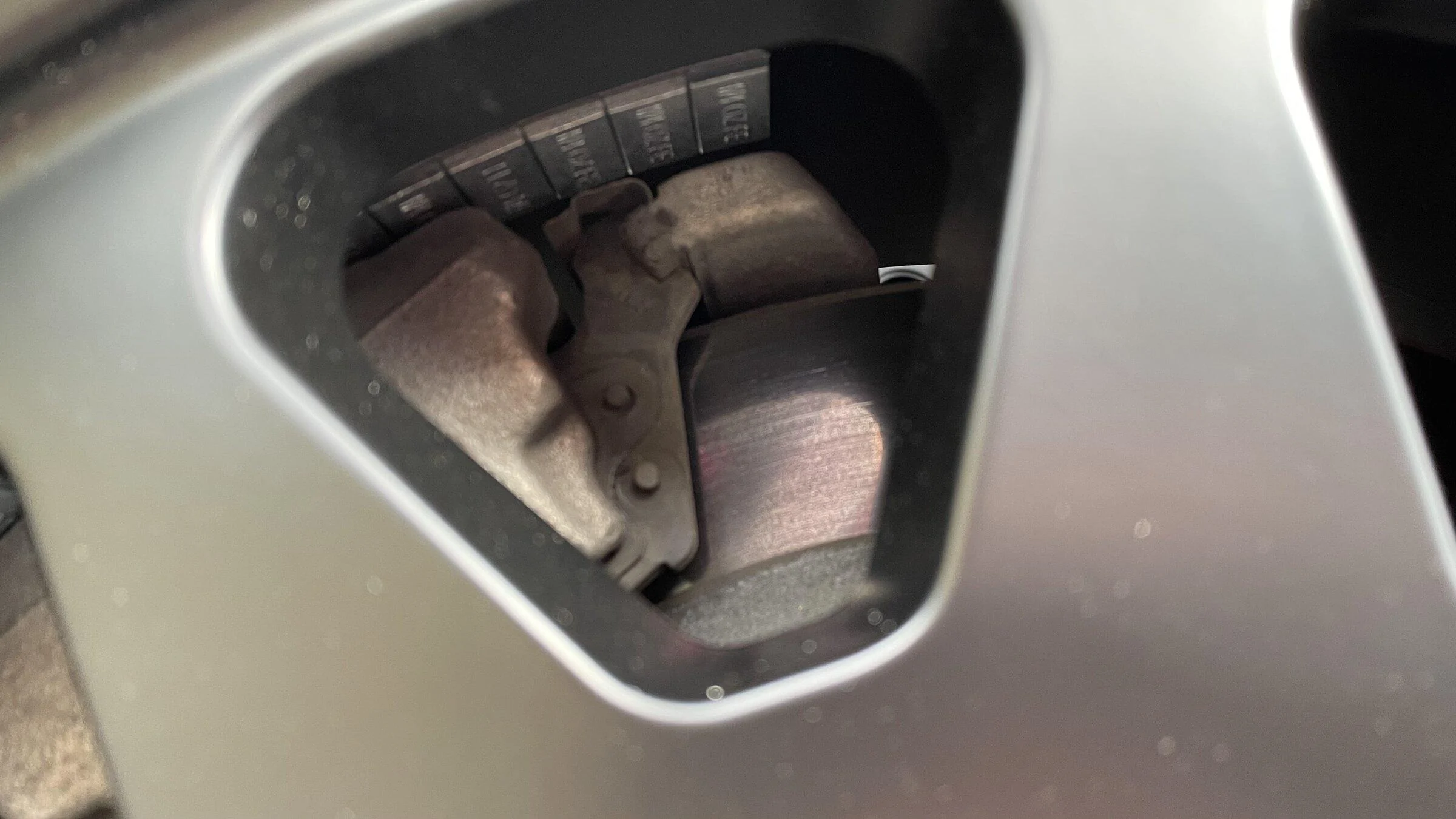

IF YOU ORDERED HD TRAILER TOW PACKAGE 17" RIMS WILL NOT FIT ON THIS TRUCK... IT HITS THE BRAKES. 18" SHOULD WORK.
PLEASE DETAIL IN YOUR THREADS IF YOUR TRUCK HAS TRAILER TOWING OR NOT WHEN TALKING ABOUT WHEELS THAT FIT. A COUPLE PEOPLE HAVE ALREADY BOUGHT 17" AND CAN'T RETURN THEM

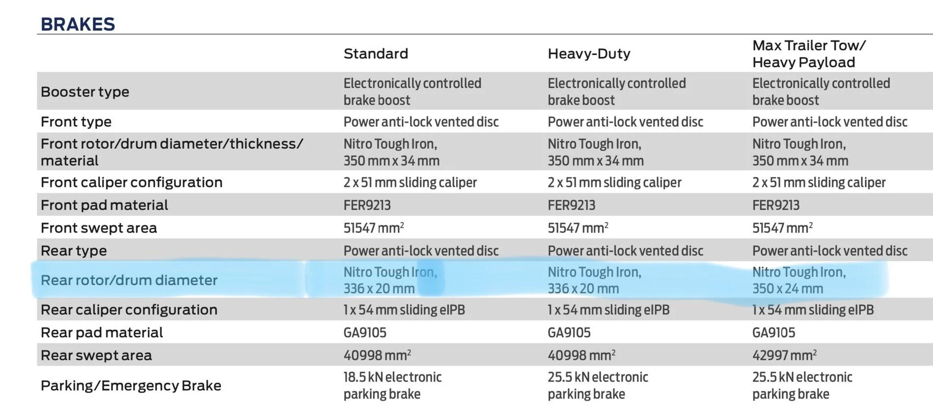

The Max Trailer Tow package gives you slightly larger diameter rear disc brakes, 13.8”X.95” on Max Tow versus 13.2”X.8” for standard trucks.
Hence why 17” wheels will not fit. The other tow packages (Tow Technology or Trailer Tow Package) have standard size brakes, so it’s a non issue.
This is straight from the 2021 Ford F-150 Technical Specifications;

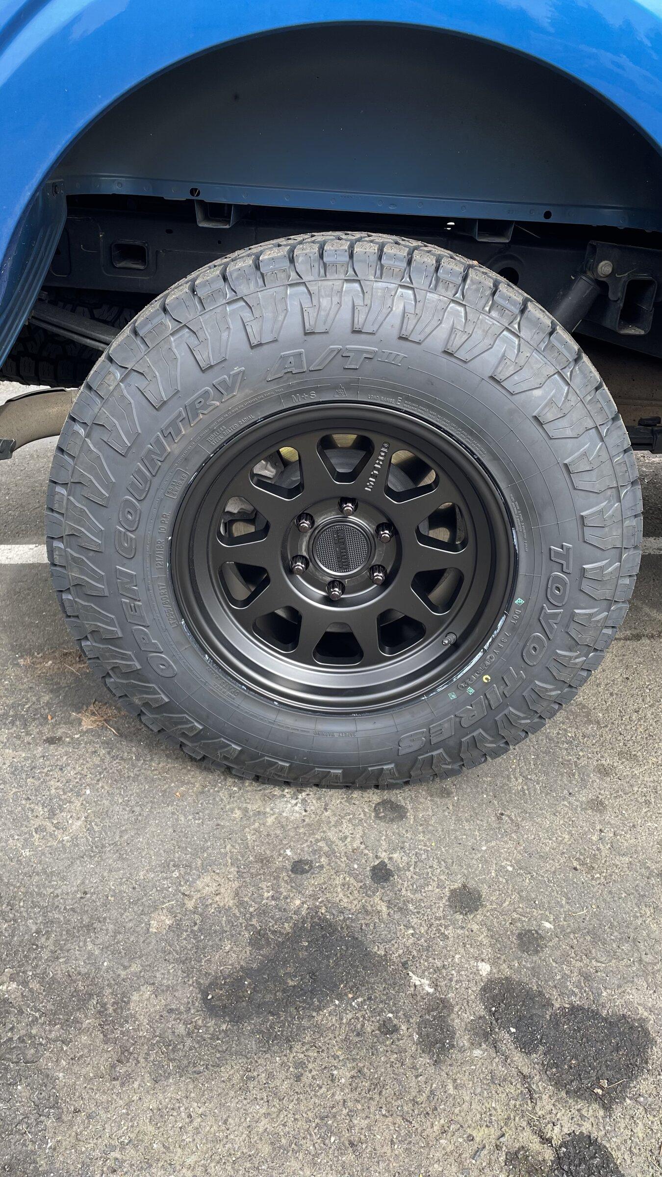

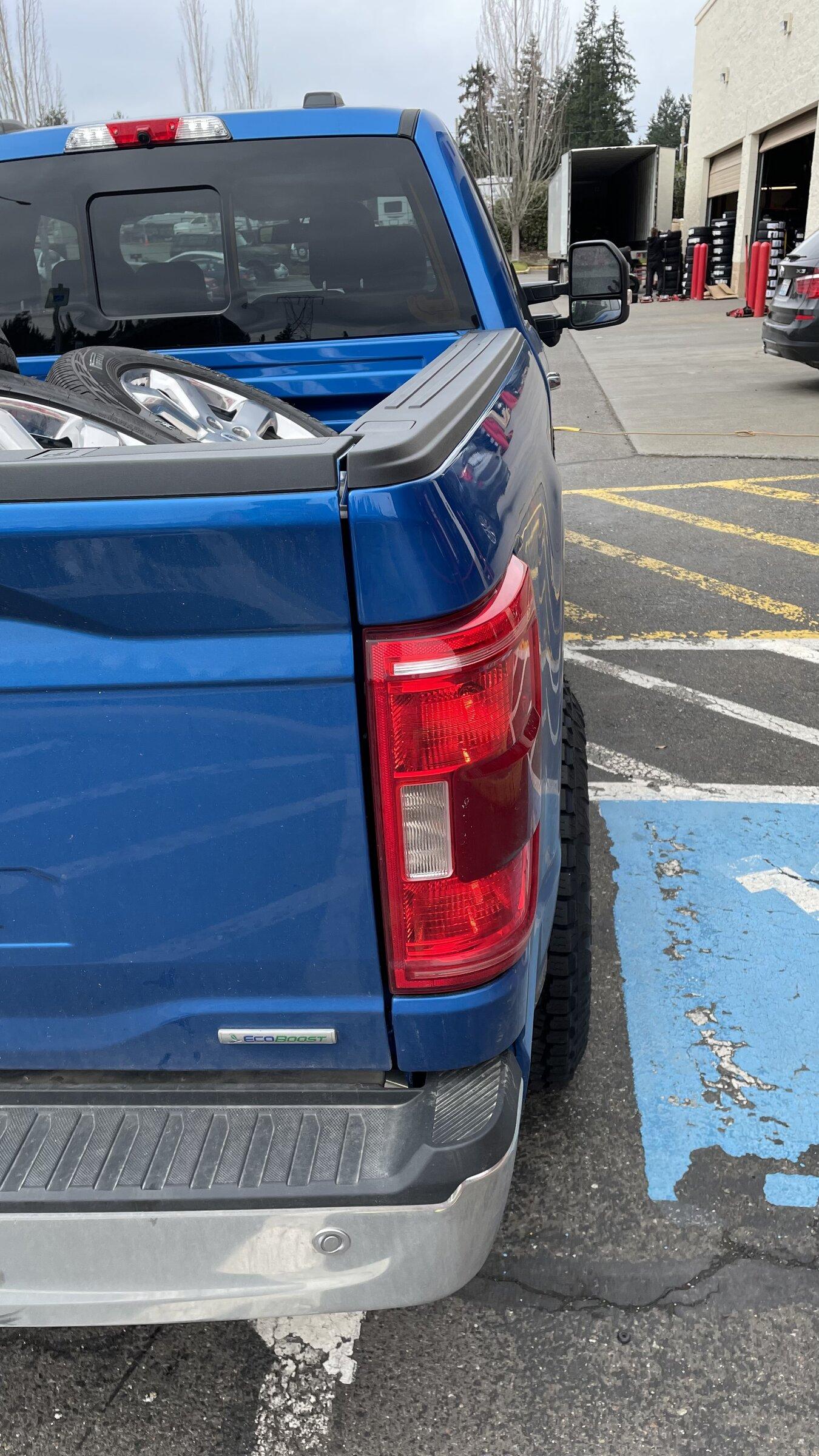

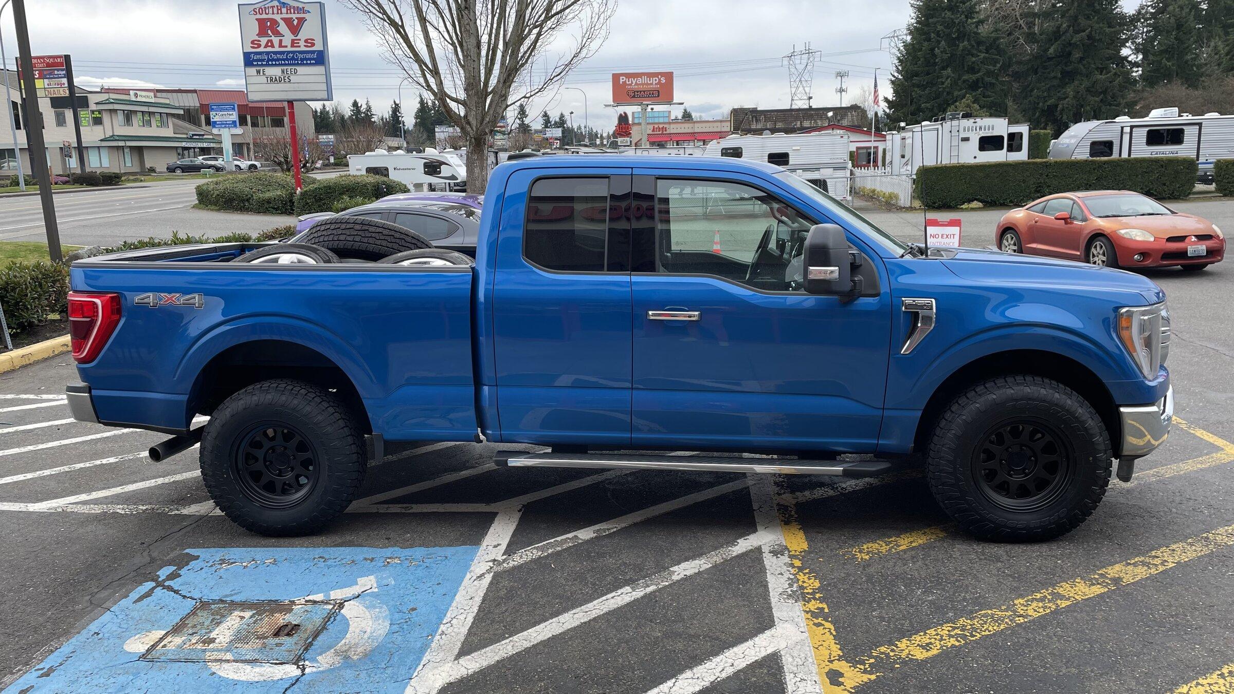

Can confirm that Method 316 17” wheels with a 0mm offset fit over the larger 350mm rear rotors that come on the 2021 Max Tow package. Care needs to be taken with placement of balancing weights, but they do fit!
