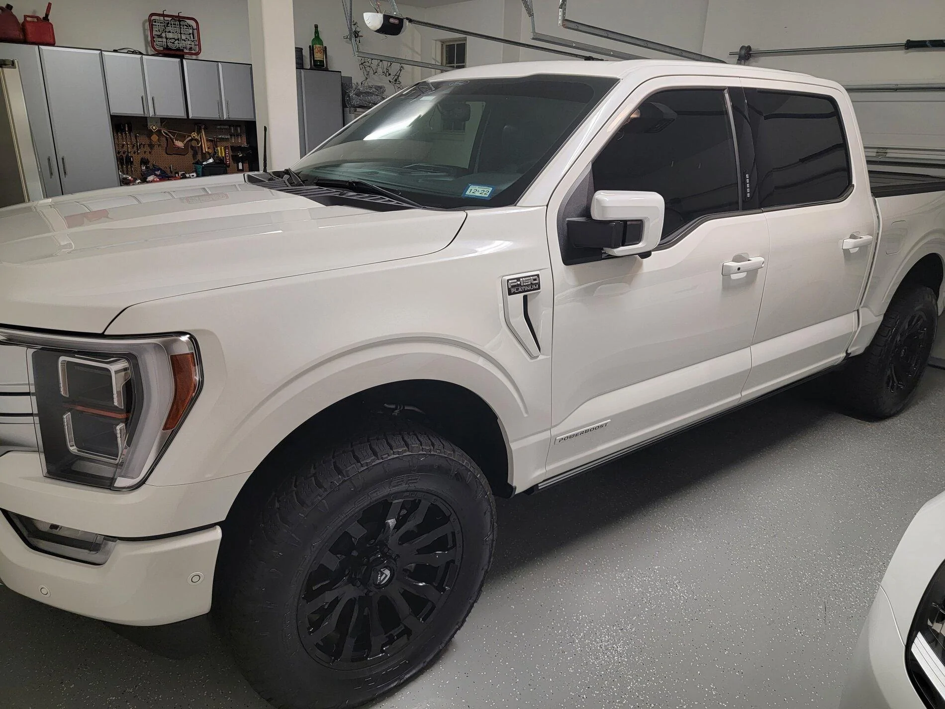

Im looking at getting the Venom 601 wheels with Nitto Ridge Grappler tires for my new Platinum. Im going to be putting a 2" level kit on the front and wondering what the largest tire I can fit without having to do any modifications. No rubbing or cutting anything to make it work.
Appreciate any help!

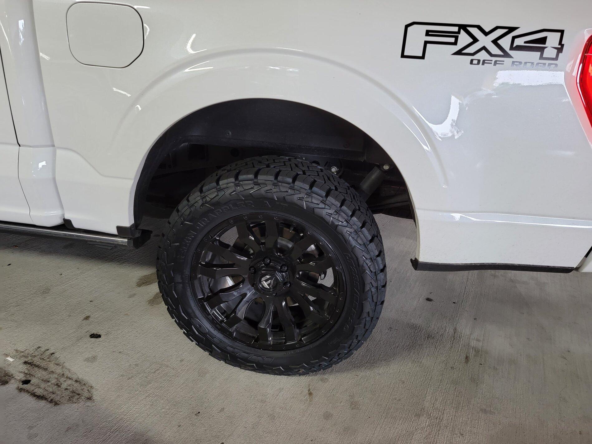

I put 295/60/20 on fuel blitz 20 offsets on had slight rub on lower air dam driverside when turning. It could easily be trimed. I end changing tire to the new nitto recon 385 55 20 and rides better getting better fuel mileage as well.
Ford F-150 Lightning New wheels and tires help... 20210517_000641
Wrong photo that's the 295 60 20 G2 nittos.

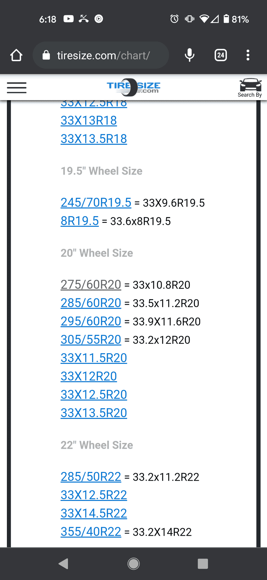

You didn't mention what size wheel you'll be buying, so it's hard to recommend a tire size.
I had 275/60R20s on my truck from the factory, which had an outside diameter of around 32.8 inches. I switched to a 17 inch wheel with a +25 offset (compared to factory +44) and 33x12.5R17 tires and have no rubbing. The 33x12.5 tire I selected is also 32.8 inches. I don't have a lift or level.
So with a two inch lift/level, you should comfortably fit any tire with an outside diameter of 33 inches. Go to https://tiresize.com/chart/ and scroll down to tire size by diameter, select 33", and then check the different wheel sizes for a variety of tire sizes that equate to 33 inches.
Ford F-150 Lightning New wheels and tires help... Screenshot_20210625-181805
It's up to someone else to say whether a 34 or 35 inch tire would fit.
