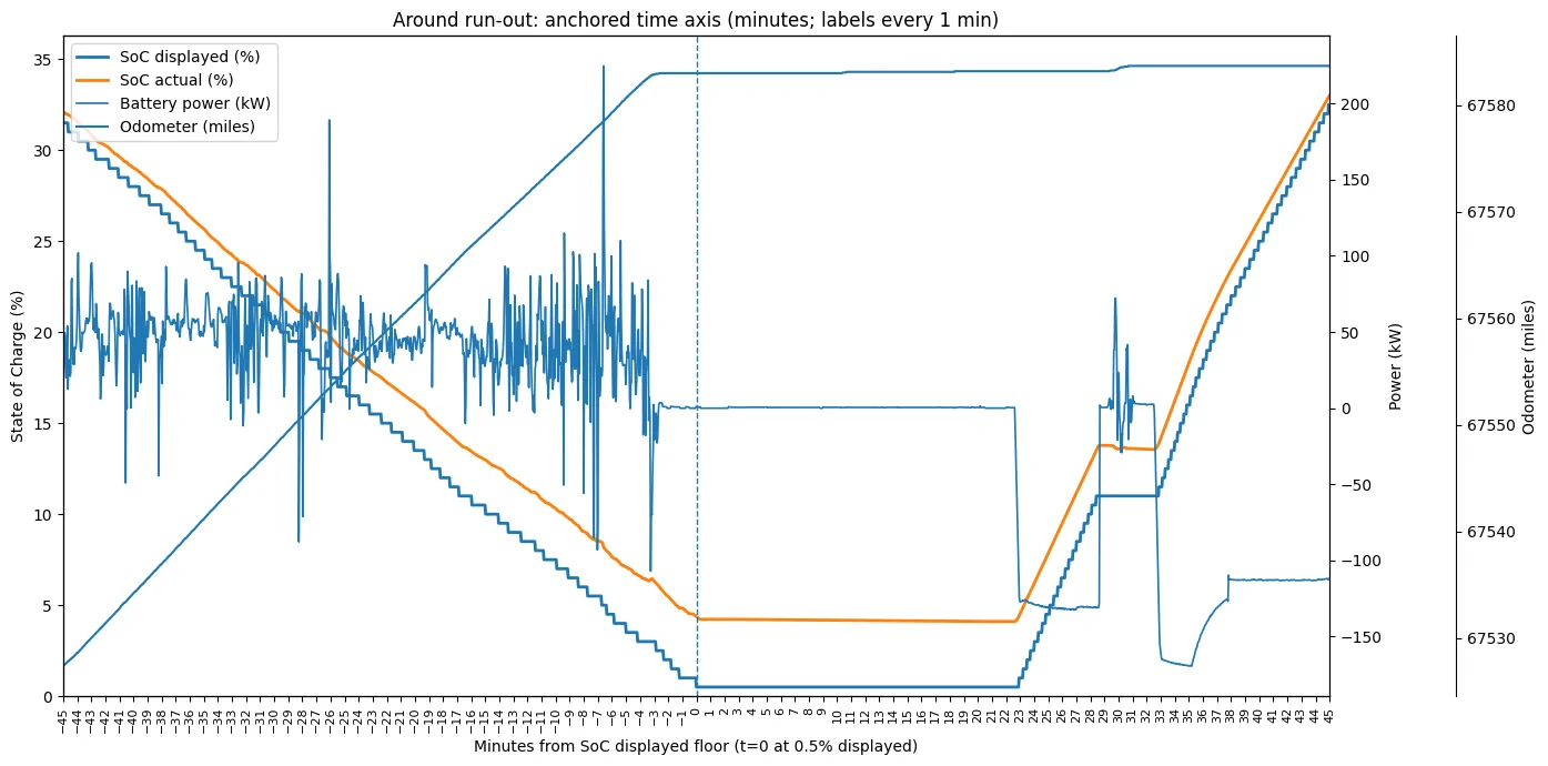

I was supposed to end at charger with 2%, pushing it i know. It got low because I sped up for a bit. At 2% it rapidly dropped to 0 and died. No real loss of power first. My other evs had about 10 to 15 miles in reserve, appearantly this has none. Had I known I could have stopped earlier. It probably won't ever happen again but this is an issue for me.
