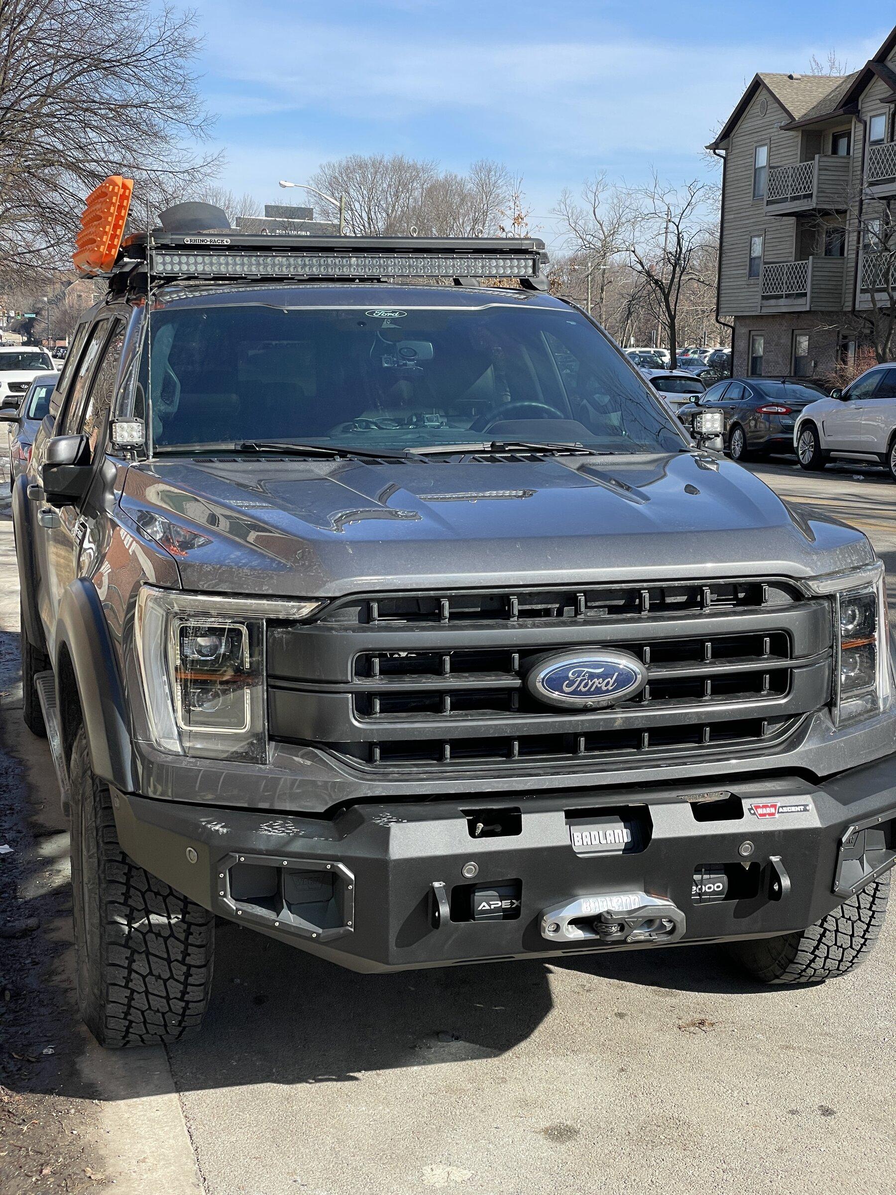

This is a Warn Ascent Series winch bumper with a Badland APEX 12000lbs winch.
If anyone is checking out a winch bumper, I can say that I enjoy those better. Was tempted to go with Fab fours but the version I liked was not available for my year.
Radar works but ACC does not. Camera is partially blocked. Have plans to fabricate a new ACC relocation bracket in the middle as well as camera relocation. No engine light other than a notification on ACC will not work. The actuator of the lower fin for the intercooler needed be disconnected but is left open so remains functional.
Will update more in few months about that project if it works out.

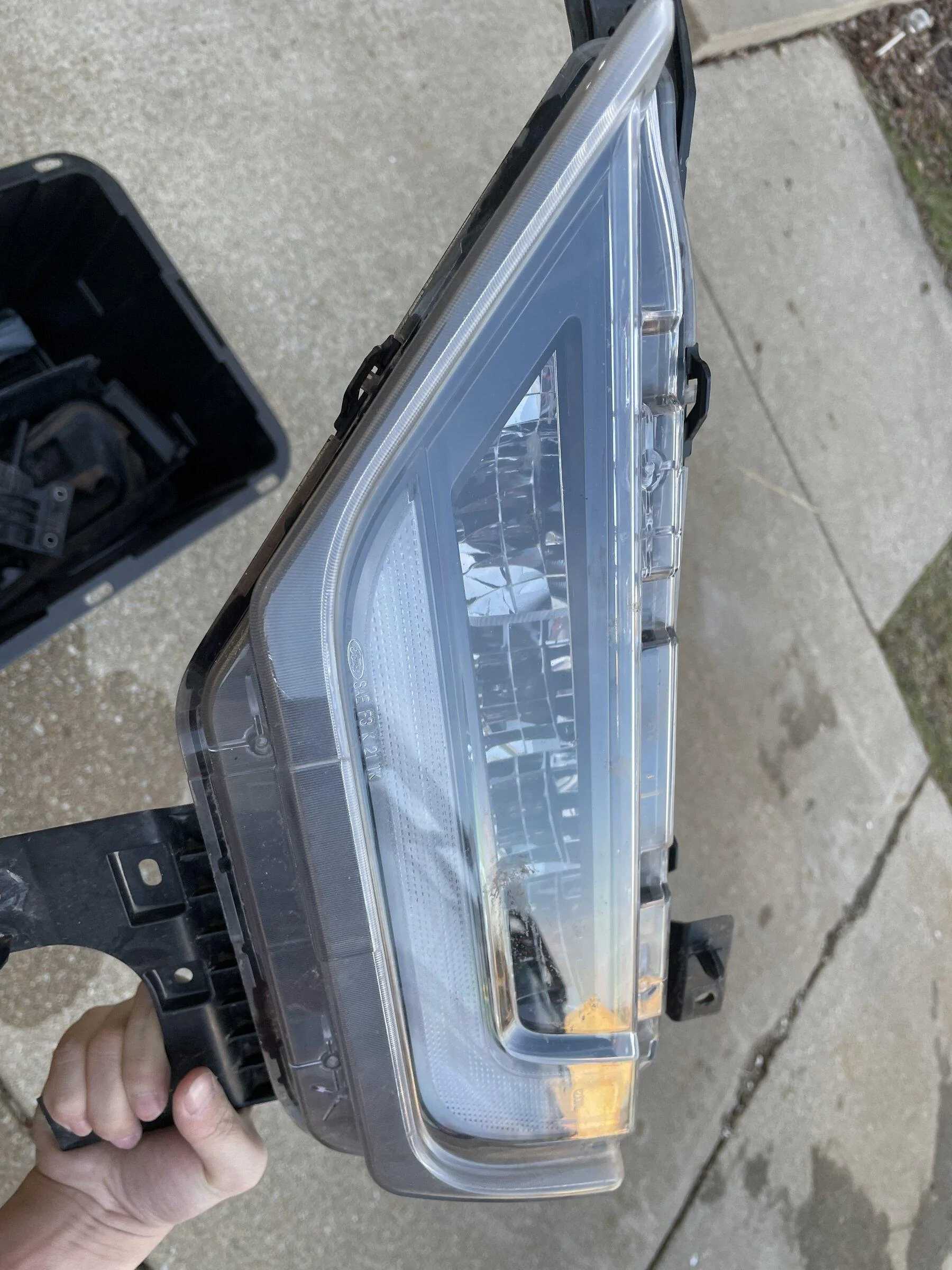

Lastly, I am selling those fog light / DRL units, they are LED for Lariat Trim with auto headlamp level.
