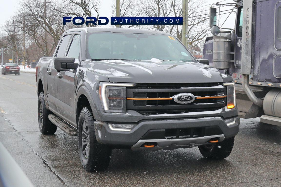

Also, we’re you planning on powder coating the skid plate black or try to find that silver piece above the tow hooks? It appears that is separate from the skid plate AND it has the three ridges that perfectly line up. Mine like yours is smooth, doesn’t have the ridges to line up with the tremor plate. Was going to see if I could somehow just buy that silver piece as well?
You might need the silver piece from above the towhooks as well, which I *think* is connected to the black piece above it (the two side bits around that vent.)
It may mount up w/o it but just leave a few airgaps but I'd rather have the seamless look. No way to really tell until the parts are available.
And they are not going to be cheap. I expect that skid plate and trim piece (and the two brackets) to easily set a fella back 1,200-1,500 unless tasca works some magic.
edit: I also pointed out a few posts above that you'll probably need the Tremor's "airdam" trim bits as well around the sides of the skid plate, but I'm betting you can trim up your existing one further (like mine) to make it all fit together.
