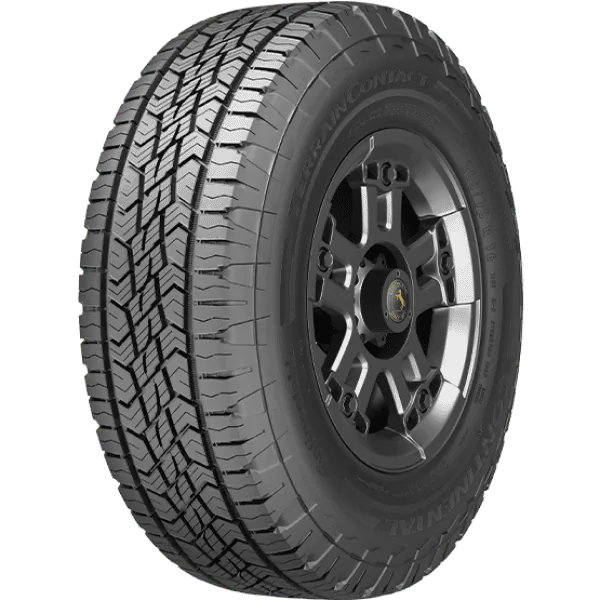

I understand getting a larger tire to fill up the wheel well but I'm not sure I would go and get a super aggressive tire only having 2WD. I have the FX4 Lariat and mine came with 33"s. Im sure they would fit fine. I'd probably go with a Continental Terrain Contact A/T which isnt quite as aggressive and provides an excellent ride and fuel economy but maintains some aspects of an A/T over H/T type tire. Nice thing about a tamer tire is it's harder to get real stuck and easier to get unstuck. I've got the Continentals on my 4runner and I've only got good things to say about them right now. They replaced Wildpeak AT3Ws because of road noise. I run Nitto Ridge Grapplers on my work truck and they're ok. They look great but don't grip as much as I thought they would.

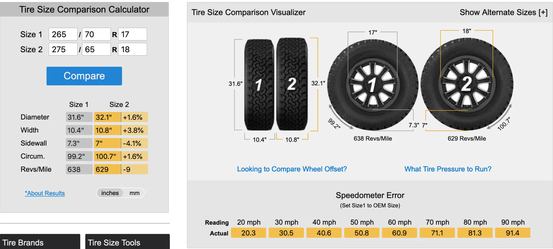

I would def. move up in size just to make it look a bit fuller but how much larger is based on you're opinion. You trade size for minor things like weight and speedometer calibration. Bigger the footprint the more MPGs come off. I use Tire Size Comparison to help make up my mind.
thx I use that site as well...that’s where I came up with the alternate 275-285/60/18 size...I think I’m leaning toward the 275/65/18 size...that definitely takes up more wheel well...but I’m sure I can go bigger but will probably stay a bit conservative

I'm thinking of making a change from stock wheels/tires to slightly larger, as seen in this comparison. I know this is a minor change, but is there a way to recalibrate the speedometer to match the new tires? Is it even necessary in this case?
