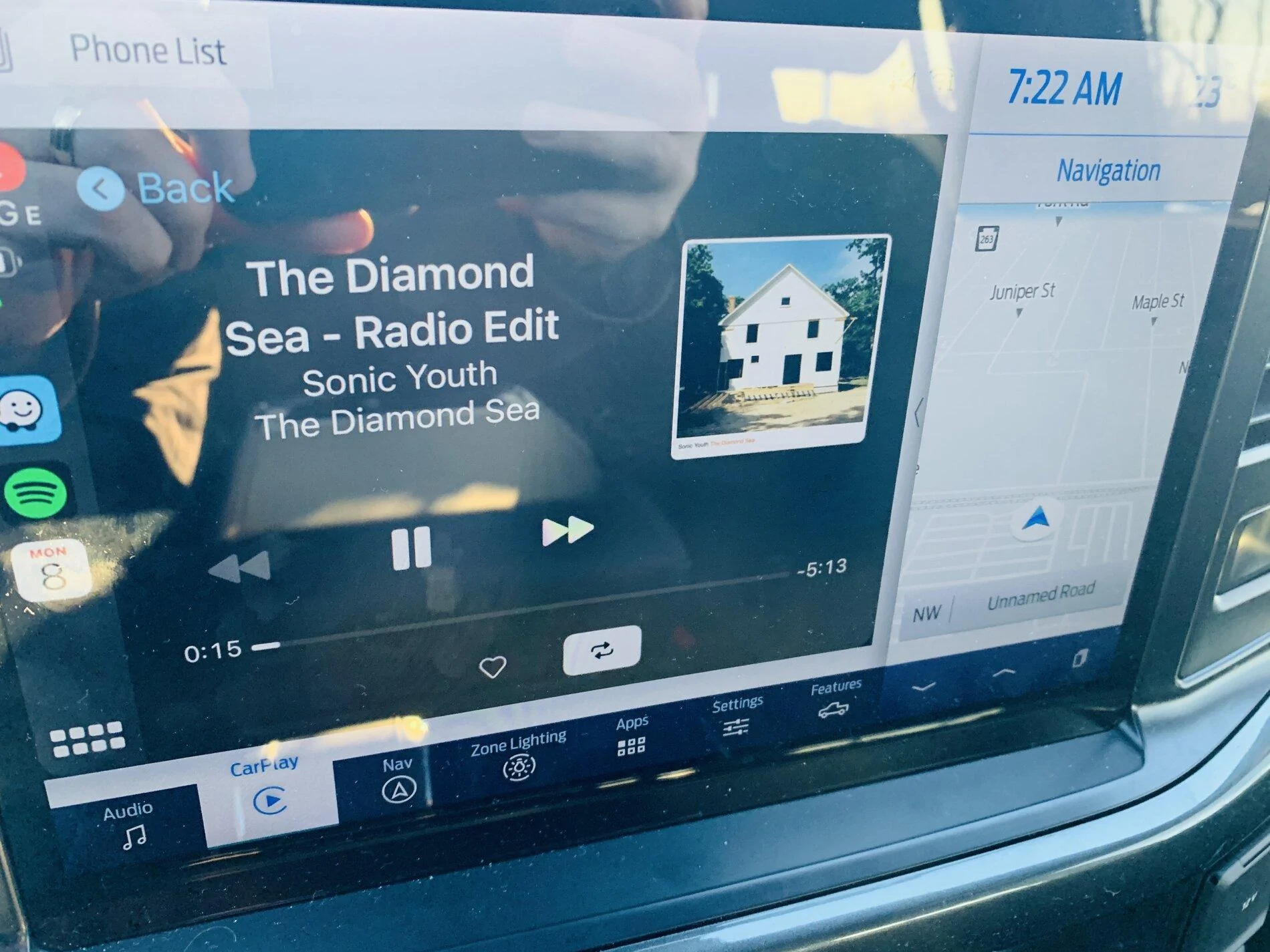

Apple music displaying perfectly in the primary display pane:
Ford F-150 Lightning Sync 4 w/ CarPlay - "No Data Available" IMG_E1215

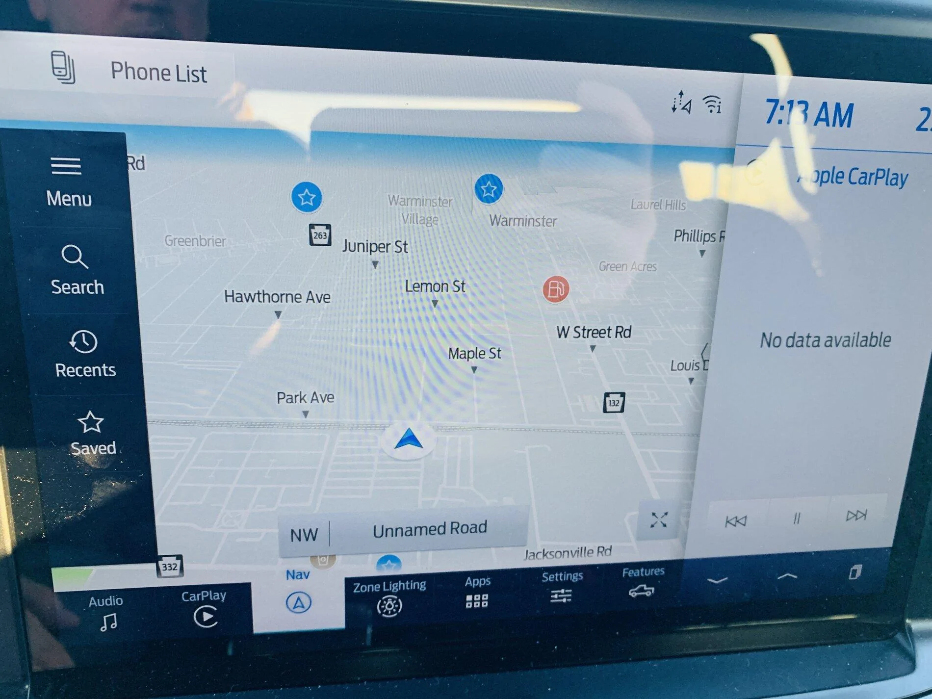

When moved to the secondary side display, Apple music displays "No Data Available". Note: the playback controls DO still work:
Ford F-150 Lightning Sync 4 w/ CarPlay - "No Data Available" IMG_E1216

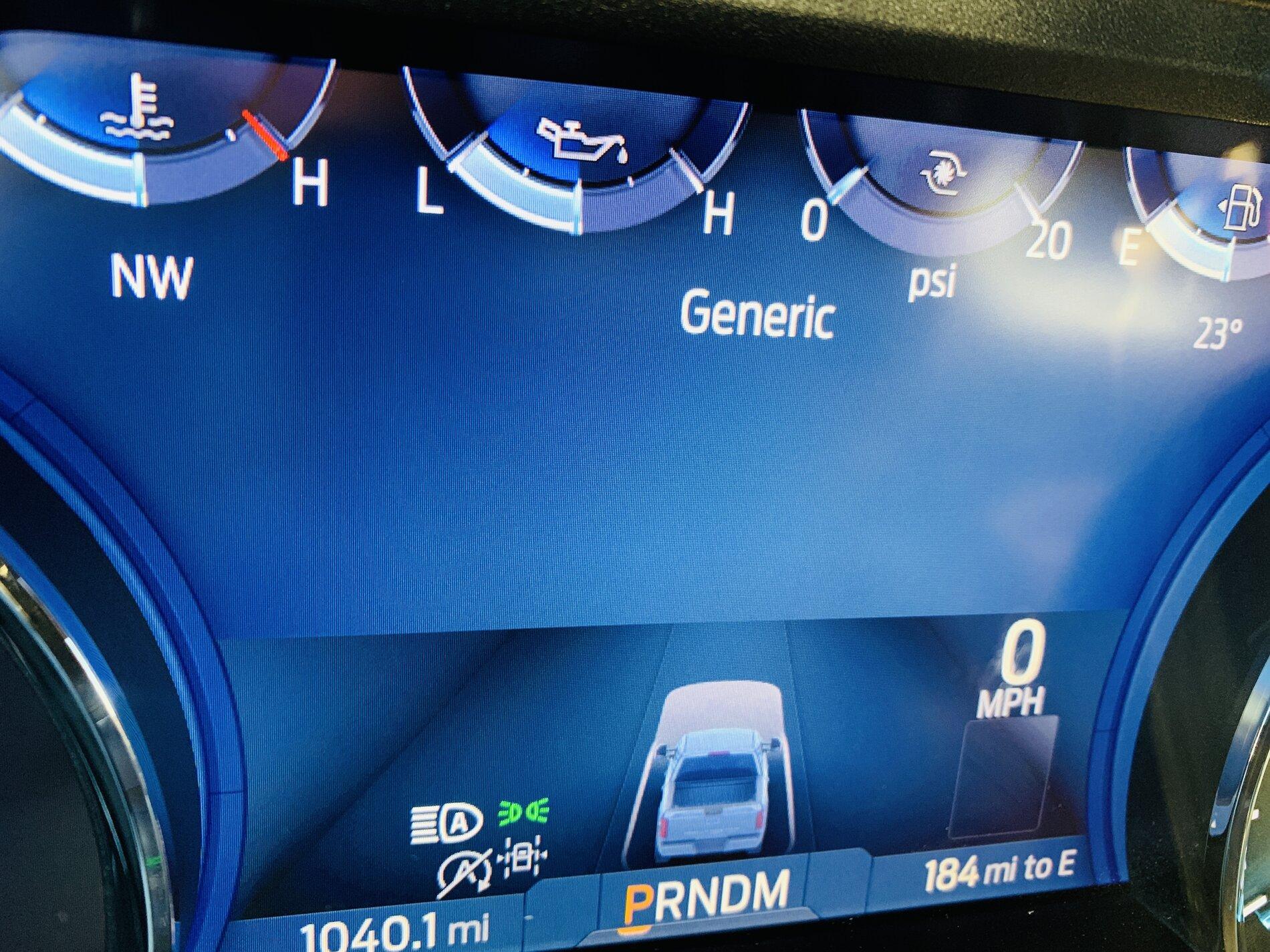

This is what the "Now Playing" screen displays in the dash when the "No Data" problem occurs:
Ford F-150 Lightning Sync 4 w/ CarPlay - "No Data Available" IMG_E1217.JPG

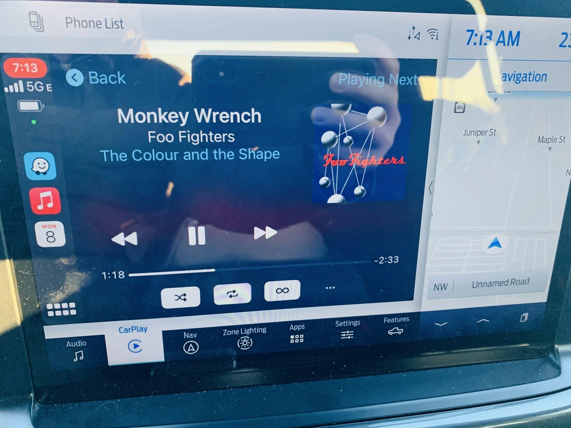

Just for reference, Spotify via CarPlay displayed on the primary screen...
Ford F-150 Lightning Sync 4 w/ CarPlay - "No Data Available" IMG_E1218

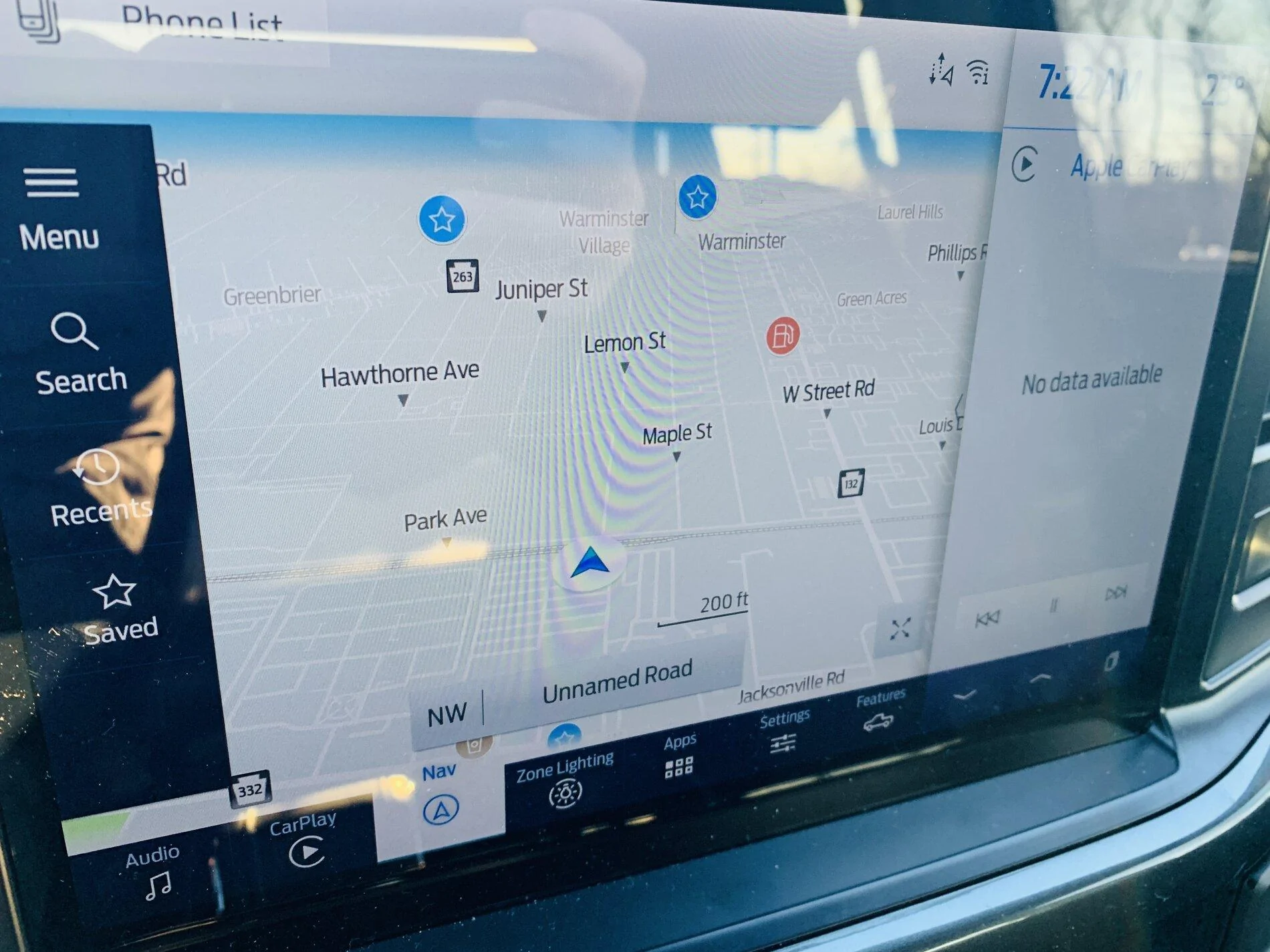

...and Spotify showing the same behavior as all other CarPlay apps when switched to the secondary side screen:
Ford F-150 Lightning Sync 4 w/ CarPlay - "No Data Available" IMG_E1219
