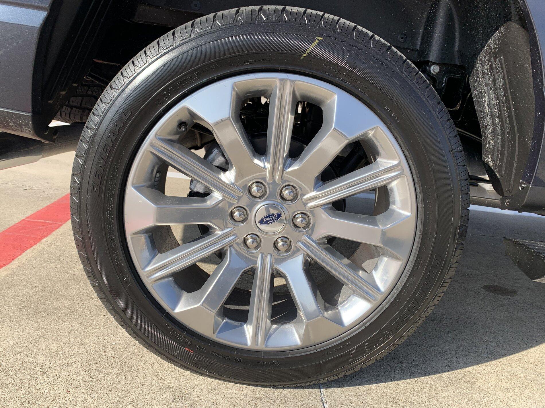

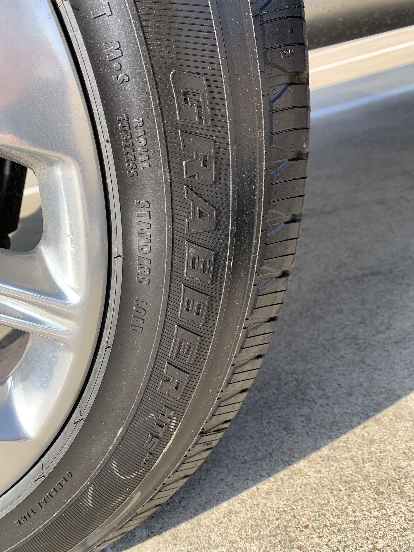

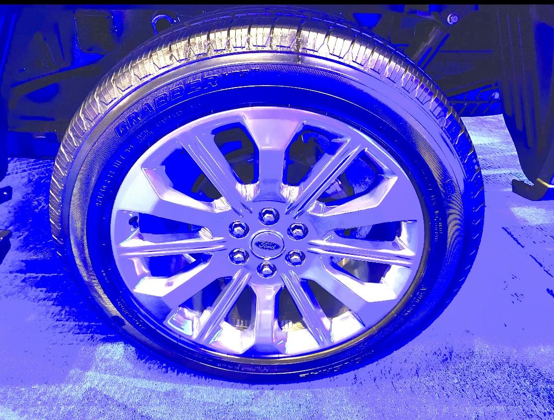

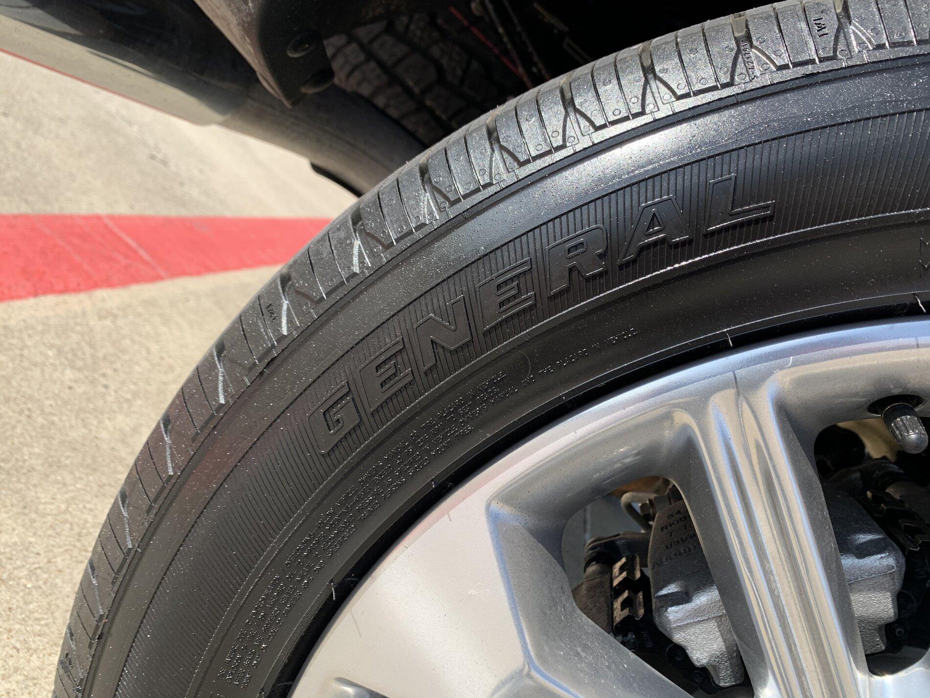

What brand and model tire comes on the Limited?
