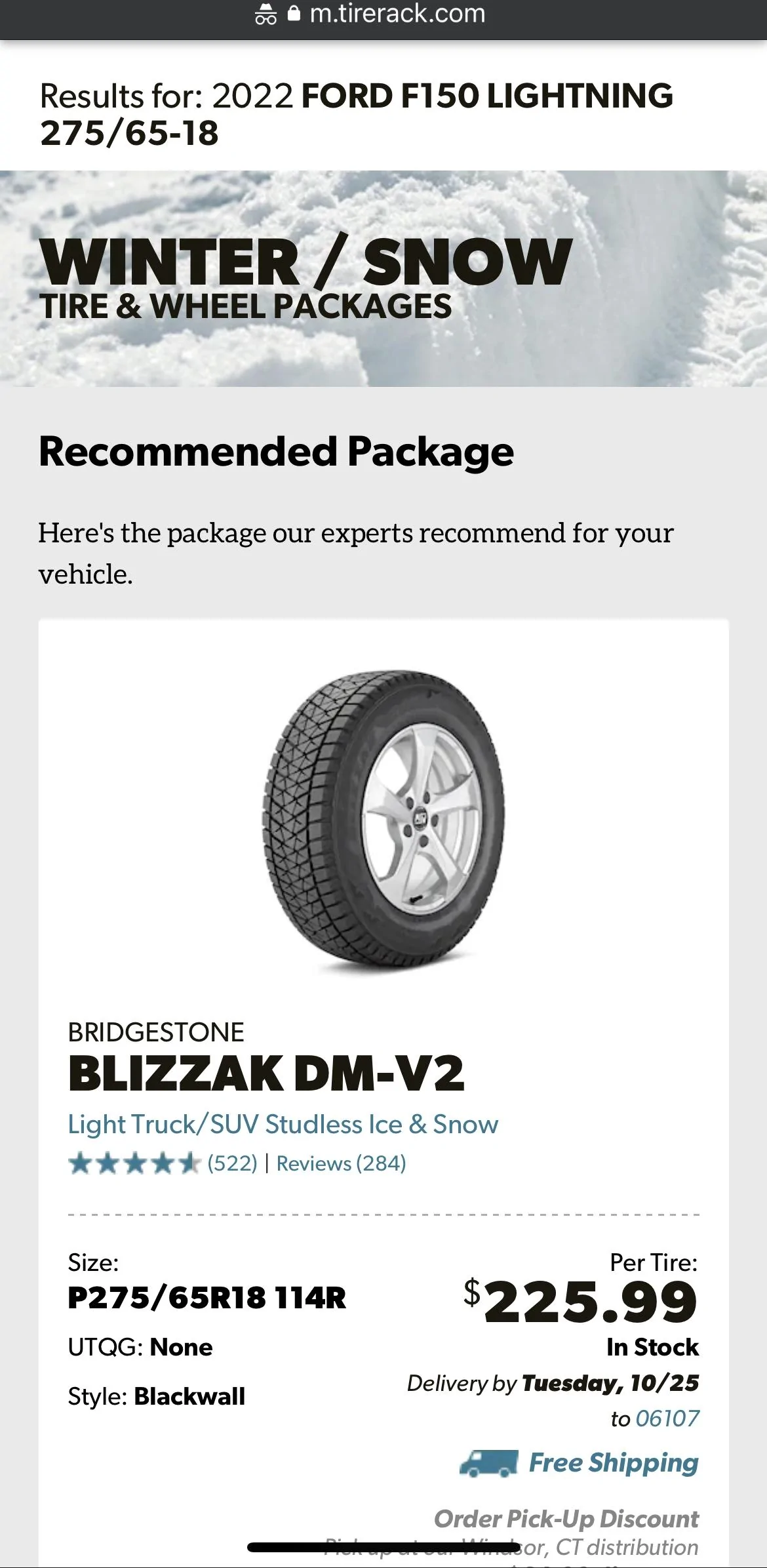

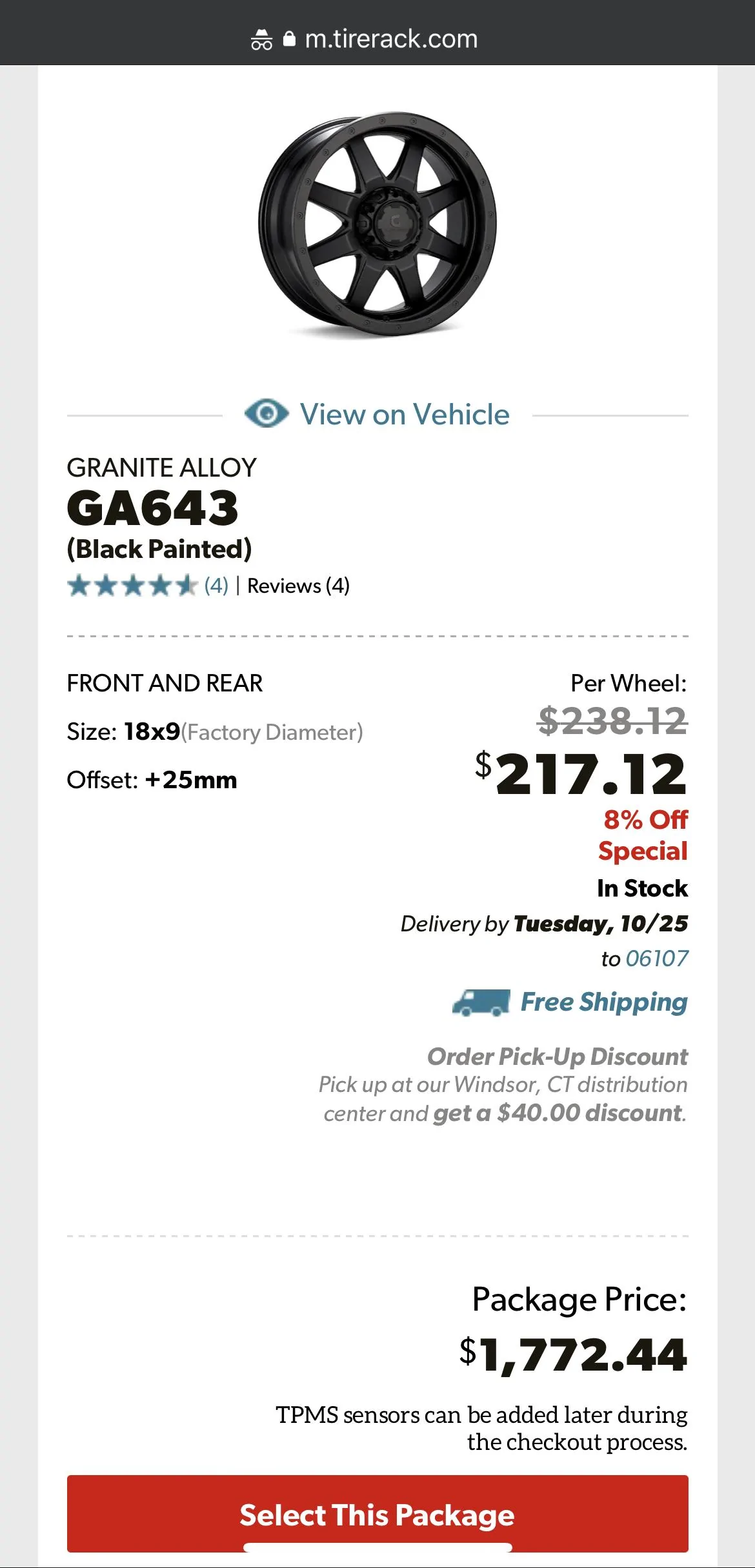

I was hoping for nokian, but This is what tire rack is recommending:
Ford F-150 Lightning Winter Tires and Rims D6727276-624D-4818-B880-B9CE725E8AC7
Ford F-150 Lightning Winter Tires and Rims 251EED9D-BADA-41CB-B5F5-B4243D6E6EE0

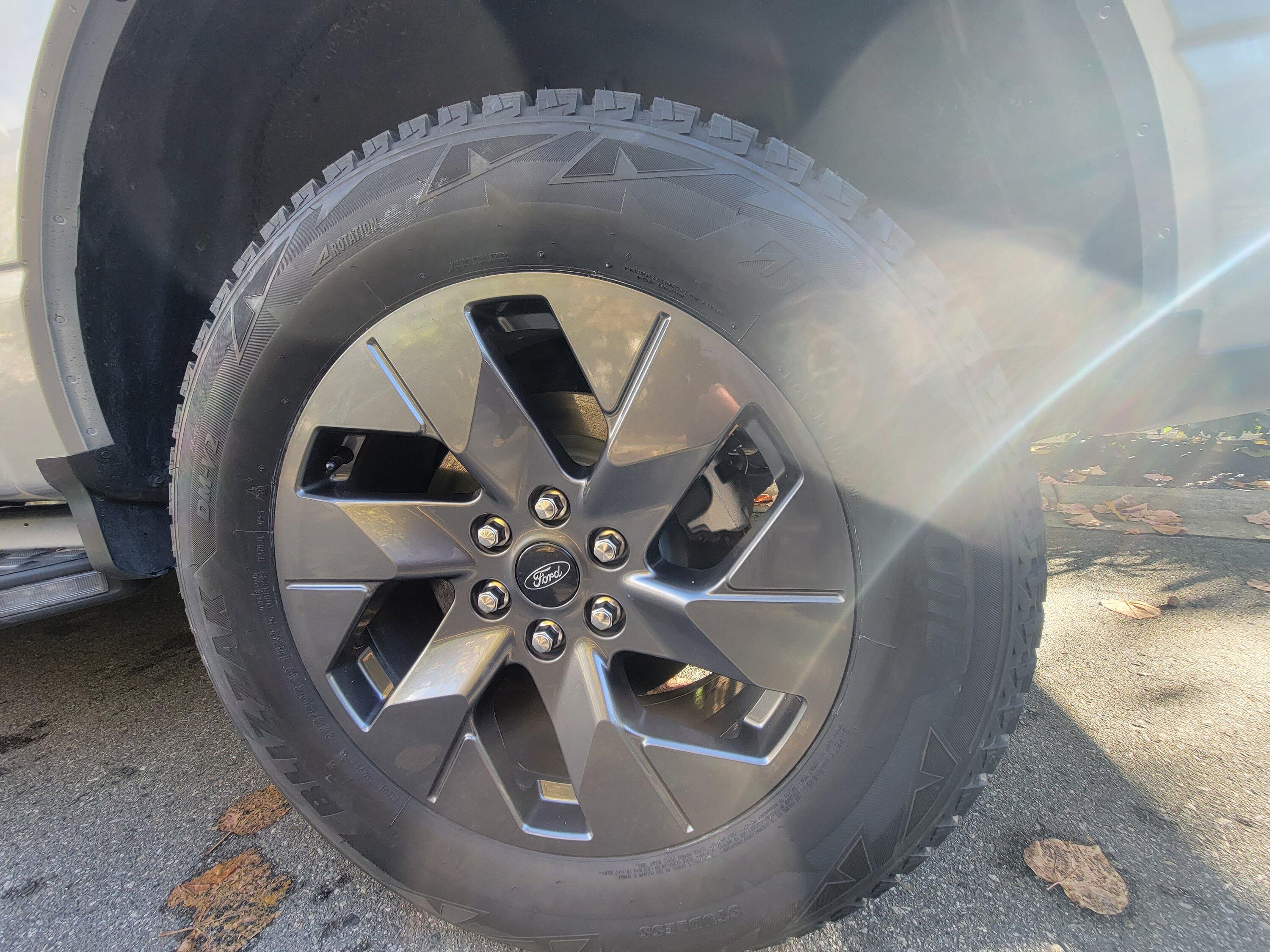

I went with the Blizzak LT265/60R20 LTs. I would have preferred 18s and something narrower, but was having trouble finding wheels I liked that didnt get a warning for possible fit issues. I got them put on last week as i am gone for 2 months and wanted them ready for when i return. Here is a photo of the granite wheels on the truck.
Ford F-150 Lightning Winter Tires and Rims 20221019_065011
