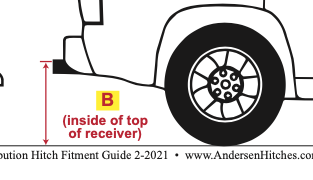

Hello all,
Can anyone who has Max Tow let me know the height from the ground to INSIDE top of the receiver tube? Don't have the truck yet and want to order an Anderson WDH and I need that measurement.
Ford F-150 Lightning 2021 F150 with Max Tow receiver height Screen Shot 2021-06-07 at 5.58.20 PM
Thanks in advance.

Lariat max tow with 20 inch wheels and 3.5 eco. 22 inches

Platinum Powerboost Max Tow = 20" checked after rolling around driveway to 3 different spots because of 2" difference to the post above!

It does seem the PowerBoost sits a bit lower on rear
