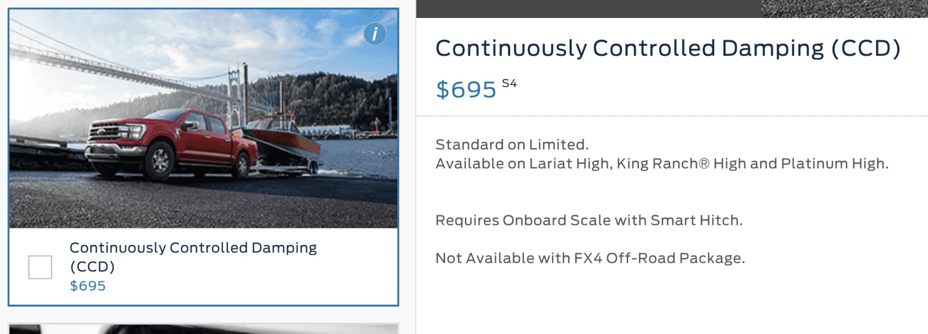

CCD is under "Exterior" options and I don't see it listed on the configurator for the Tremor.
If you go to ford.com to the "build" page, there's a "Compare" button that lists a lot of the standard and optional equipment, but doesn't include things like CCD.
https://shop.ford.com/build/f150/?g...|2021|1|1.|400A.W1E.....TRE.CCAB.RETAIL.SS5.]
As for the Tremor, I find it a mixed bag … upgraded front suspension arms and knuckles, optional Torsen off the Raptor, but it lacks the things I think off-roaders would want (diesel for off-road control and range, or v8 for fun and sound and "fix it with fence wire" simplicity, or hybrid for camping/overlanding.)
