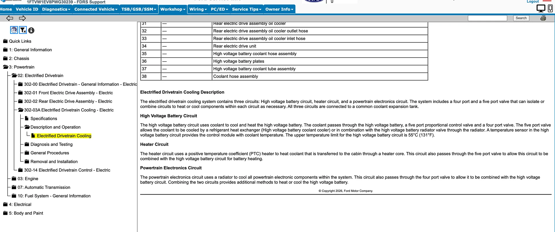

Wow. Tons of useful PTS has tons of useful info.
I found what's labeled workshop within PTS and it has drop downs which definitely shows part is for powertrain cooling.
Ford F-150 Lightning 2022 & 2023 Lightning Powertrain Thermal Management System Pictorial imagen2 (1)
Ford F-150 Lightning 2022 & 2023 Lightning Powertrain Thermal Management System Pictorial Screenshot 2026-02-14 at 2.43.17 AM
I think this is the whole thing (attached)
