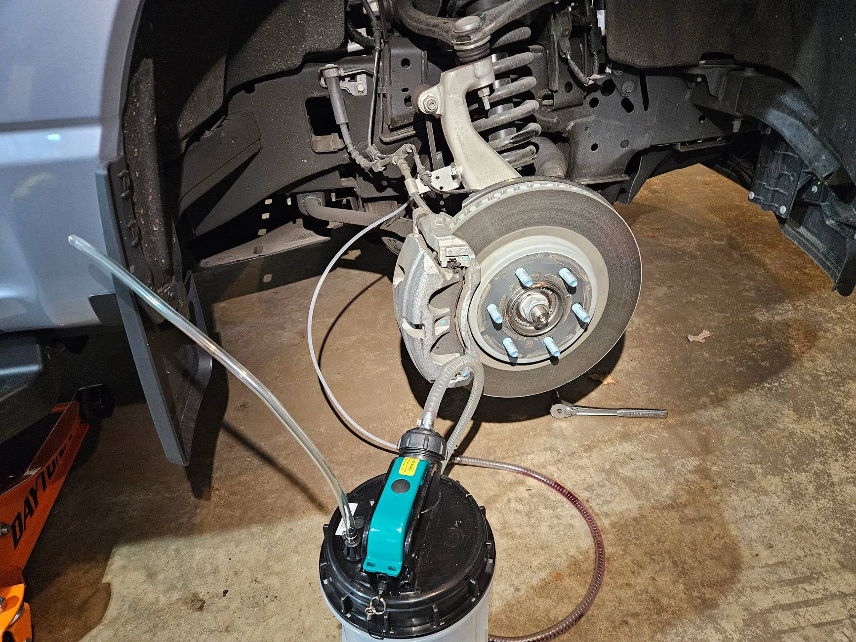

I have drained and filled my own drive unit fluid. I did it at about 10K miles. Even though the service interval doesn't call for service until 150K, whenever gears are breaking in, there will always be some degree of wear material imparted into the fluid, so just to be prudent, I checked the service manual for the spec (just a standard ULV transmission fluid) and used a fluid extraction pump to remove the old fluid (since after inspecting the fluid, I had no doubts that the filters and filter screens were probably barely contaminated. I then filled with fresh ULV fluid up to proper lefel (up to the fill port).
Super straightforward and now I feel 100% confident in running it all the way to 100K+.

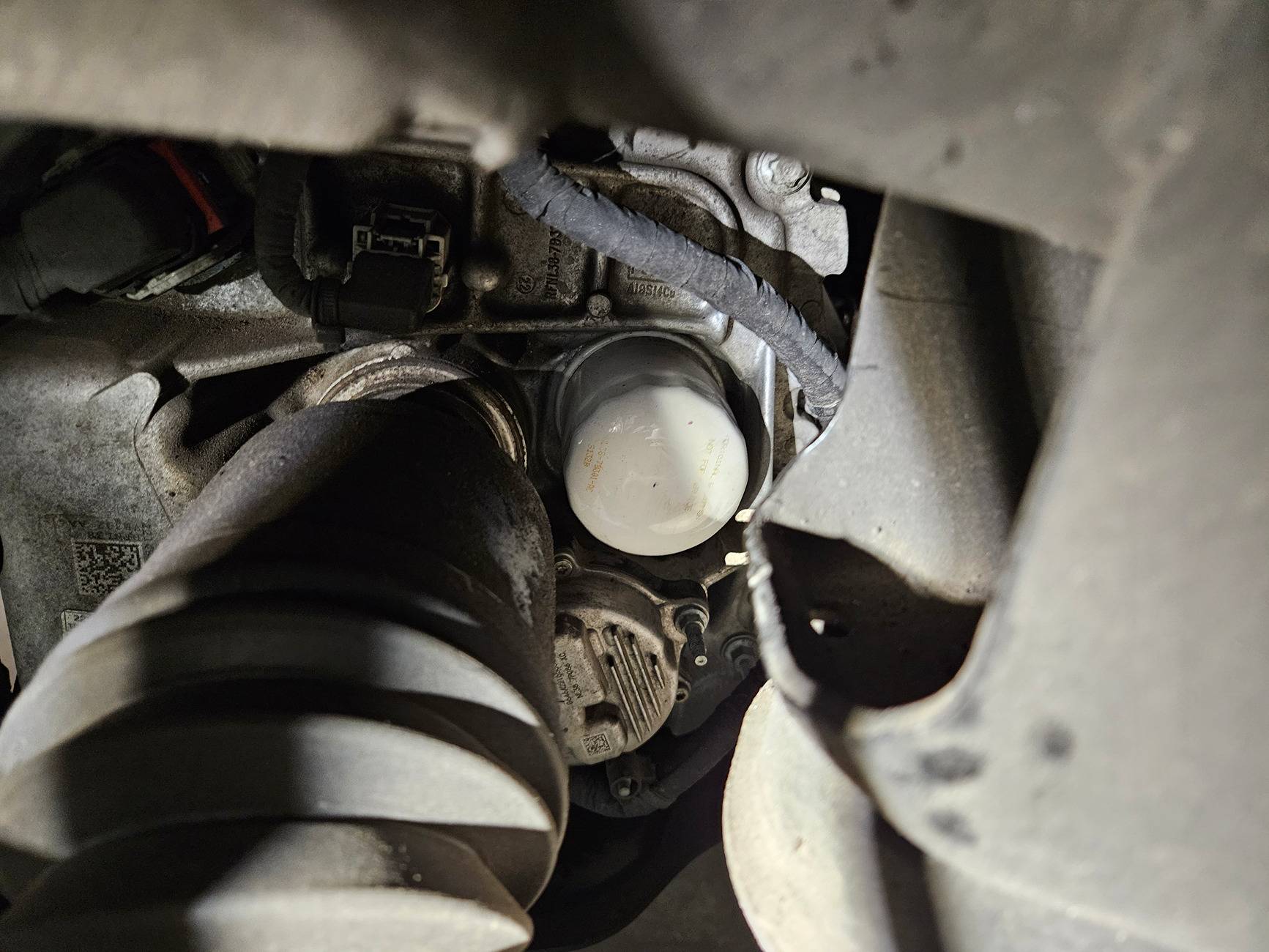

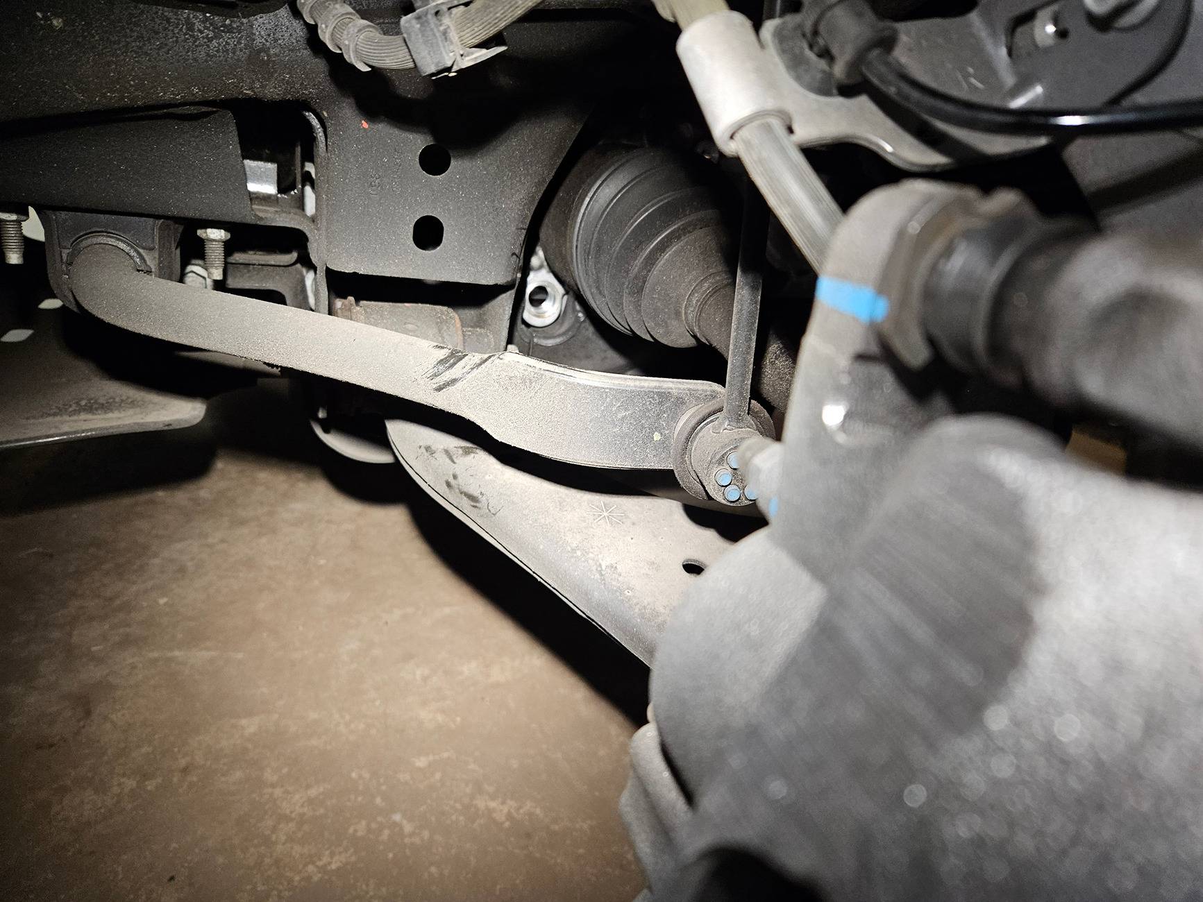

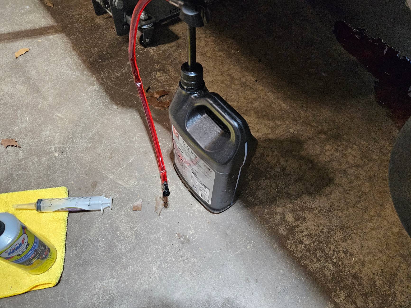

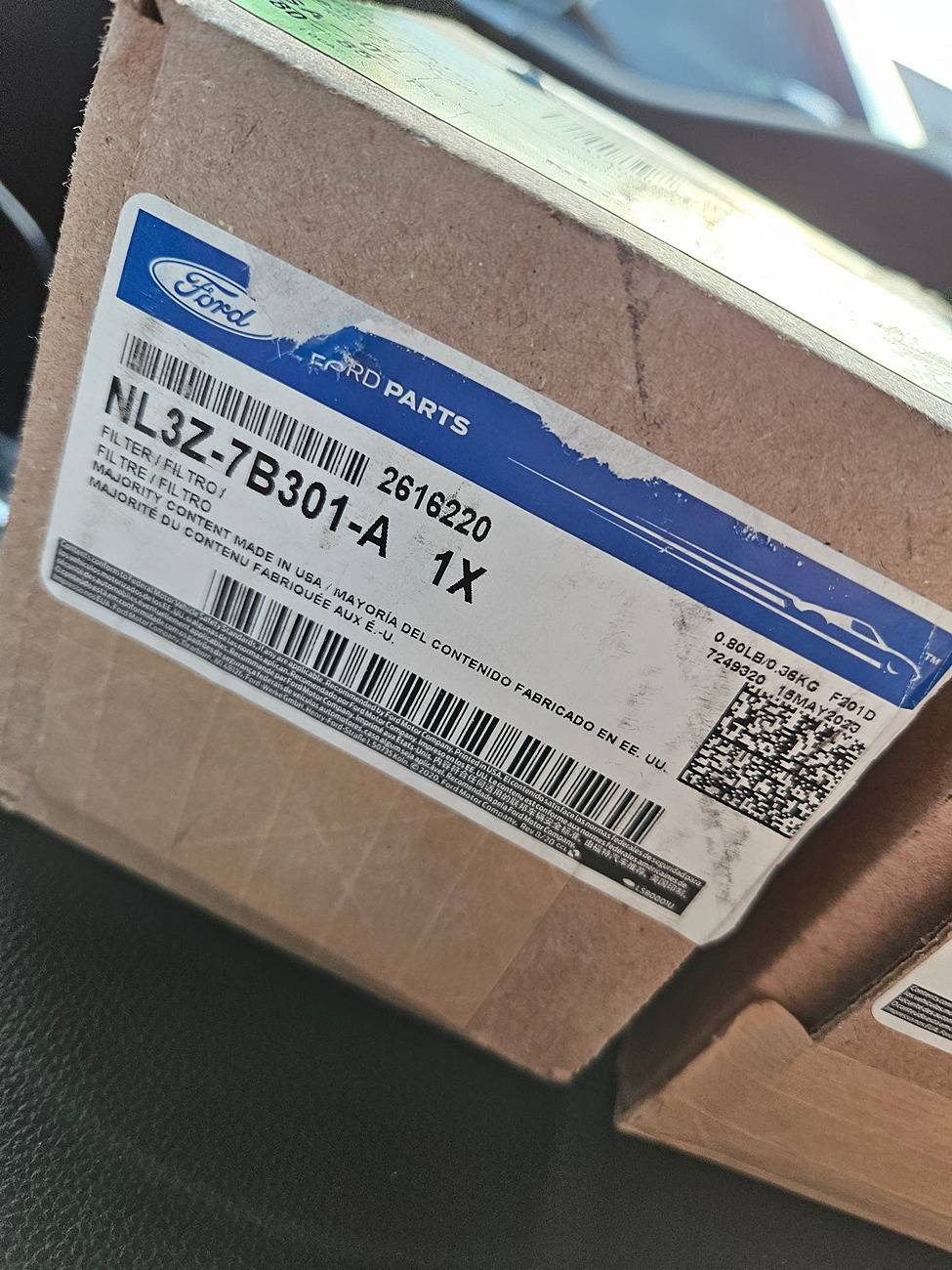

I don't have my shop manual PDF readily accessible right now for detailed diagrams, but I can leave you with some of the pictures I took while doing the service. I've also included a picture of the box of one of the screw on filters so you can see the part number. (both motors use the same filter)
The rear motor fill plug is on the driver's side and the front motor's fill plug is on the passenger side. The screw on filter for each motor is located on the opposite side of the fill plug. There is also an additional filter screen inside the gearbox housing, but there is no reason to remove that for service for a LONG time as unless there extremely large particles (ie potential gear damage), all the wear material should be caught in the screw on filters.

Yeah it was mostly still reddish pink, but definitely darker than new fluid. I did both front and rear units. I don't remember how much fluid I extracted, but I think it was most but not all of it.
I skipped the external filter change, but will do it the next time I do a fluid exchange, probably at around 30-35K miles. I'm at around 22k now. Since I do a lot of towing, I see no real downside besides fluid cost to doing short intervals.
