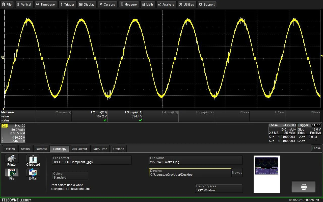

I ran some rough tests on my ProPower today. Results were less than desirable.

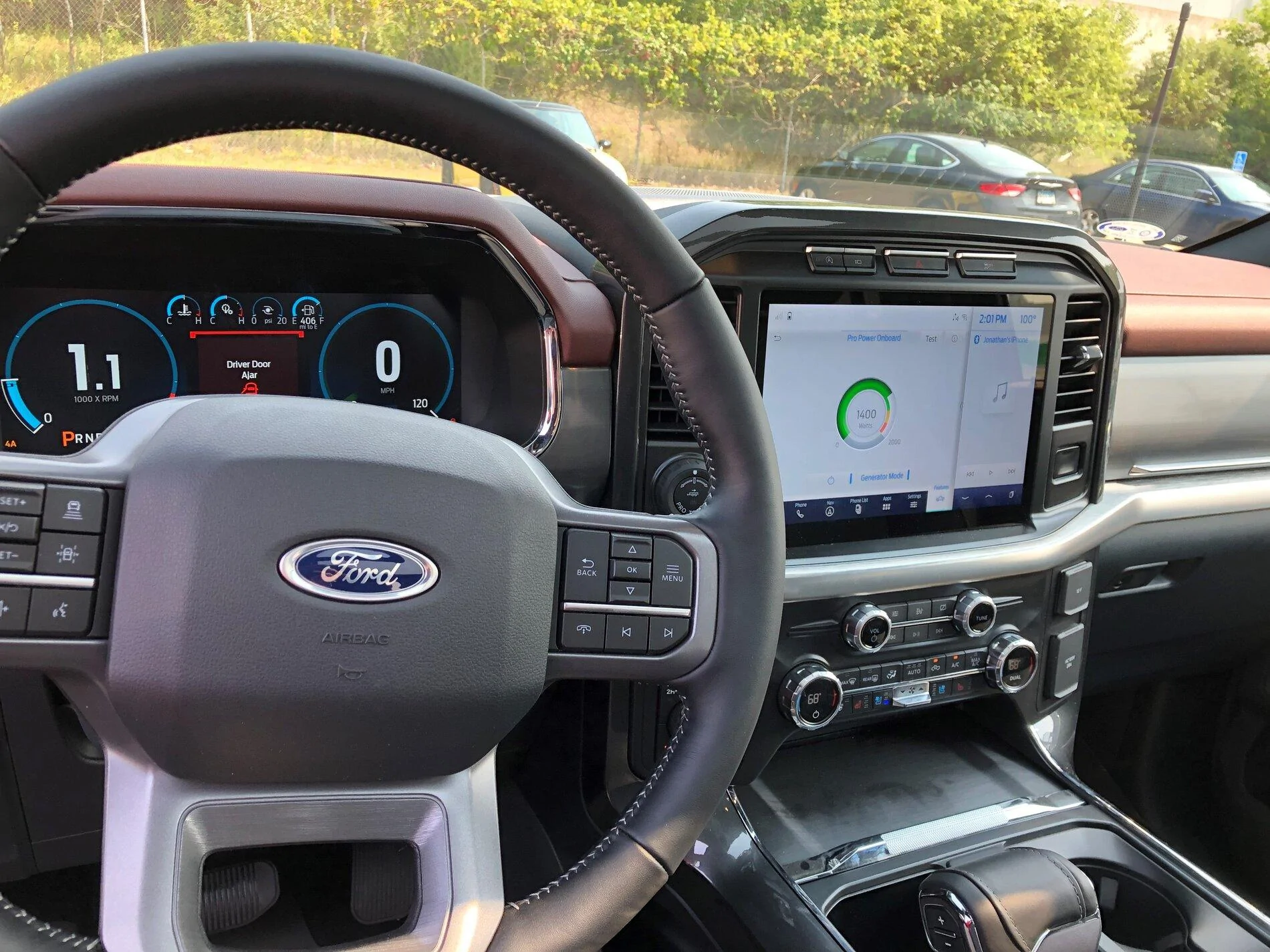

Used 2 heat guns (like a hair dryer). Couldn't maintain anything over 1600W on the Ford Display.
With the heat guns set on a load of 1400W the output voltage was running at 107.2V fairly decent sign wave, but looks to have a lot of harmonics on it.
The real sad part is, even with a soft starter, I doubt this system will run a small AC on my travel trailer.

Yeah, probably need the 7.2 Kilowatt with Powerboost one for that. Aren't most camper air conditioners 30 amps? I don't think I'd want to run my truck engine all the time to power a camper anyways. The good news is you can power a mini fridge and have cold beer.

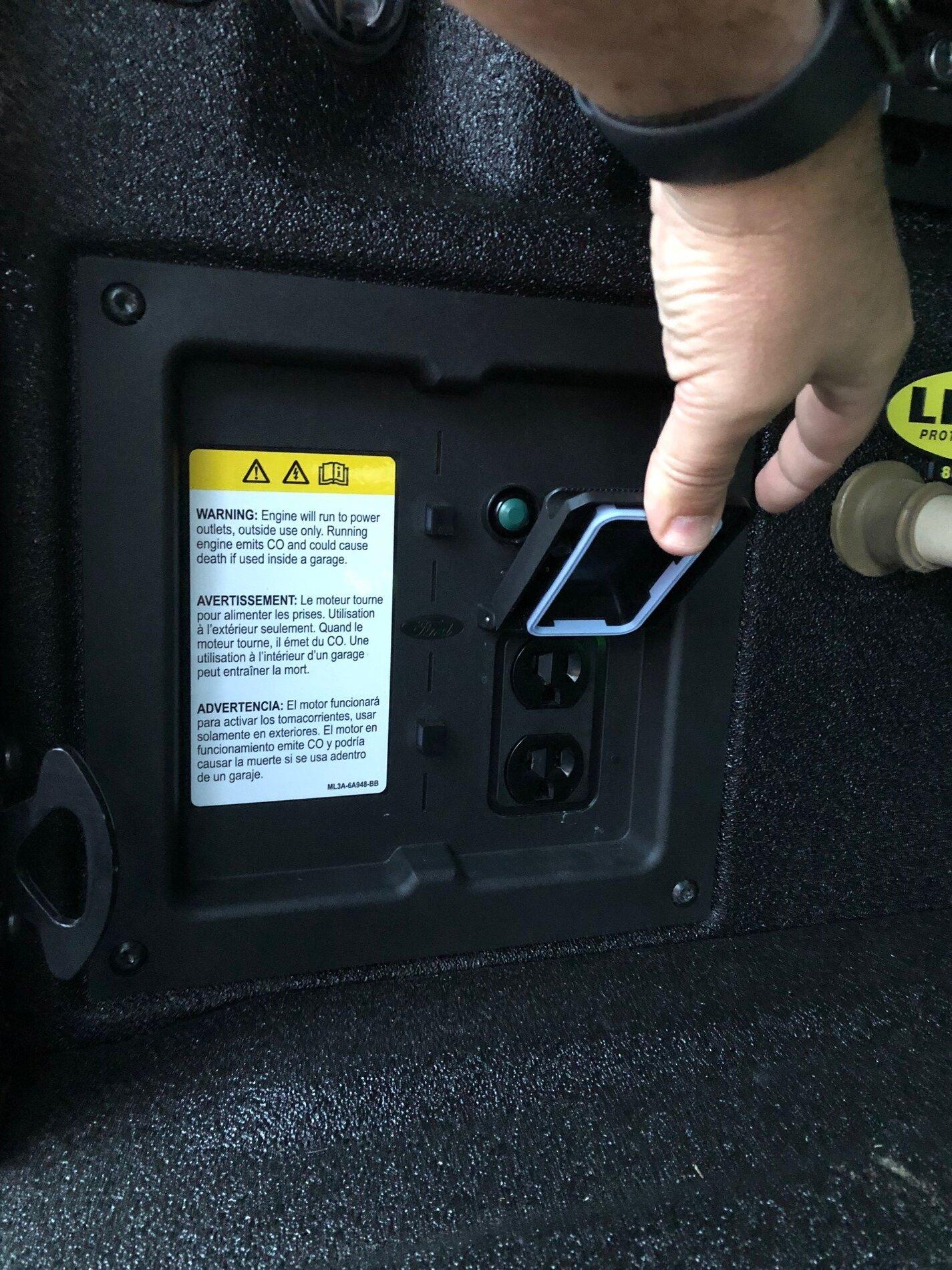

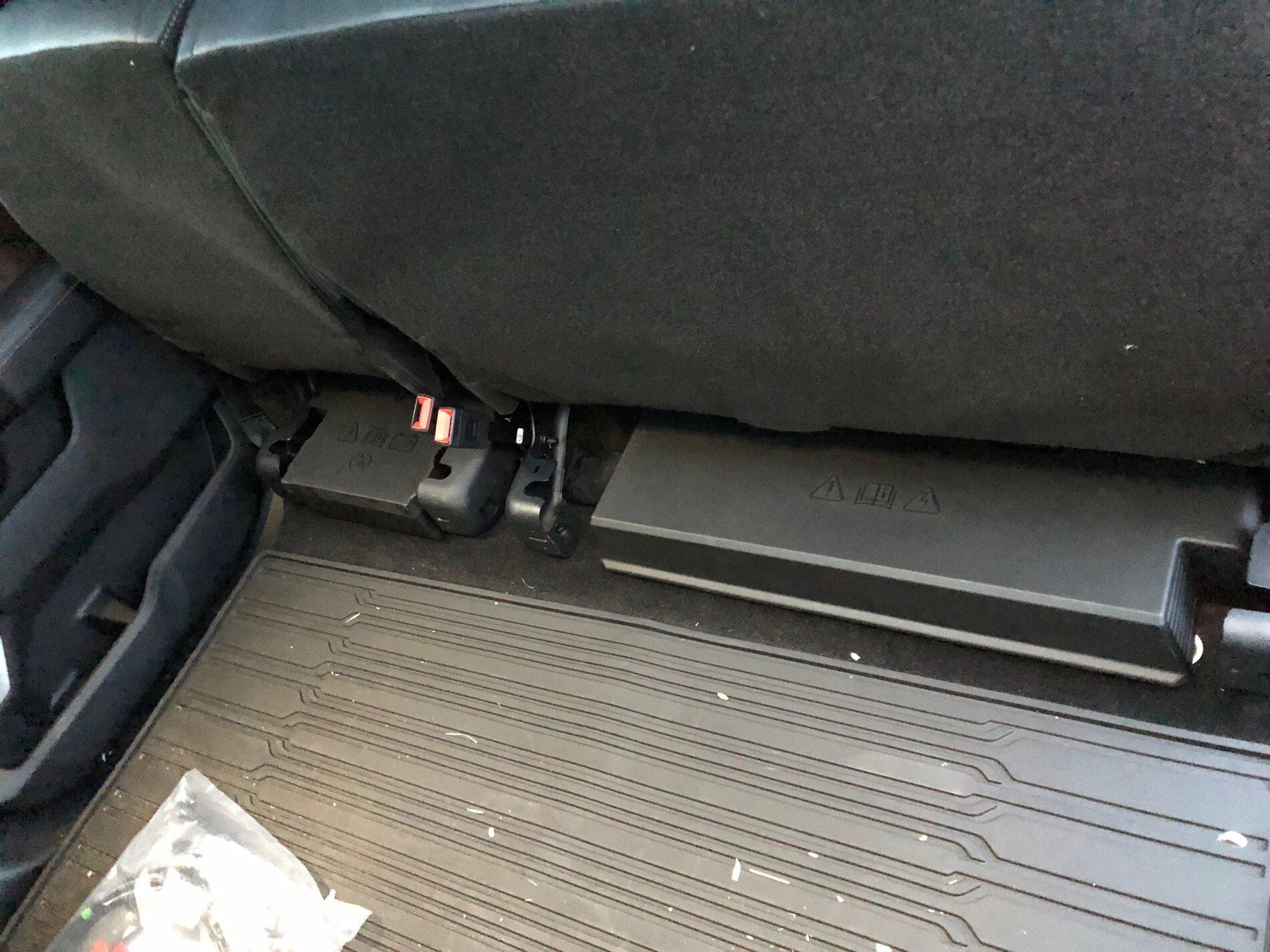

With the 2kW Pro Power, you get a large inverter (converts 12v DC battery to 120v AC) an extra battery and a second battery charging alternator.
You also get the ProPower Generator mode, software. Keep in mind the 2kW needs to have the truck engine running all the time to work. (Unlike the hybrid trucks 2.4kW or 7.2kW, where the truck will only run to recharge the hybrid battery).
There is 1 outlet on the dash, 1 outlet in back seat, and a dual outlet in the bed of the truck.
The inverter is under the backseat, so there used to be some storage space there that you lose.

Does the inverter make any noise when it's on?
Just a cooling fan. I'd say similar to a desktop computer fan. It does make some 'white' noise, nothing bothersome. And if the radio is on you can't tell it's running.

I took a scope capture of the loaded sine wave from the Ford 2kW inverter, Top of this thread. it's a fairly decent true sine wave, has a lot of harmonics in it but may just be a result of the heat guns I was using for load.
Any chance it's cheap wiring? Legit wiring is the main reason I got the 2k PP.
