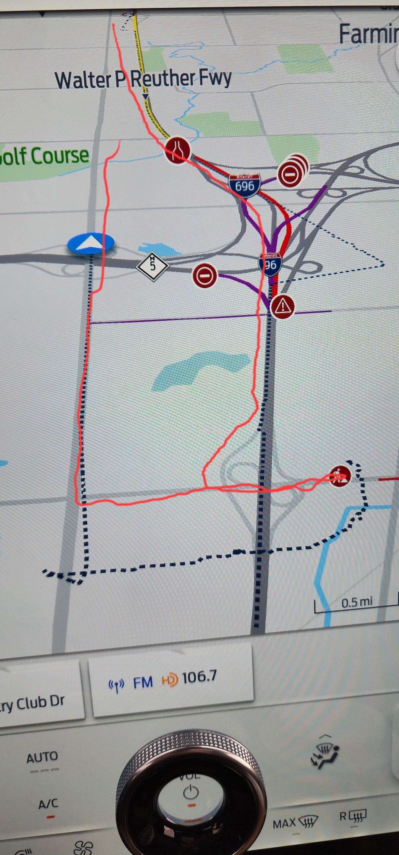

I'm still having issues with the car gps, if you drive in a straight line long enough (a mile or so) it'll probably lock in on the road you're on, but make a turn and the car-gps will happily move on straight ahead, fields and lakes be damned.
I edited the picture to show the actual route, pardon the red squiggly lines (the dotted black line is the GPS / cookie crumble route), but 696/96 to Novi road, to a strip mall, stripp mall back on Novi road and Novi road to 12mile. They're all normal turns and not U-turns / Michigan lefts.
I also tried putting back the OEM whip antenna, but nothing changed.
