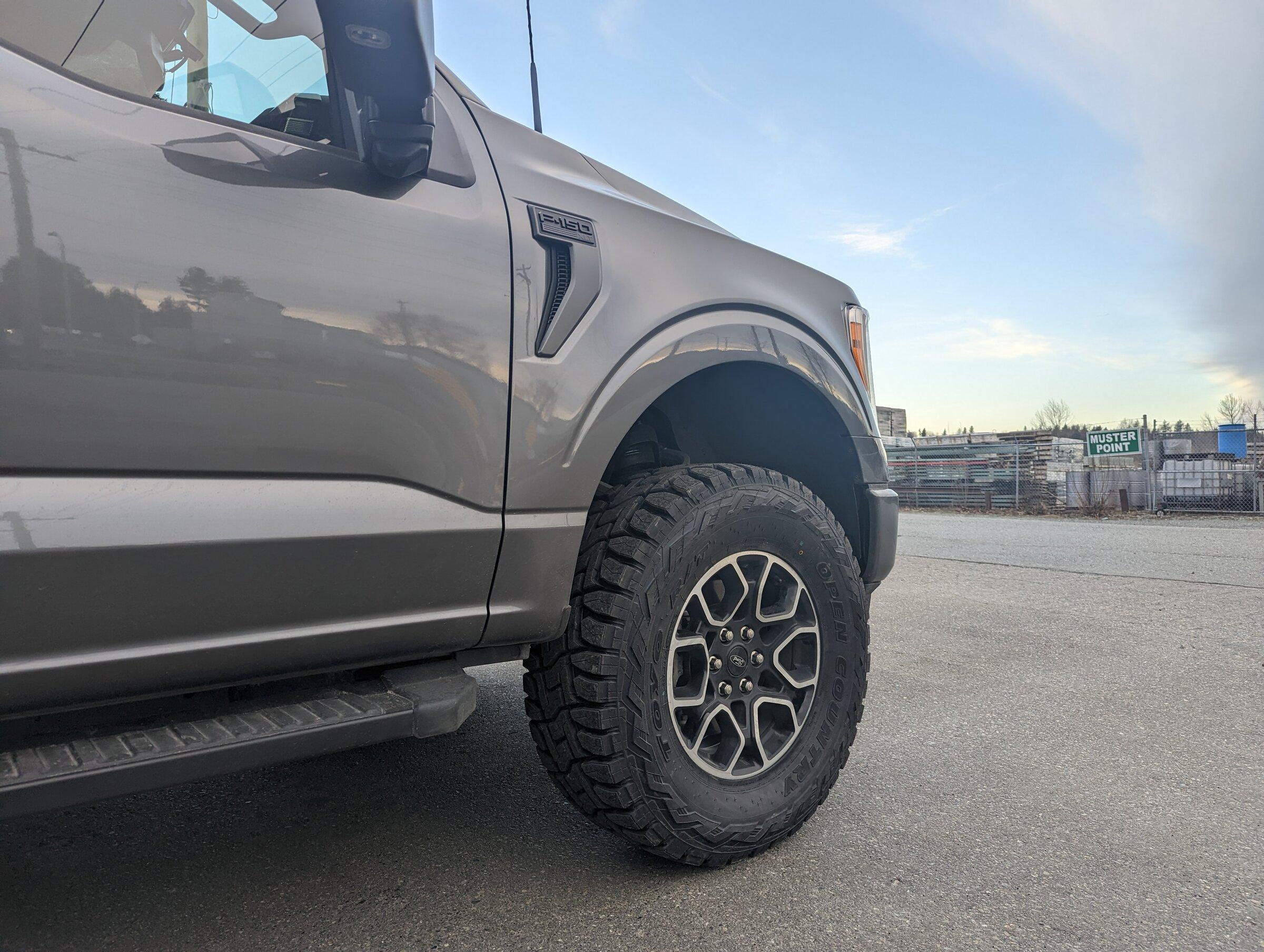

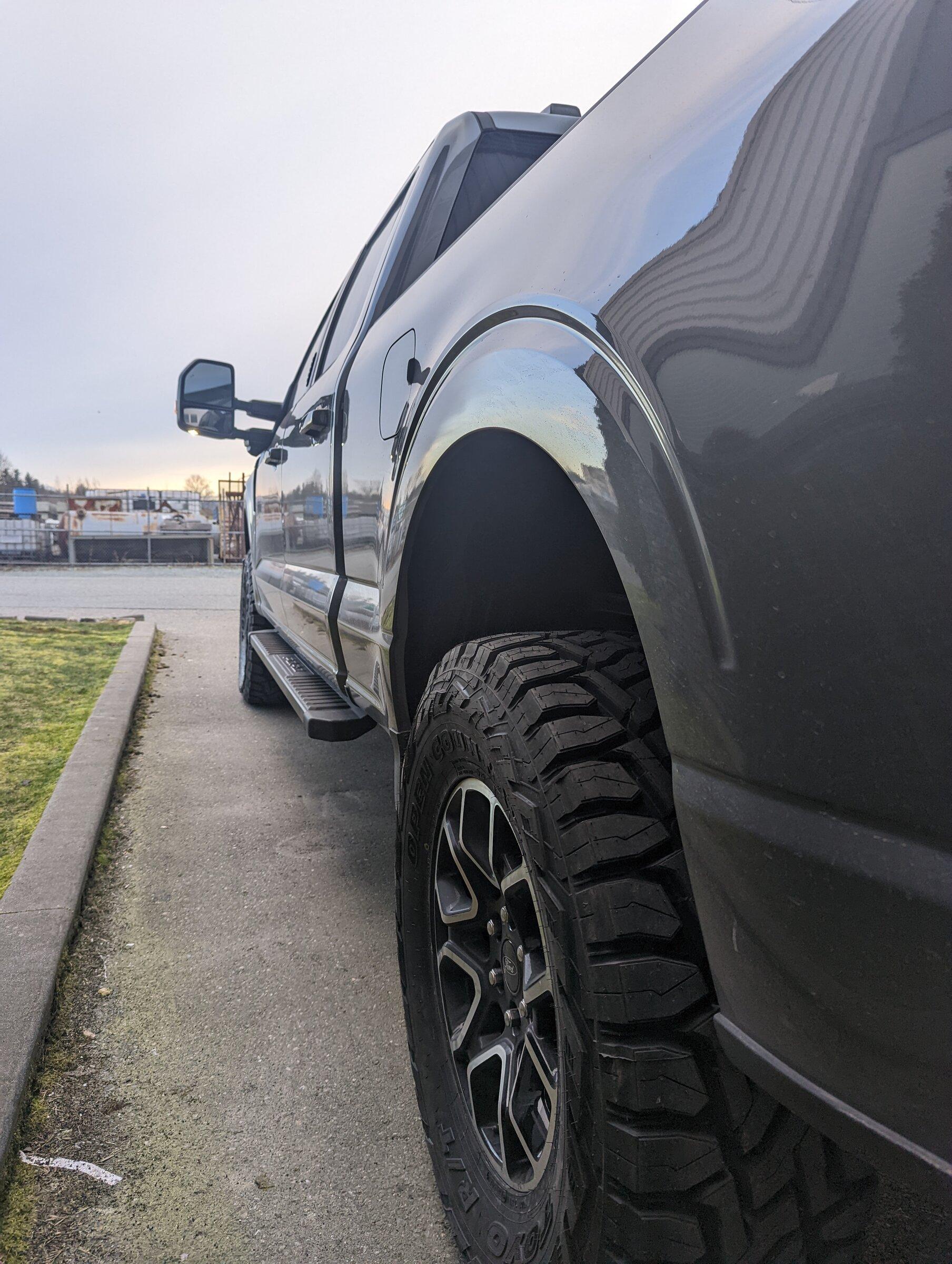

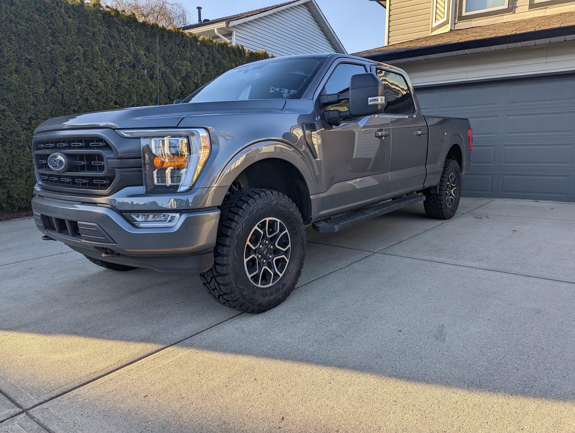

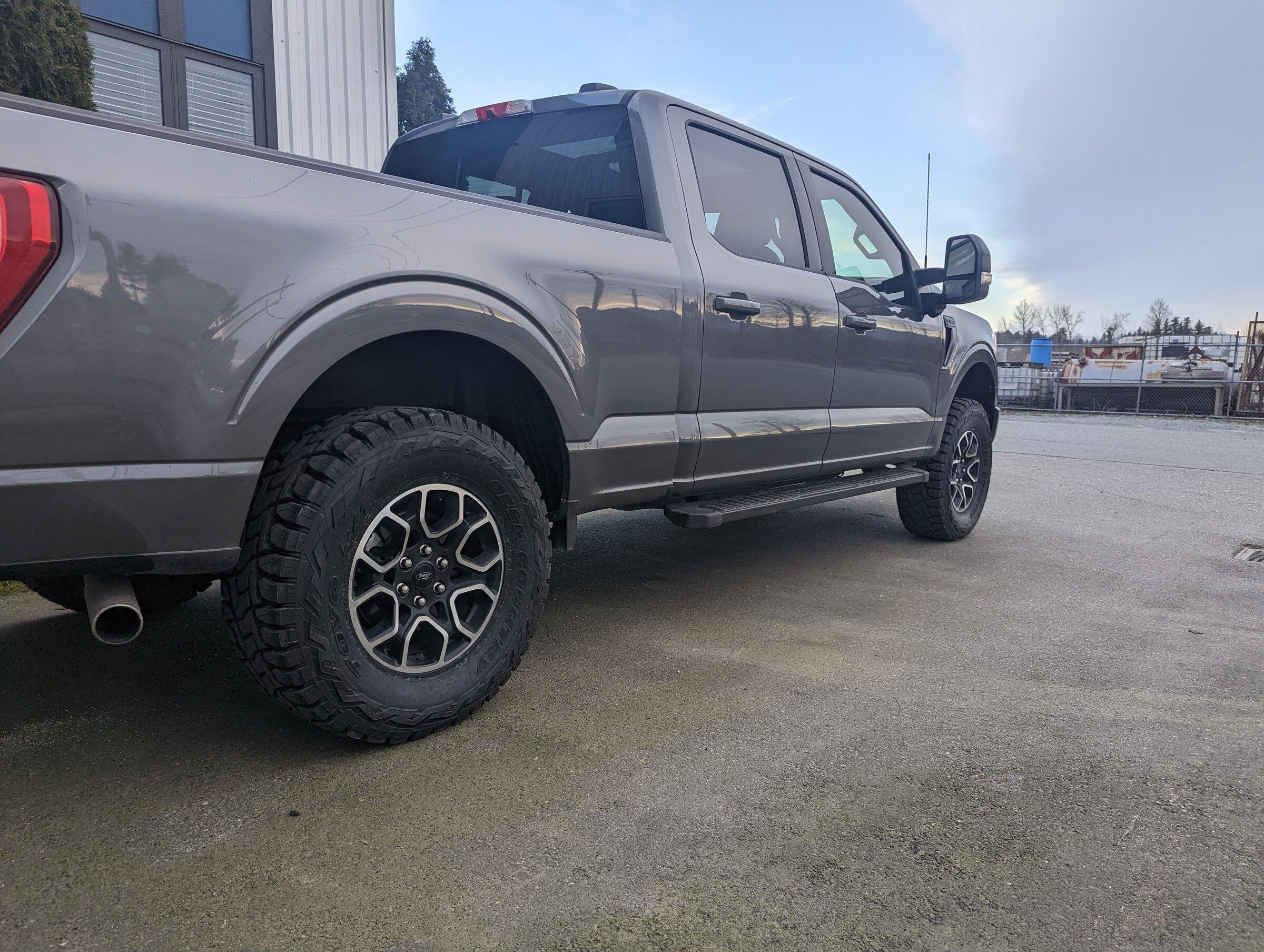

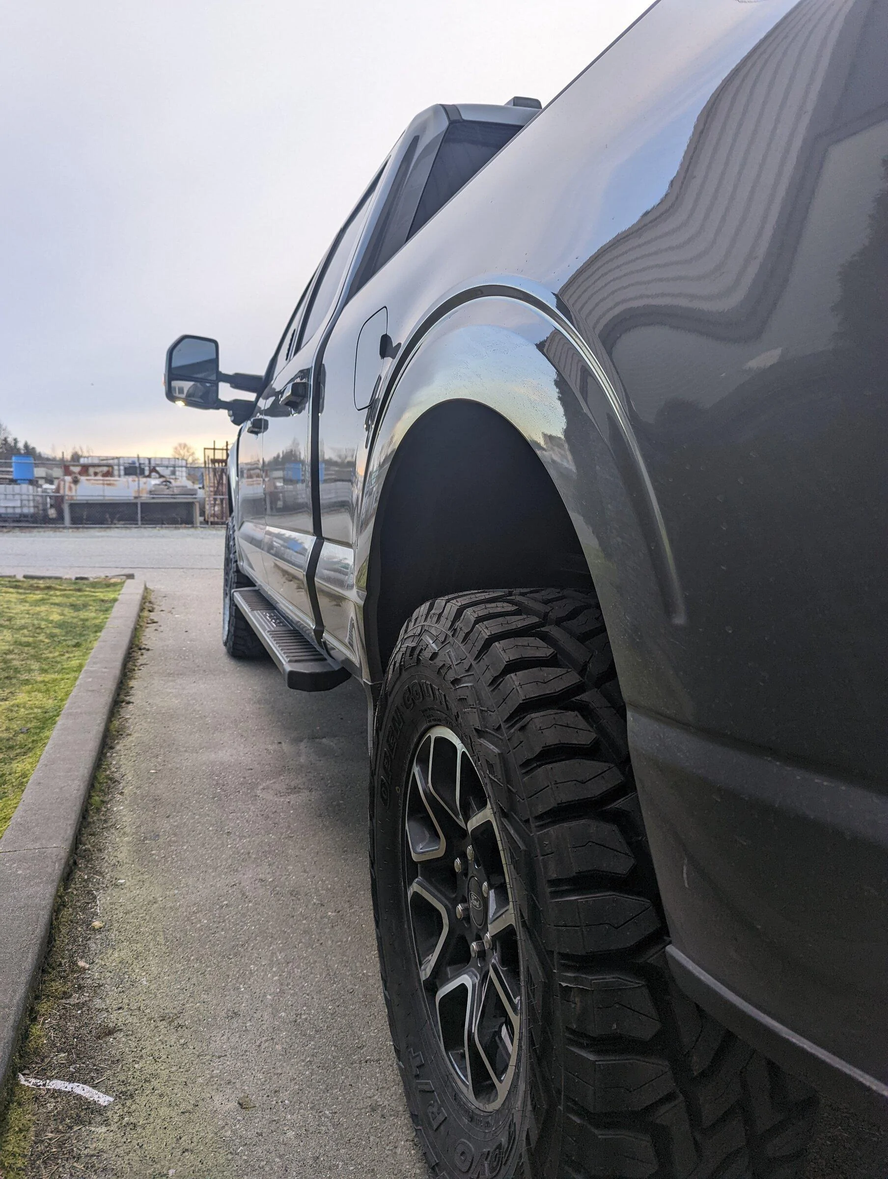

Got the 3" Rough Country lift installed a couple of weeks ago and just got the new tires on. 35 x 12.5 x 18 on factory Sport wheels. Went with the 3" so they didn't have to cut anything. Overall I'm happy, coming from a SuperDuty I feel like I'm back up at that height again. Had to use 1/4" spacers in the front to clear the A Arms, but if you went 35 x 11.5 they would likely be no problem.

Went from avg 17.4 down to 16.2 less of a hit than I expected. But the 35" RT's are very heavy.
