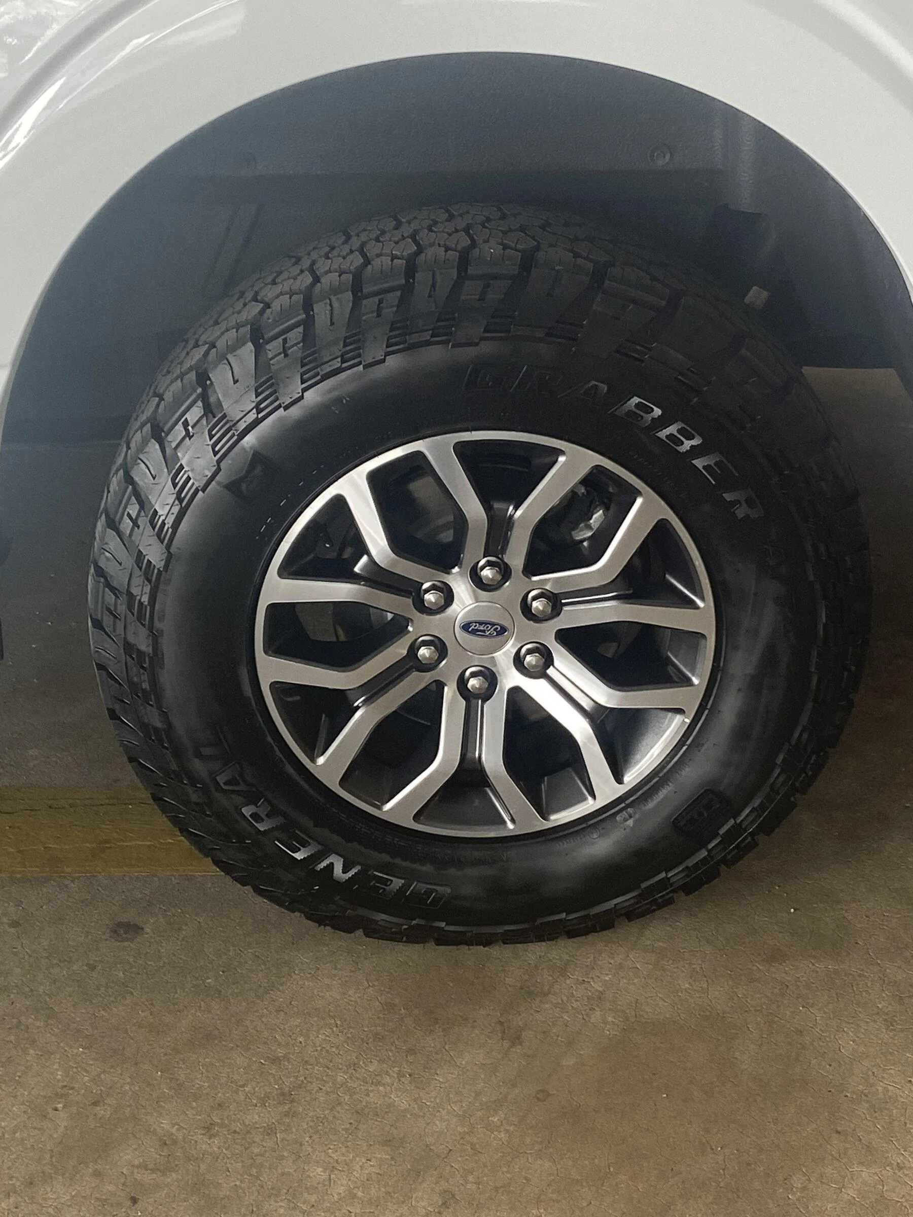

I am trying—fruitlessly—to find the width of the stock 18” Lariat/King Ranch wheels. Wheel-Size.com isn’t much help. Their chart has some errors, notably the 18” sport wheels being listed at 7.5”.
Anyone had these off yet and seen the numbers stamped on the inside of the wheel?
Edit: crisis averted. Wheel-size.com is incorrect, the 64M is 8.5” wide.

Realize this was quite a while back. So the wheel in the pic is 8.5 wide? If so that opens up a whole new world of tire sizes. ?

Yes they are 8.5". It is marked on the inside of the wheel.

Same exact wheel as the Tremor wheel, only painted. Both are 44 offset as well. Looks great with those Generals mounted as well.
