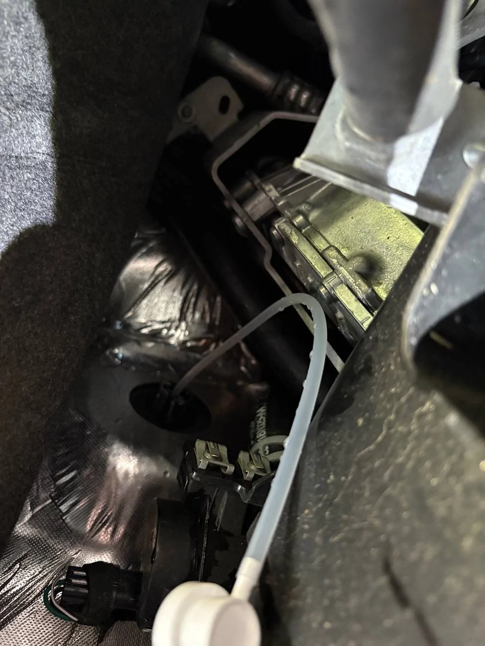

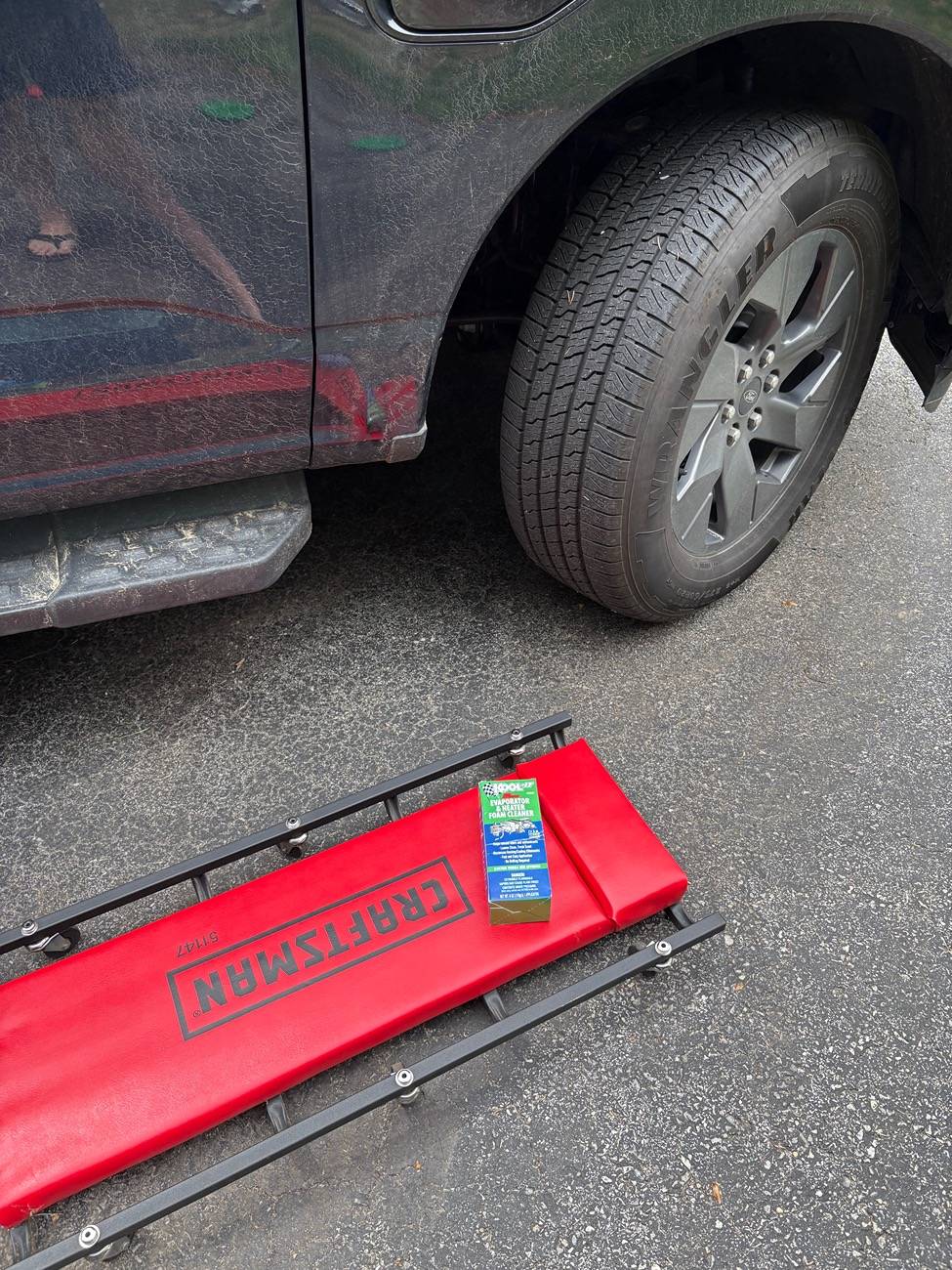

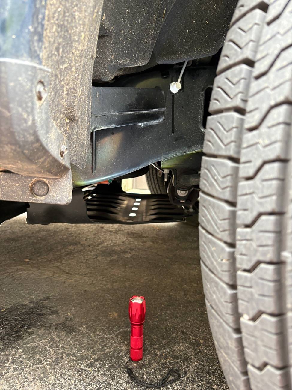

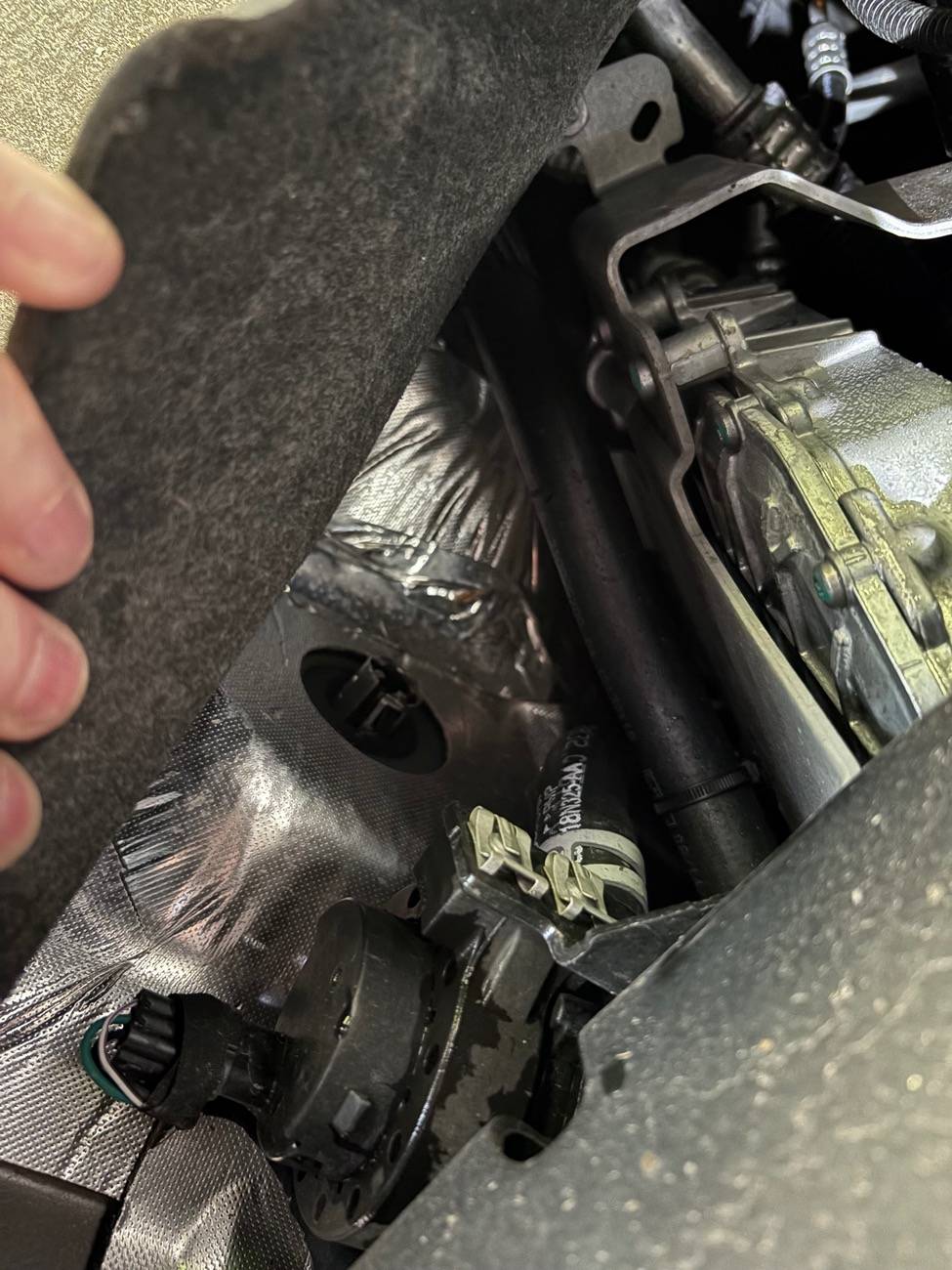

The drain identified by scruvs is indeed the answer. I’ve had the horrible a/c odor for months and finally eliminated it today. I put a new cabin air filter in there before proceeding. The products I used are Kool-It evaporator coil cleaner, and Frigi-Fresh. Just park with your wheels turned hard over left, and sneak under the passenger side front wheel well. Look up toward the firewall and gently pull the well liner back an inch and you’ll see the drain. Feed the Kool-it applicator tube in, hook up the can, dispense the full can (took maybe 10 seconds), and pull the tube out. Wait 15 min (foam/liquid will drain) and then start the truck and turn on the a/c on low. Disable “driver focused” so all the vents open. Run the a/c a few min. Then, turn the fan to high, get out, and zap the fresh air intake (cowl center and passenger side, below the wipers) with the Frigi-Fresh. Let the system run a few minutes. Open the doors and let it air out a minute or two and job done. Some bubbles might come out the vents but that is inconsequential. It’s crazy how well the products worked.

No worries, I hope you fix your problem too. I can’t take any credit - I saw a guy on YouTube deodorizing a super duty with these products but he was drilling holes in the evaporator housing, etc. No thank you. This procedure I described is what the box instructions say. I’m glad someone else on here knew where the drain was. I looked at a ford parts website with a diagram of the evaporator and blower housing (same one in all F-150 models and a couple other large Ford vehicles) with the drain part identified to confirm.
