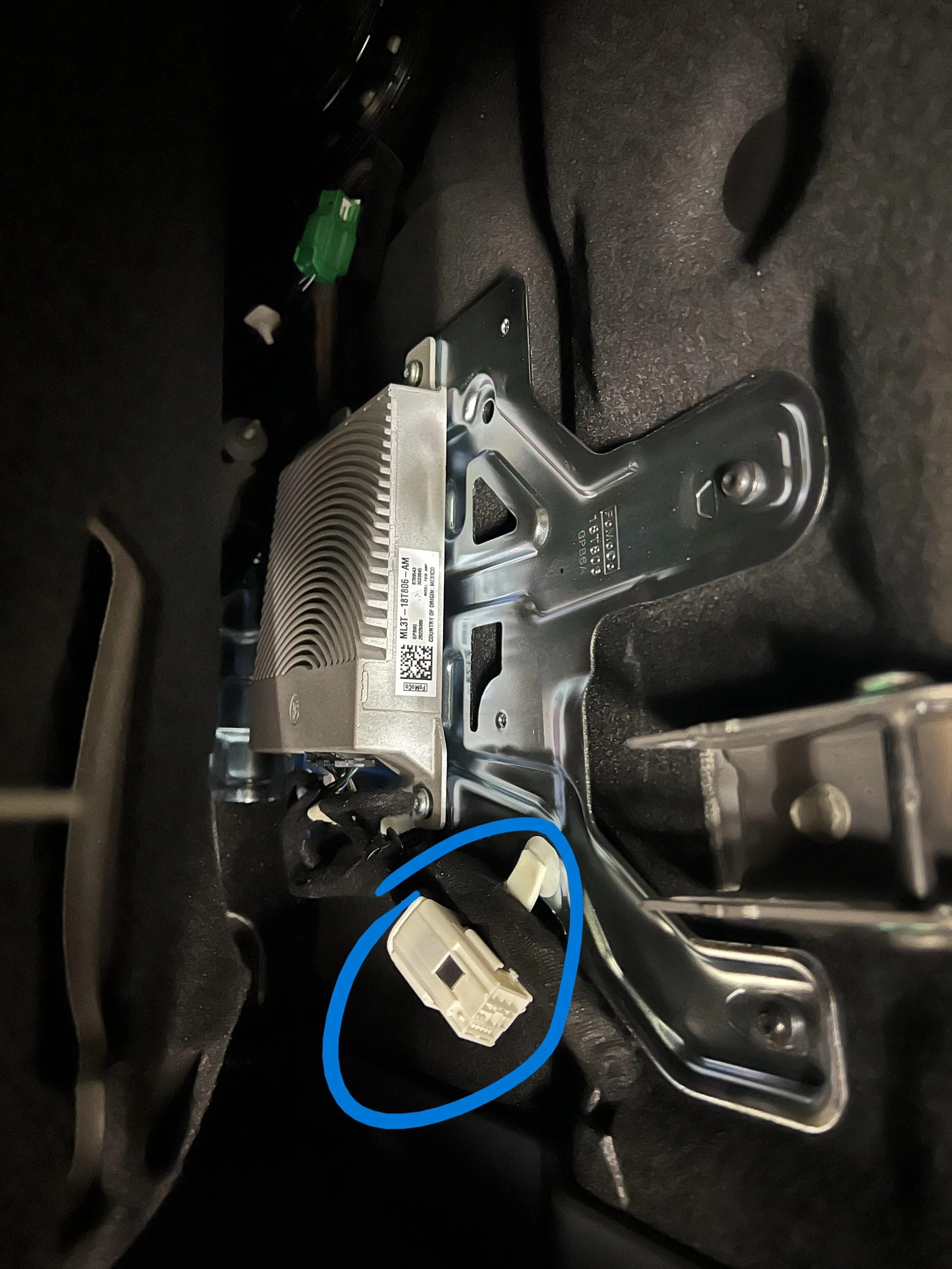

taking delivery of a 510 lariat soon. wondering if the addition of rear seat heaters is as doable as it is in the ICE f150 lariat.
can anybody with a 510 lariat confirm if the connector is present behind the drivers side rear seat like in the gas f150?

installed using the parts from the gen14 thread and works as intended. heated rear seats!
Did you purchase all the parts in their list or just the pads and switch parts , no harnesses?
JU5Z14C724B -Rear Seat Heater Module (List Price $159.33 )
ML3Z15046A78BA -Switch Plate for console (List Price $26.77 )
ML3Z14D694AA - Rear Seat Heater Switch (List Price $56.36 )
ML3Z14D696J - Seat Back heating Pad x 2 (List Price $45.50 ea)
ML3Z14D696B - Seat Bottom Heating Pad x 2 (List Price $37.50 ea)

the entire list. you need the harnesses to connect the module to the seat pads and to the truck connector that is still there.
fun fact that i didn't;t realize, the unpopulated male connector is what holds the connector in place on the back firewall. you take that off and then use the harness to connect to the truck.
oh, and i did like he did and just rewired the entire center console. just search the ford parts site for a part 14S411 and a lariat 511 VIN and it will get you the correct harness.
