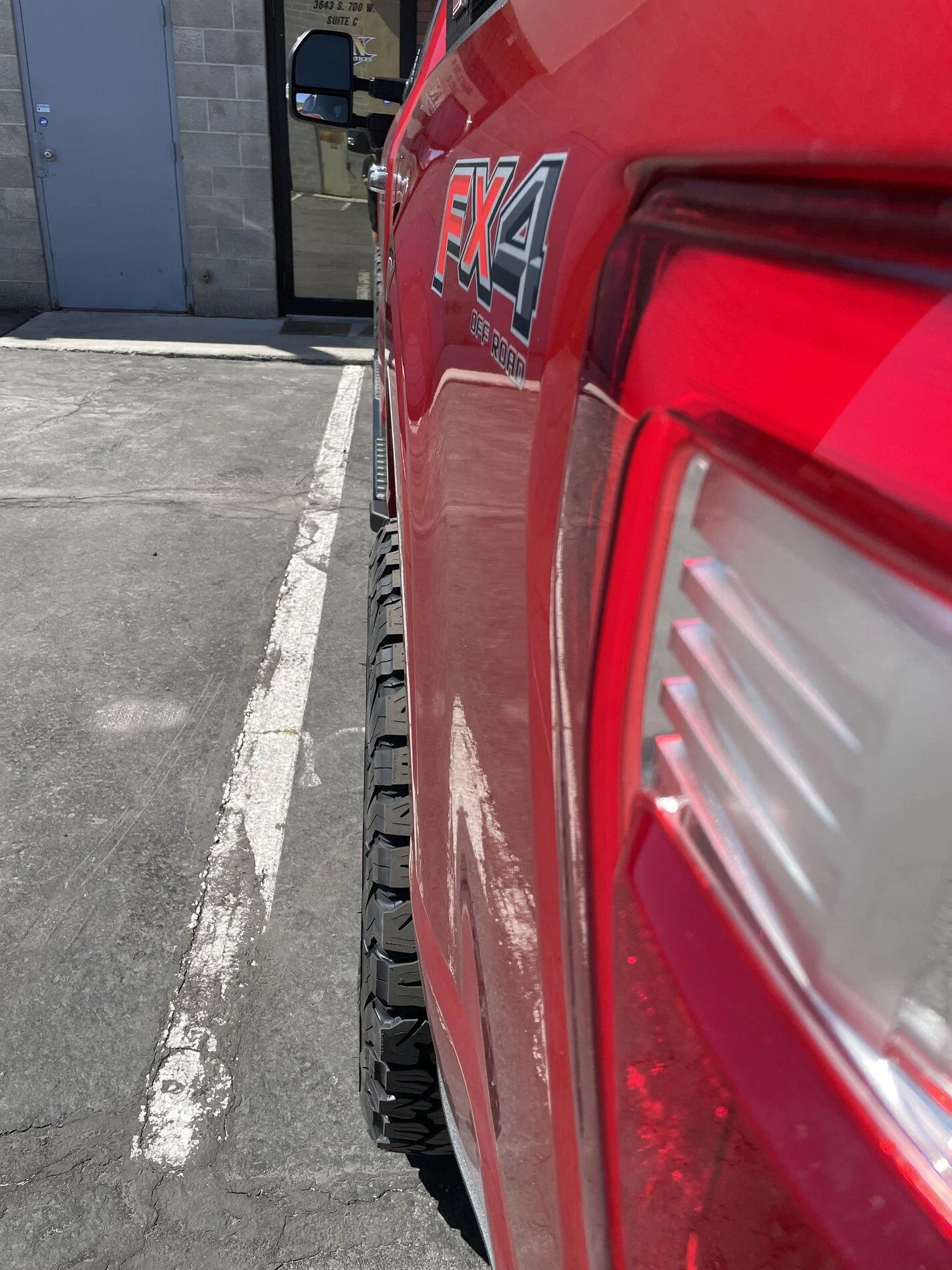

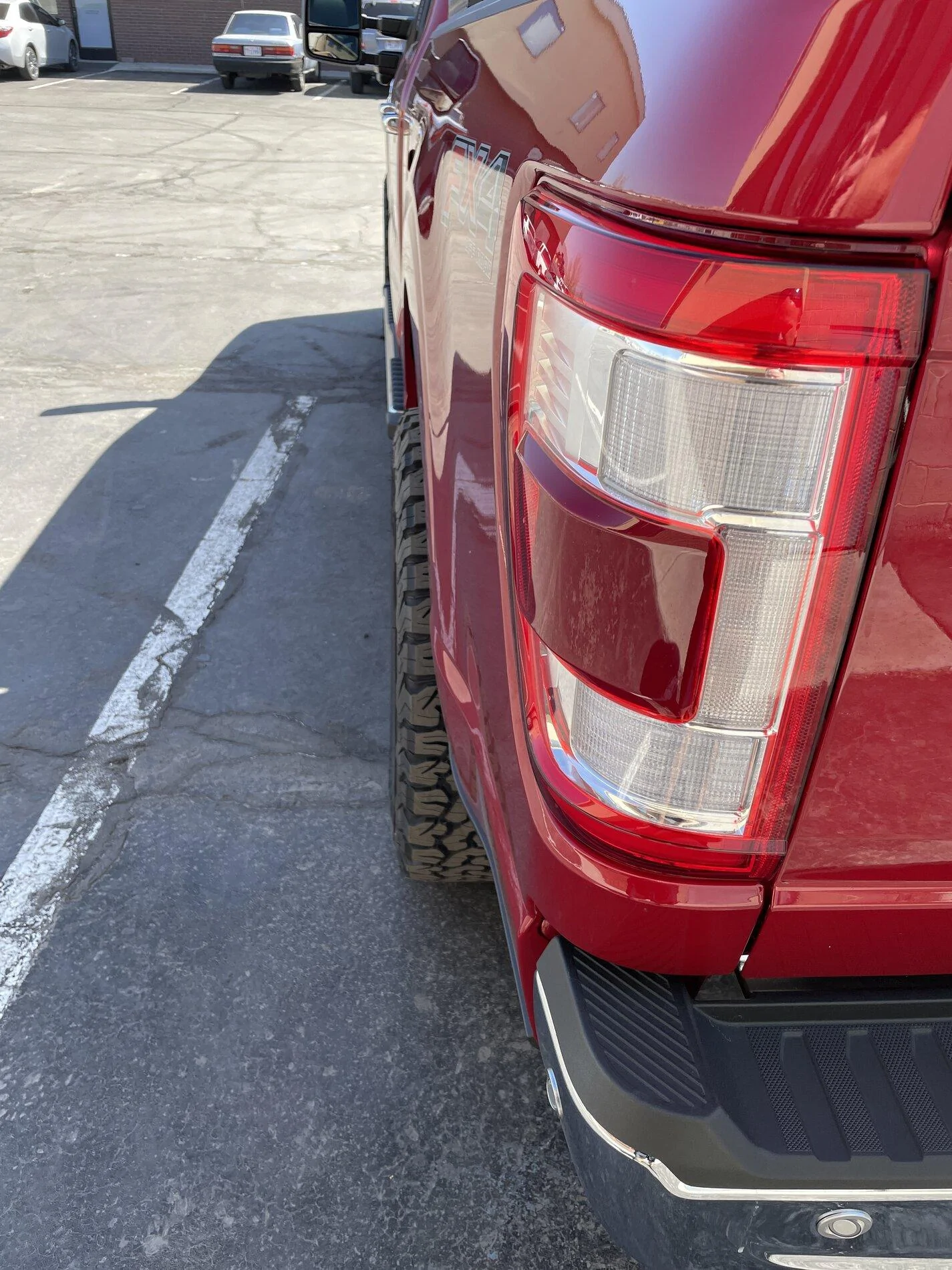

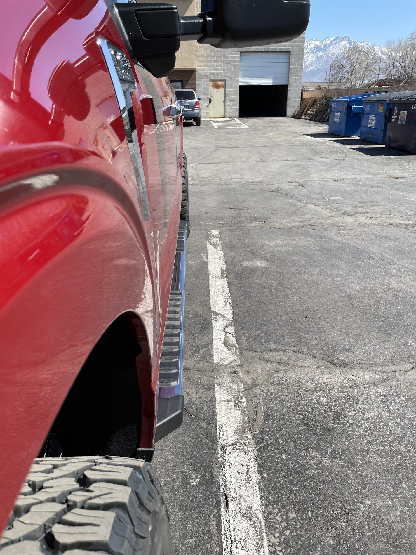

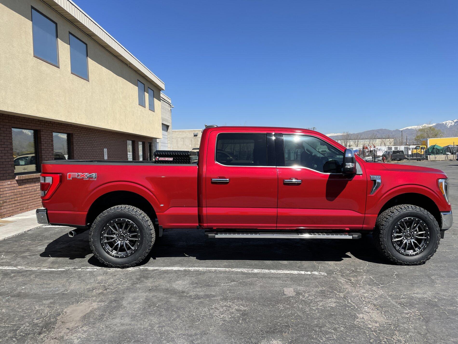

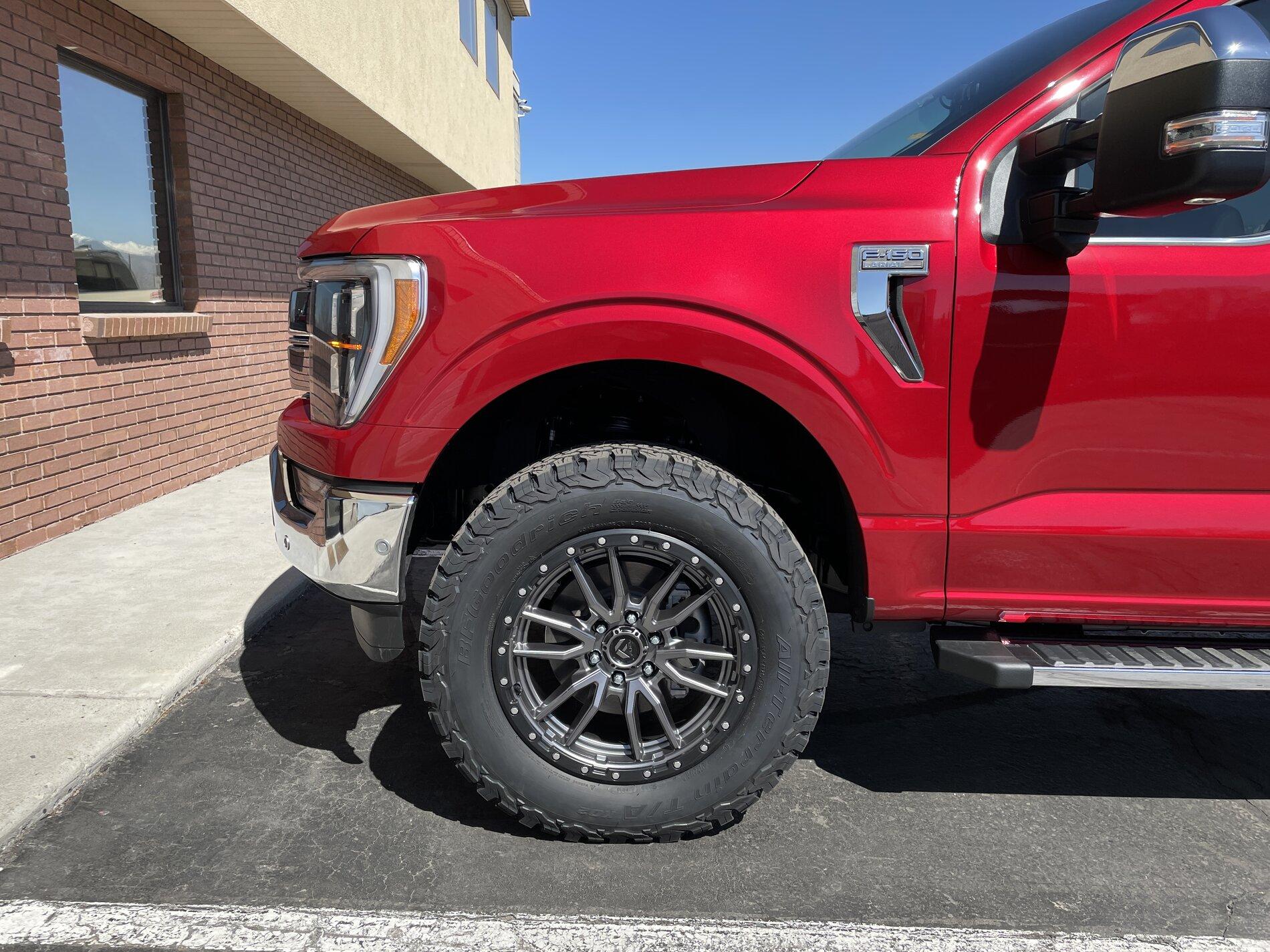

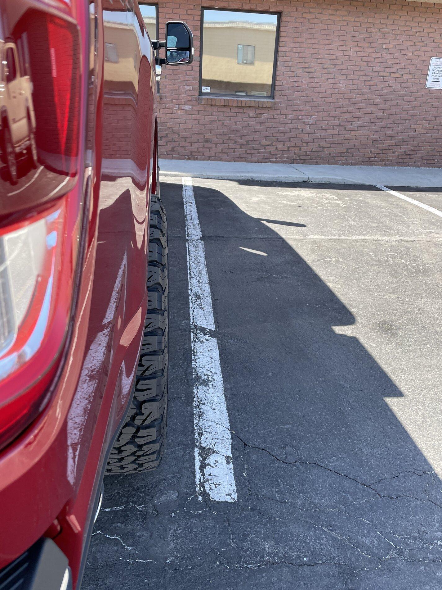

Just got my wheels on. Fuel Rebel 6-Anthracite / Black. BFG KO2 295 60 R20 +20 offset.

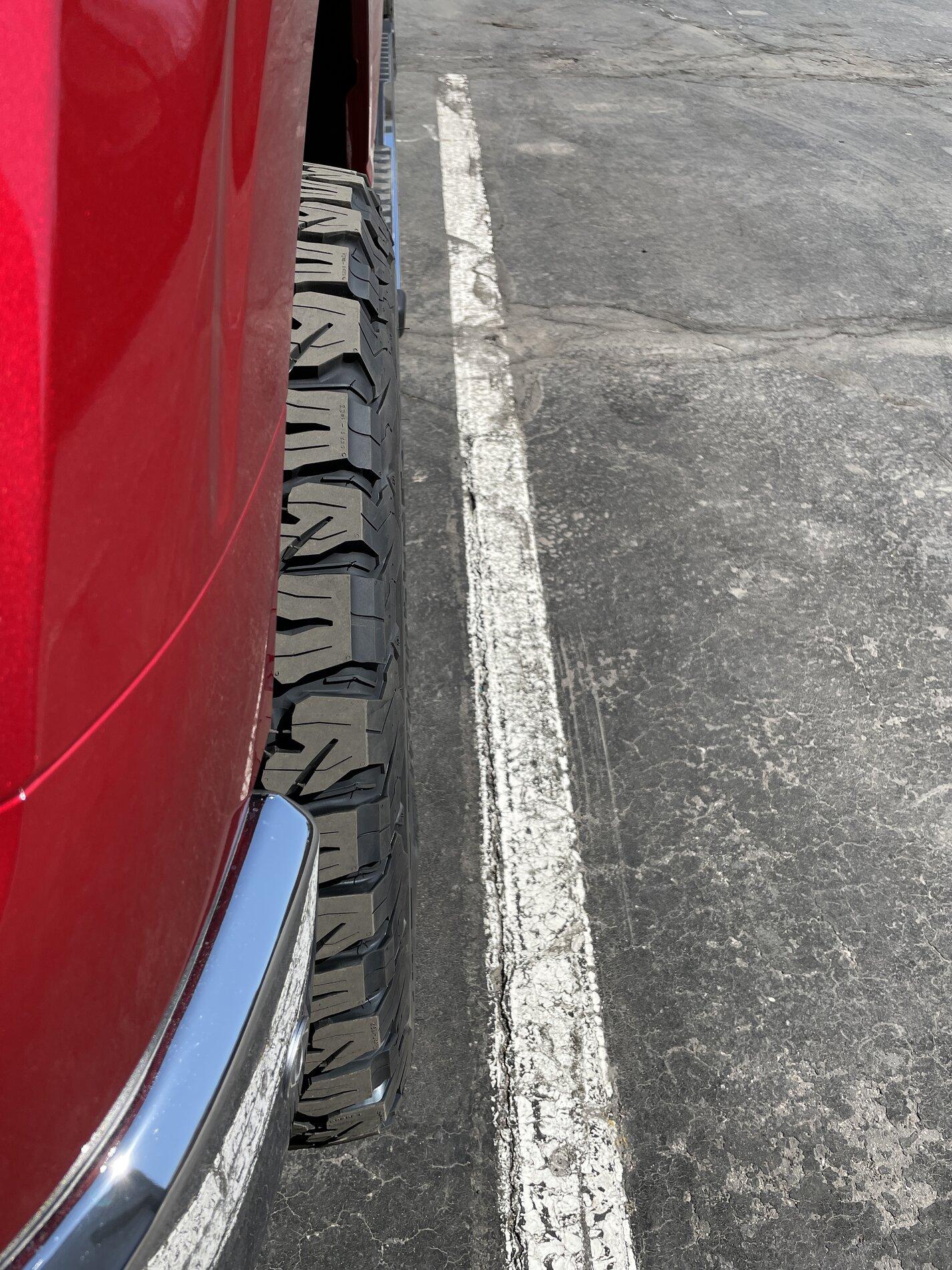

I like them, but not sure about the rear poke. I dont want to spray crap down the side, and these appear to poke out than previous setups I have ran. More of an issue with the rears than the front.
What are decent options?
-Fender Flares, Ive never done these because I hadn't ever wanted to drill....should I look at this option though?
-Ford OEM mudflaps. Im not sure this will provide enough coverage
-Clear Bra film?
That looks really good with the color of your truck. I’m debating the same. Personally, I think they need the previous gen fender flares, which I believe Ford offers them in Ford parts. I’m looking at those now. I will probably add some 3M protective file on the rear to protect the paint.
Thank you! I think I am going to do the same. I bought a roll of Oracal Stoneguard, so Ill prob do the same and cut a few pieces over that section on each side. I ordered the OEM mudflaps, but they may not work that good with the wider tires.

might be a bit late but you could switch to a 275/65R20 tire to reduce poke by ~ 3/8" (10mm)
I should have done that. The metric sizes are hard to figure, plus trying to get something that doesn’t rub. I figured going with what Ready Lift recommended was key.
Talk with Discount tire and they likely will swap these out - if you do this look at the Nitto Terra Grappler in 275/65r20 to also save 18#'s per tire for a better mpg and smoother ride
My issue is not only the slight poke, but making sure new tires wont rub. I went with the 295 60 r 20 becasue Ready Lift had tried it, and it worked. I wanted to go 285 65 R20 to be a little taller, but honestly I dont know the strategy to avoid rubbing. Currently with the 295's I have 1/2" clearance, so no problem one bit. I wished I understood these sizes better and what factors into rubbing. I assume its a combination of both hight and width, but maybe im worng. Thoughts?
285/65/20 with 2in level won't rub. This is the setup I have.
Offset is definitely going to factor into it. I’ve seen one guy run 35’s on stock wheels with the 2” level but you’d have a mess on your hands with an offset pushing the wheel out
