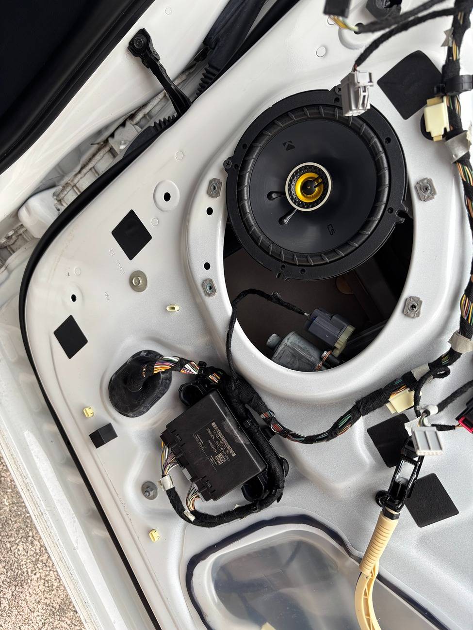

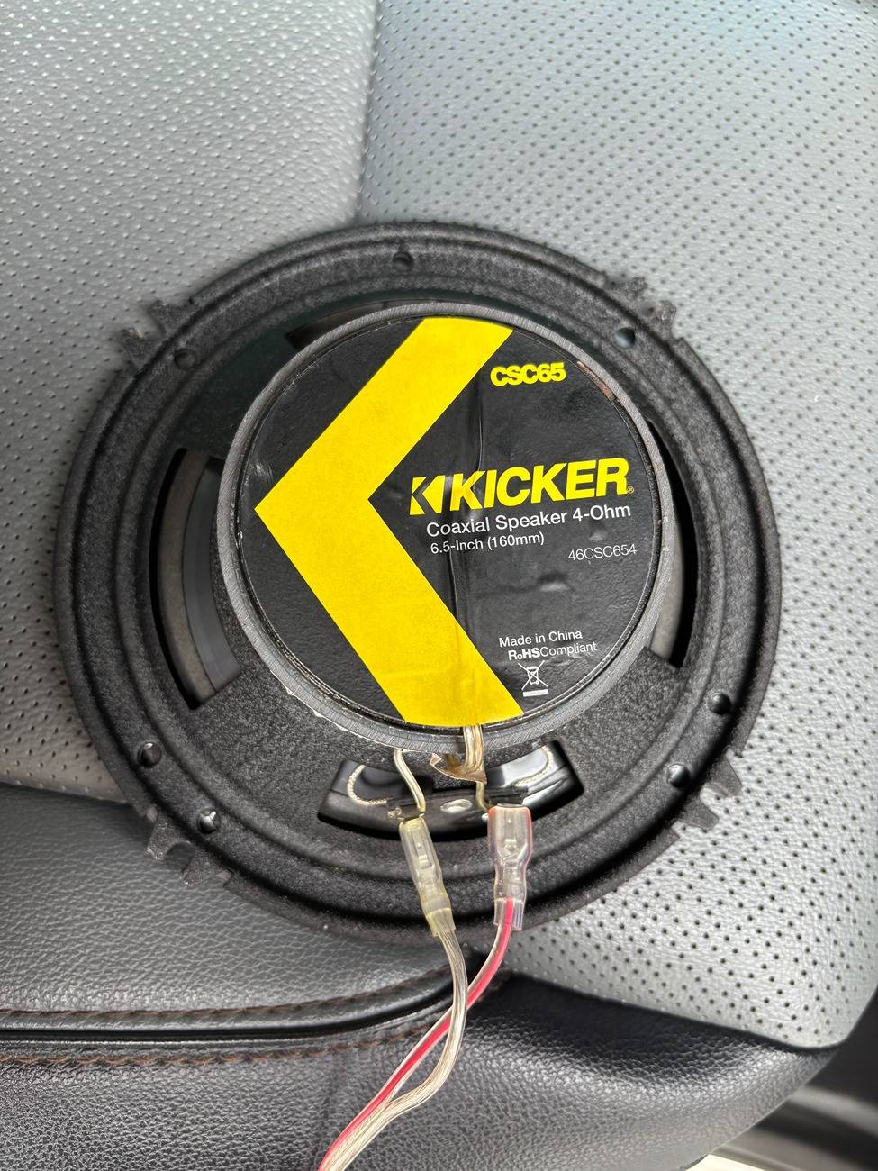

You won't make it without going all the way to Phase 4 and in fact, that has to be part of phase 2. It doesn't make sense to spend the time and labor to open the doors and install block off and other materials in the doors without replacing the speakers while in there. There are many threads with upgrades of low to moderate priced speakers and very nice improvements. The factory speakers are junk - lightweight and paper.
If you do a speaker upgrade you may not need some of the other phases, based on what you want out of the system.
