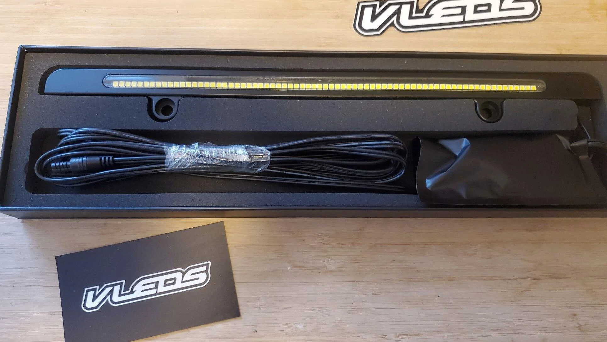

Enter the License Plate LED bar. There are a few models out there. I was looking at the Headlight Revolution model and the VLEDs LP parts. All the reviews made the two seem fairly close, the price to ship to Canada tipped the decision matrix. Below are some photos of the product, the install (since its a generic) and the finished product.

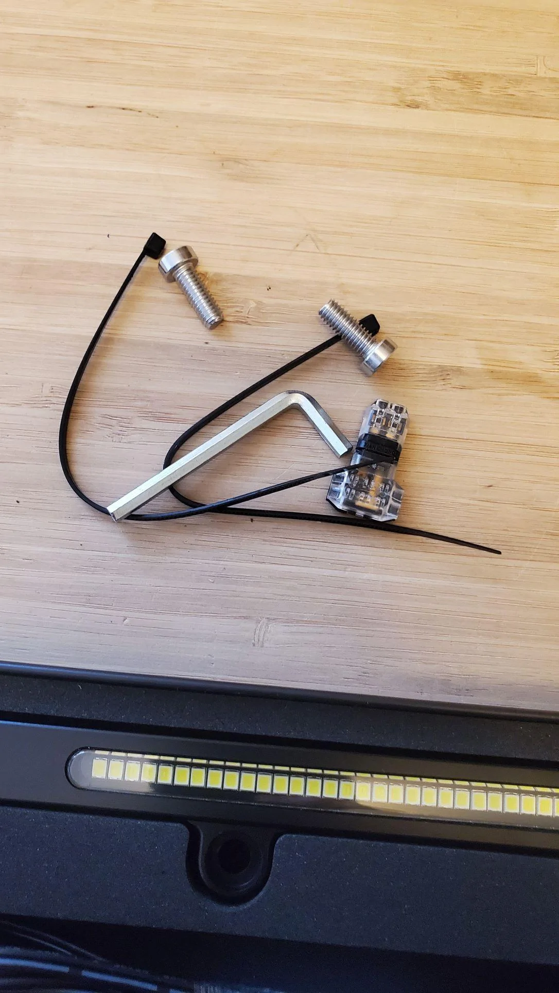

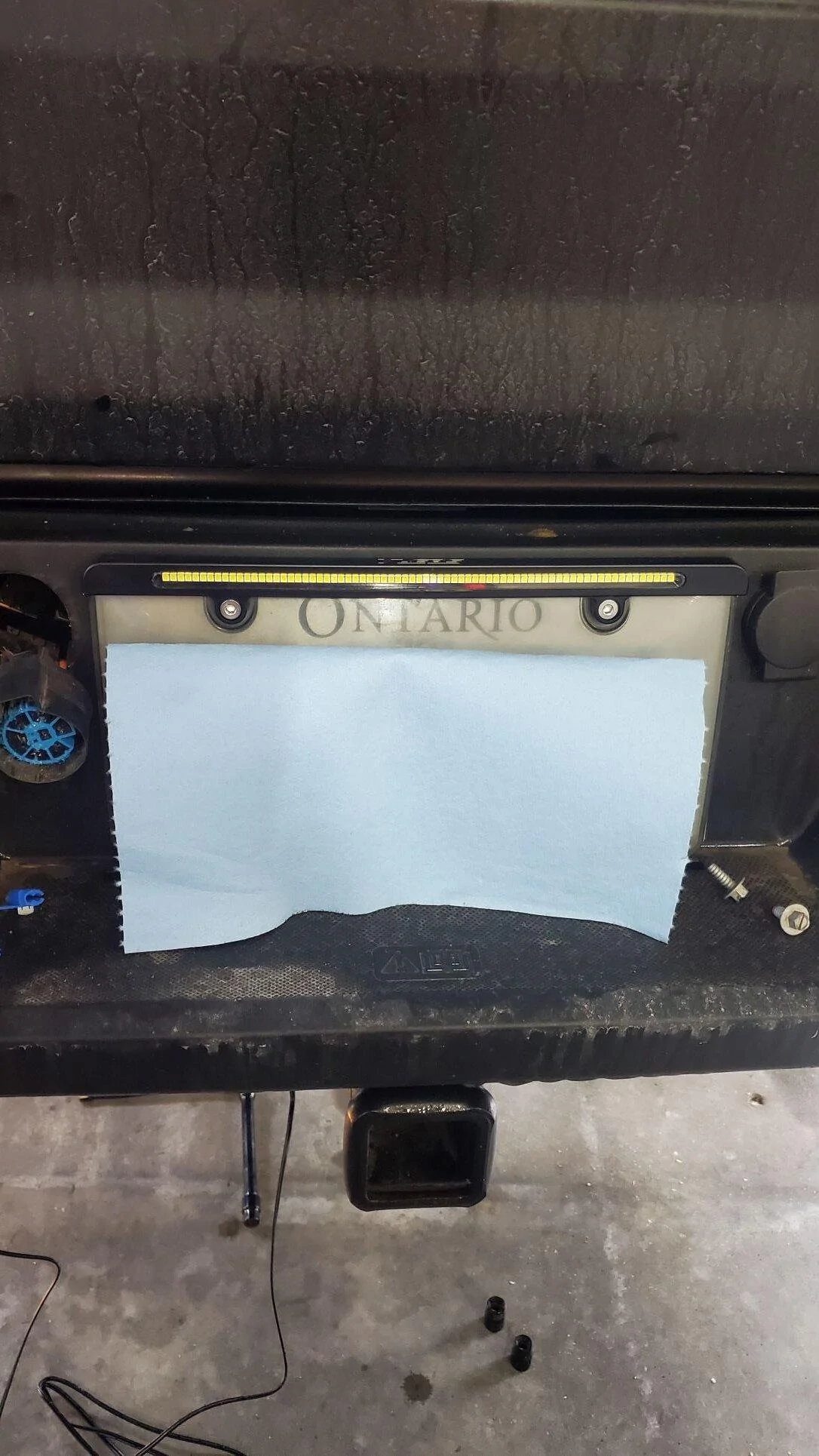

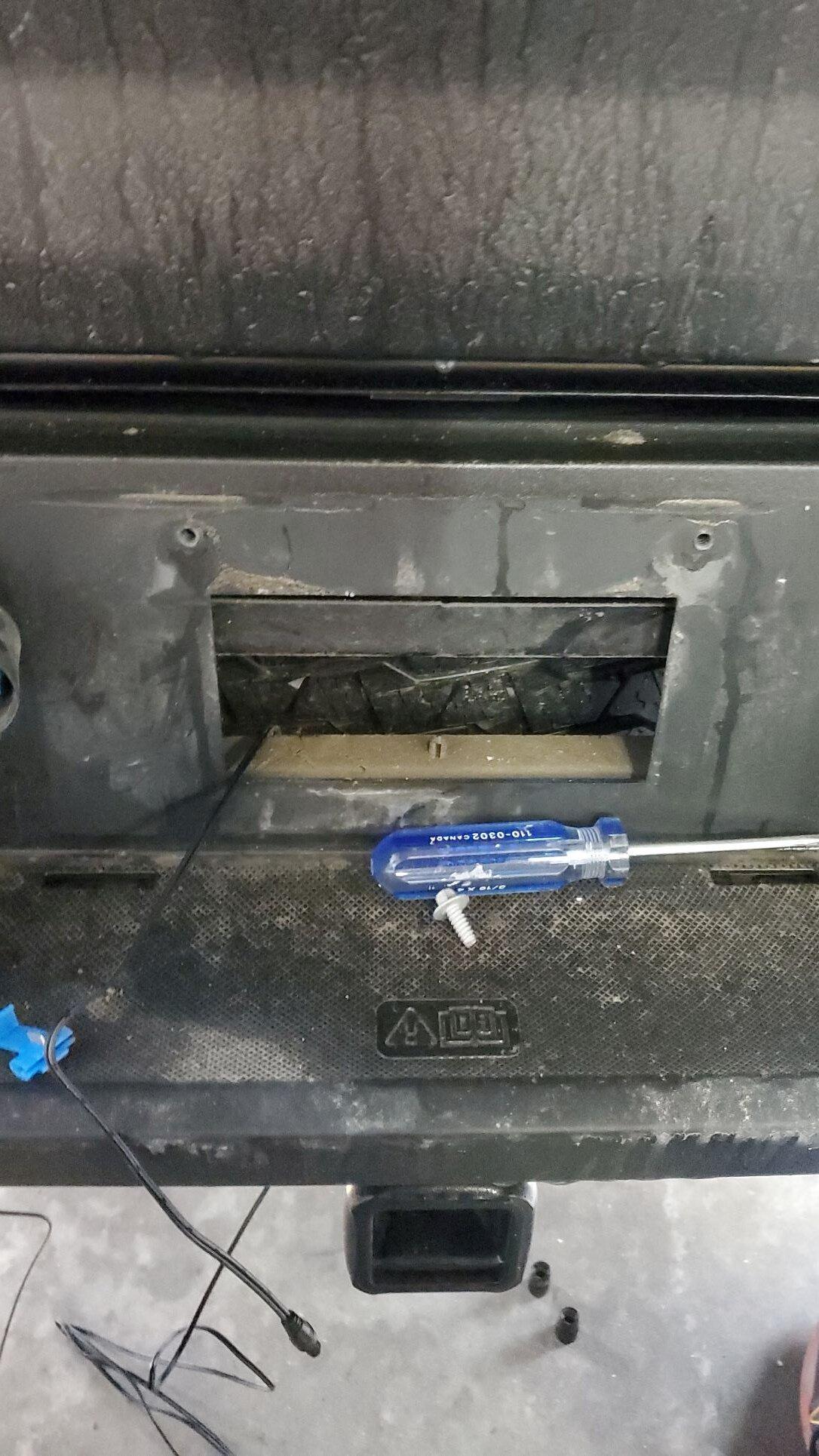

I`ll leave a link to the product below, so you can read more about the specs, but the aluminum body of the light gives me some sense of comfort that it will last. I pulled the plate off to find that I would not need to drill another hole in the bumper.
Ford F-150 Lightning Aux reverse lighting options and install 20220101_113532

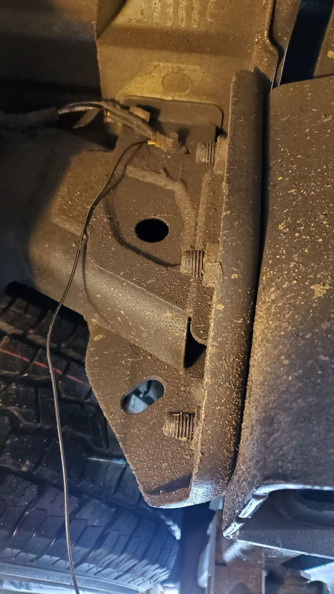

I attempted to source the reverse light feed to the tail light assembly, but the LEDs are trick to figure out with the BLIS, besides the trailer harness is right there. The VLEDS tutorial talks about using the T connector to a ground and the hot line. The ground on the trailer harness is a gauge that will not fit in the supplied connector. I found another factory ground connection point on the drivers side, of the drivers side main frame rail.
Ford F-150 Lightning Aux reverse lighting options and install 20220101_113025
I tested the lighting prior to making the connections to both the frame and the trailer harness, everything worked as it should, with no alarms that something is connected to the trailer plug, so I cleaned up all the wiring and tucked it all away. The results are below.
