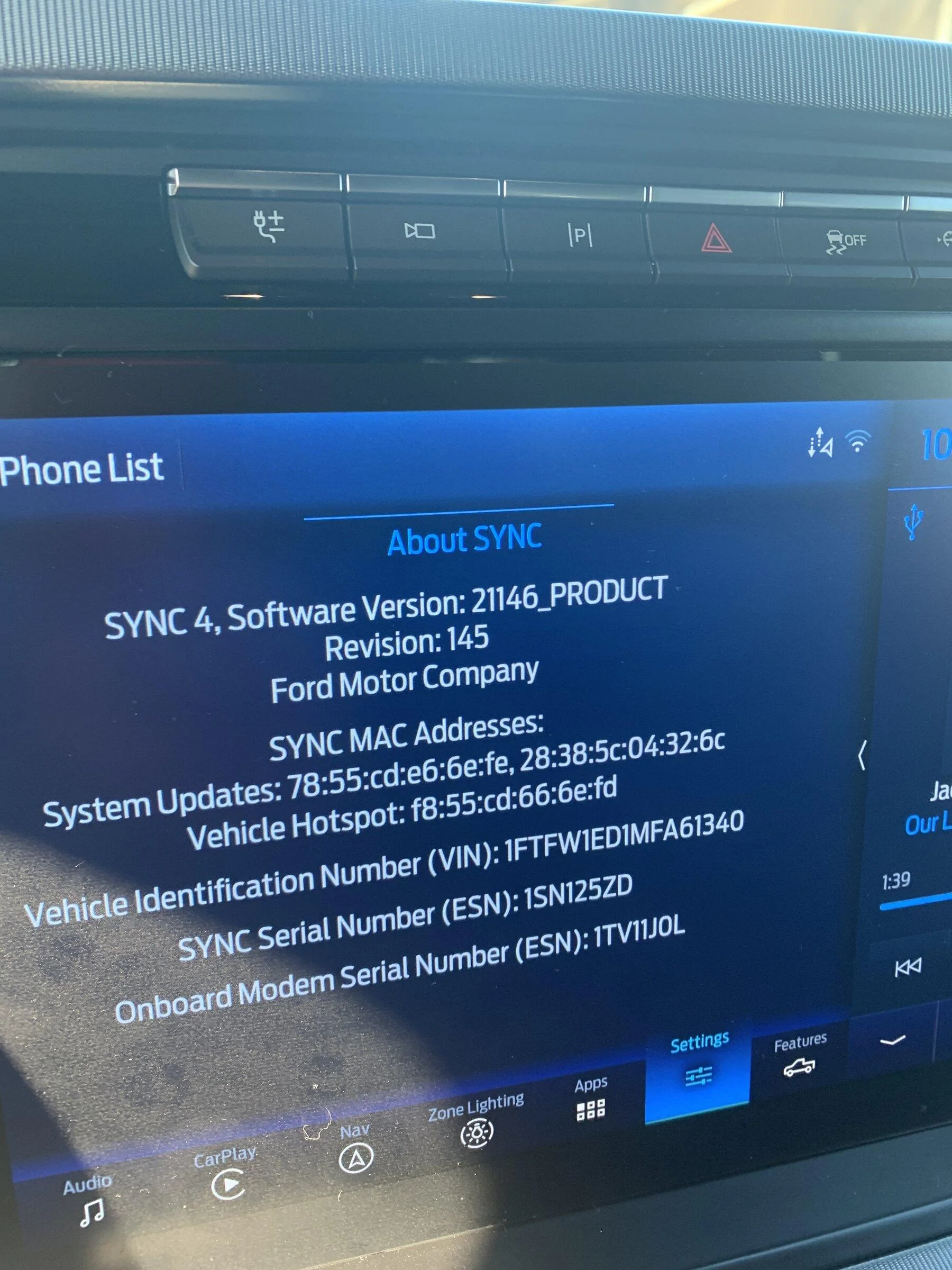

Look under settings to see what version of Sync you have. Below is what mine looks like. If this or better, the Forscan changes will enable the cameras at speed.
Ah didn’t realize that was apim version there thanks.
I’m in luck and have 21146. Forscan here I come!
