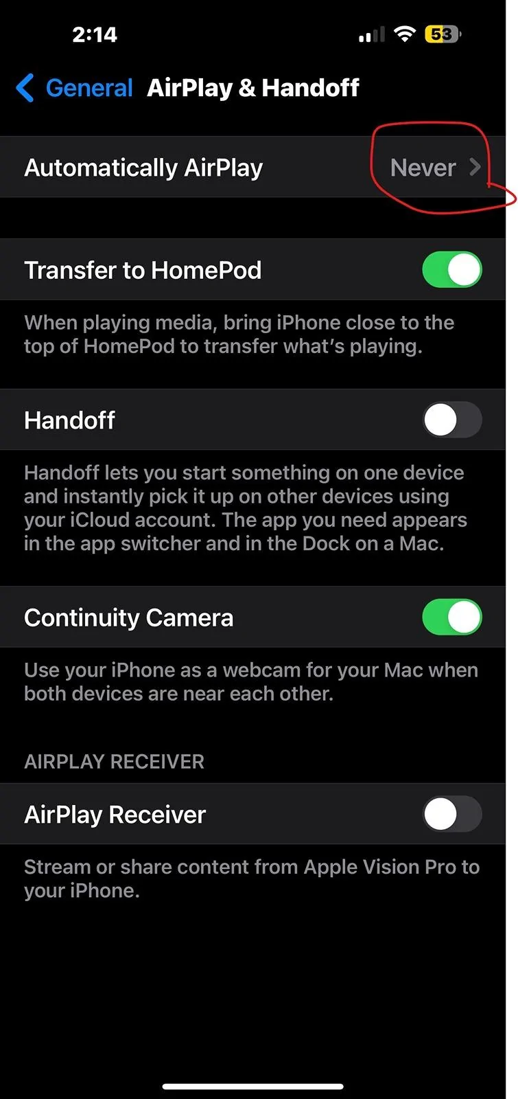

The other thing is the choice of audio output is ostensibly regulated in iOS by AirPlay. You can go into Settings, General, AirPlay & Handoff, and under the menu choice "Automatically AirPlay," pick NEVER. The phone in the truck blithely ignores that setting when CarPlay is in operation on the truck SYNC screen and still sends all audio to the truck rather than my hearing aids as if the AirPlay NEVER switch choice to switch was meaningless.
Ford F-150 Lightning Lightning Bluetooth Behavior Not Too Smart-Holds Onto Phone Connection When Driver Not In Truck IMG_0967
Ford F-150 Lightning Lightning Bluetooth Behavior Not Too Smart-Holds Onto Phone Connection When Driver Not In Truck IMG_0968_EDT.PNG
Despite the above settings, Waze still plays through the truck's audio system. ?

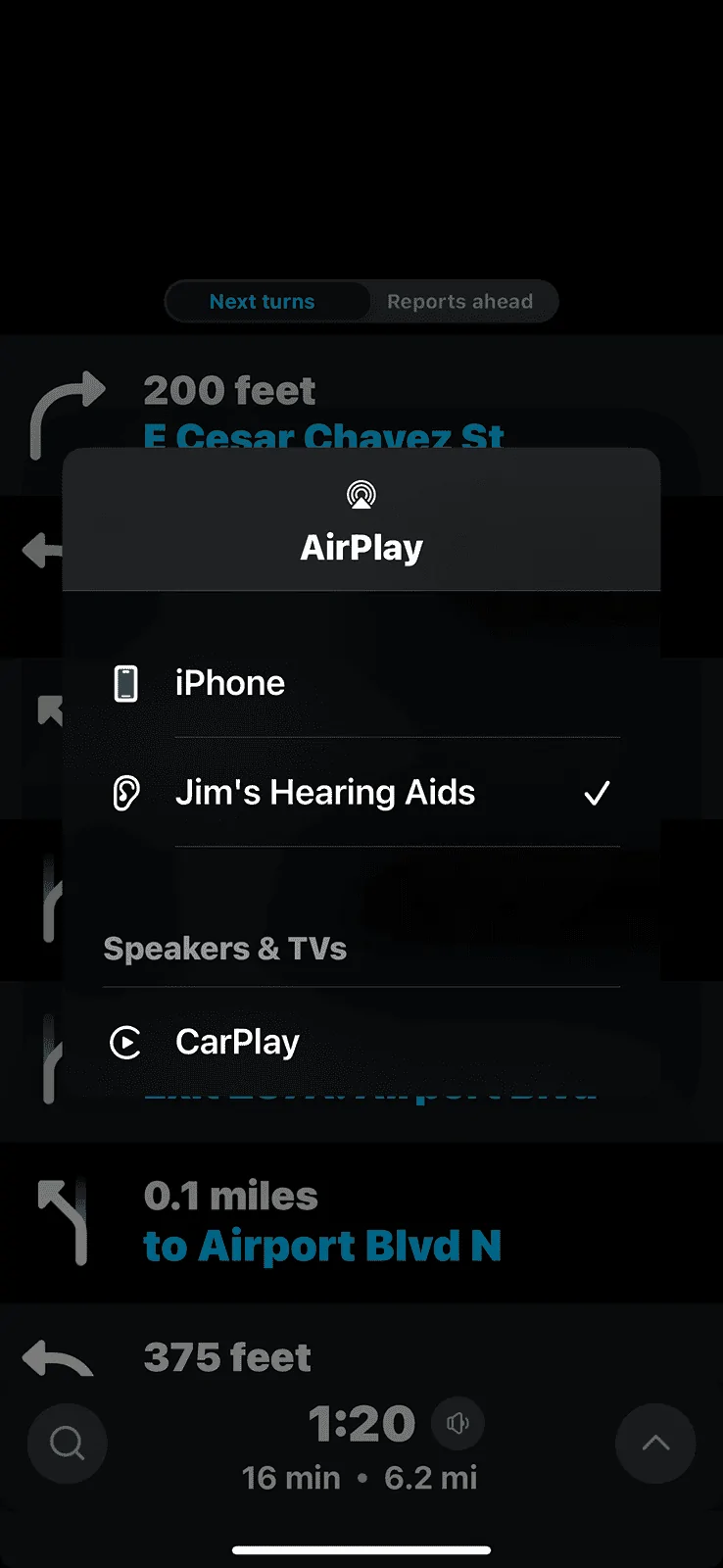

Contrary to that thought, I don't know how I did it, but last night, I actually had Waze displayed on my phone and my SYNC screen, and the audio was going to my HAs. I somehow arrived at a state where I could go to the Phone List and turn off CarPlay, but the Waze app did not disappear from the SYNC screen, and the sound was then routed to my HAs. Same for the MEDIA button in the Phone List for my iPhone. Pressing it on sent phone sound to the truck speakers, and turning it off routed phone sound to my hearing aids. I haven't been able to reproduce that state. But I think it shows with the right programming, phone audio output doesn't have to go to the same place that phone video output does. Also, if it's only audio output being routed, accessibility routing choice could and should be respected.

The night before and last night, I tried wired and wireless connections. The night before, I was operating wirelessly when I somehow managed to get Waze audio output directly to my hearing aids, but I still had the routing visuals actively playing on my SYNC screen. I had cellular data enabled on my iPhone.

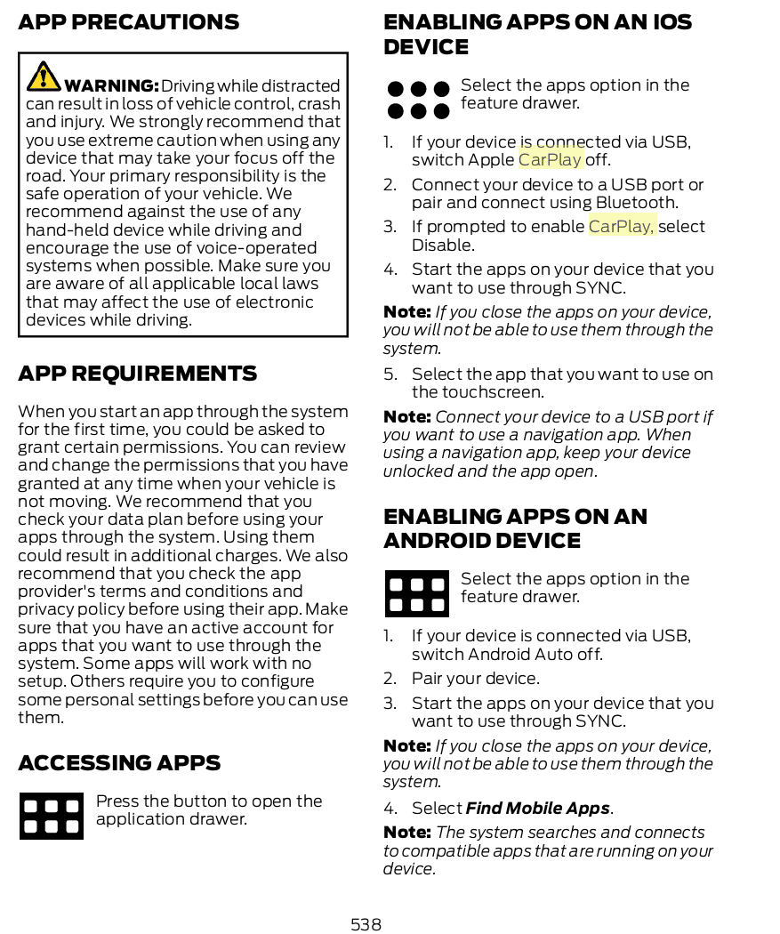

The following page in the 2023 Lightning Owner's Manual for the 15-inch SYNC screen seems to imply it's possible to directly project an app from the iPhone screen to the SYNC screen without using CarPlay (top right of the image below). Despite what the text says, I couldn't get it to happen without turning on CarPlay via the SYNC screen Phone List settings. But it occurred to me that I might have somehow stumbled upon the direct projection option the night before when I momentarily had Waze sound output doing directly to my hearing aids rather than the truck speakers.
